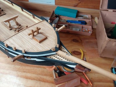

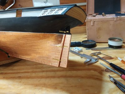

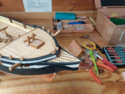

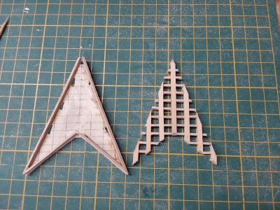

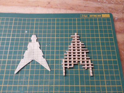

Have now installed the rudder and fitted the beakhead grating.

I have found that trying to compare my work to others’ brings only discouragement, not encouragement. I try to limit myself to comparing my work only to my work. Thus, if I’m producing something I judge better than what I managed before, then I am on the right path.
I like how you tackled that grating. Looks very nice.

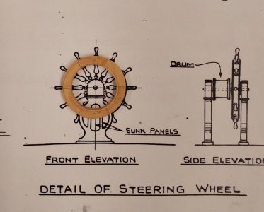

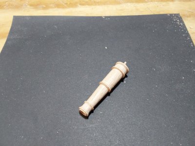

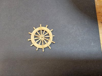

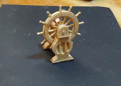

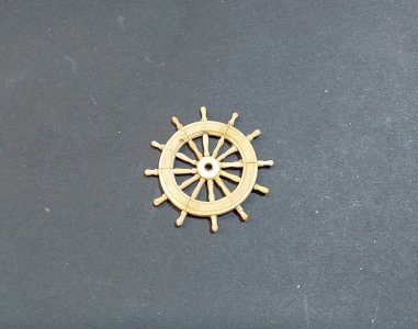

I acquired some new tools recently (a Byrnes table saw, a milling machine and a mini wood lathe) which hopefully will improve some of my work. So far I have produced the steering wheel and a some cannons. Turning the cannons in timber so that they are close to the same dimensions is a bit of a challenge.
Beautifully done ship's wheel.

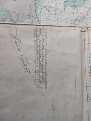

Hi Allan, Royal Navy brig of the preiod 1840, the plans are from Harold A Underhill. The brigs were, inter alia, used for supressing piracy and the slave trade and then later as training vessels. Attached is a photo of HMS Sealark from aorund 1890 when fitted out as a training ship (photo colourised by Frank Hellston). Thank you for your interest.

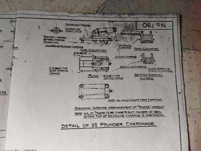

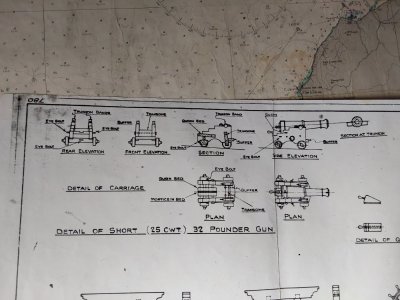

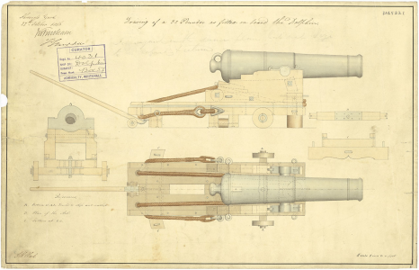

Is the cannon in your photo based on a drawing from Underhill as well? The reason I ask is that a drawing I have for Dolphin would have been appropriate for Sealark according to an annotation on the drawing and mentioned by RMG. https://www.rmg.co.uk/collections/objects/rmgc-object-85012

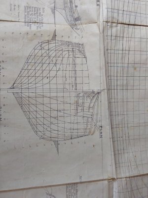

Hi Allan, Thanks for the drawings, much appreciated. While the photos of the Sealark show considerable similarity to Mr Underhill 's drawings, the lines plan is significantly different, in particular the amount of deadrise. Underhill notes that his drawings are of a typical brig-of-war of the period and not the more extreme "clipper" type, which perhaps Dolphin/ Sealark was an example of.
At this stage I intend to follow Underhill's plans for the cannons and carronades unless they prove to be demonstrably wrong.

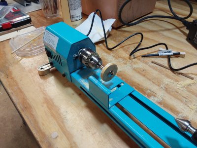

Hi Colin, Here is an image of the lathe (I bought it off Amazon, not eBay, but they are available from eBay as well). They obviously come from China (doesn't nearly everything these days?) so it took a couple of weeks for delivery). As mentioned so far I am pretty happy with it. It only comes with the one chisel, but I have been using the tips of my mini-files to good effect. I figured at the price I couldn't go too far wrong. I will see how it goes and if I need to I can alway replace it with a better quality machine down the track.
