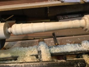

I added some detail to the reinforcing rings. On to final sanding and drilling the bore and trunnion hold. I plan to stain the cannon rather than paint it to preserve the detail in the reinforcing rings and cascabel.
Greg: Ebony is tough to work with, including turning. At the price it's at one can't afford mistakes! Stained maple will have to do,Img_0912.jpg

So I used the lathe and fine sandpaper to smooth the canon. The final polishing is done with handfuls of wood shavings pressed against the turning barrel to use "wood to polish wood". The technique works really well. I then had to decide how to blacken my maple cannon. Three choices: Paint, stain or dye. In the end, I chose Solar-Lux Jet Black wood dye made by Behlen. It's alcohol based, dries quickly, penetrates into the wood fibers, doesn't raise the grain and won't obscure the detail on the reinforcing rings and the cascabel. It turned out well.
Obviously I'll need to protect the dyed cannon. When we blacken brass cannons chemically, the resulting gun has a bit of a sheen to it. The cannons were cast, so would have been flat black in color. The "sheen" doesn't look bad in my opinion, though. So what do you think? Flat/matte poly, or semi-gloss/satin poly for a little sheen?
I think the finish is too matt - a little bit gloss would look much better in my opinion
