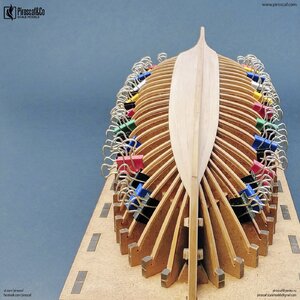

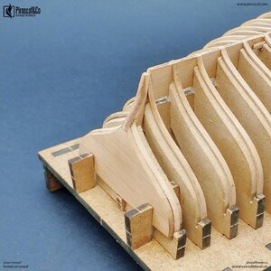

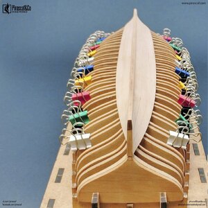

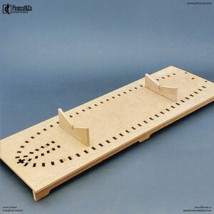

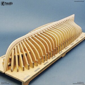

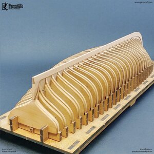

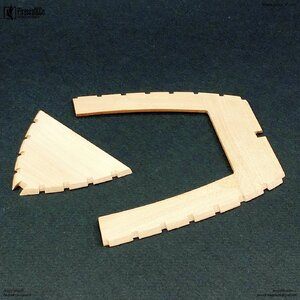

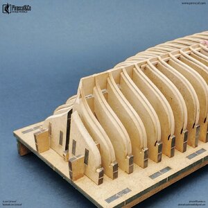

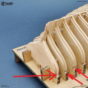

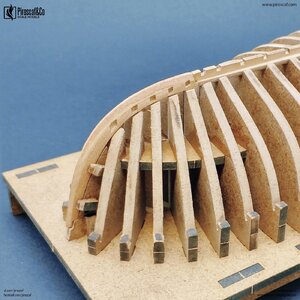

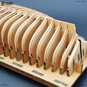

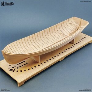

These slots allow you not to glue but simply insert the frame.

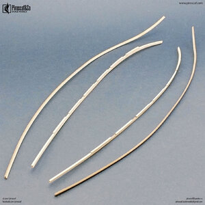

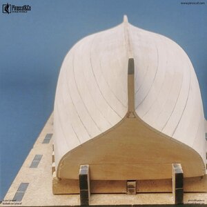

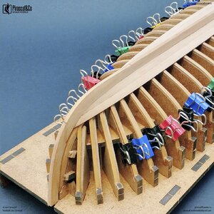

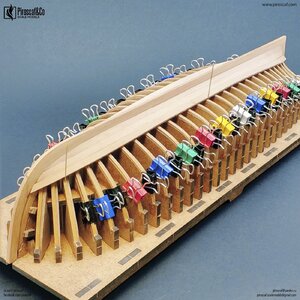

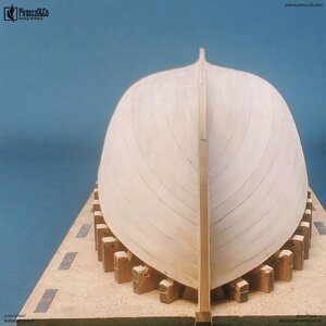

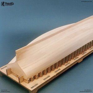

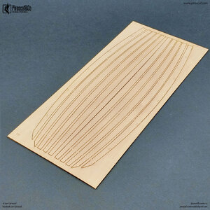

Agreed that they are hopefully preformed/pre shaped and that the instructions indicate the correct orientation and sequence of placement for each plank. Also, I suspect care will need to be exercised not to allow the glue that is used to glue the planks to the frames to "spill over" and come in contact with the underlying forms.ARE THE PLANKS PRE FORMED. GOD BLESS STAY SAFE YOU AND YOURS DON

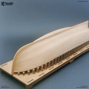

Yes, you are right. All the necessary appearances will be present in the instructions. The pre formed planks are needed so that the shape of the longboat is preserved after being removed from the slipway.Agreed that they are hopefully preformed/pre shaped and that the instructions indicate the correct orientation and sequence of placement for each plank. Also, I suspect care will need to be exercised not to allow the glue that is used to glue the planks to the frames to "spill over" and come in contact with the underlying forms.

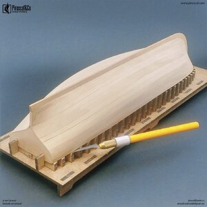

Thank you for the advice.You can wax the forms with candle or bees wax to keep accidental glue drops from sticking. of use clear saran wrap or equal for same purpose, both very thin and don't effect shape.
