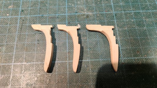

I find your knees a bit short. In my opinion they mostly reached up to the bilge stringers. But perhaps I am mistaken.
As always beautiful work Maarten.
Not completely true. If a knee is wanted at a location where there is no wood to fix it to (through the ceiling) than a piece of wood is inserted (in Dutch called a 'kalf'). At such moments it is very helpful that there is no outer planking (huiddigt) yet.
I find your knees a bit short. In my opinion ion they mostly reached up to the bilge stringers. But perhaps I am mistaken.
Hi Ab,
Thx for the comment about the kalf, again learned something.
Regarding the knees I rechecked the wrecks of Anna Maria and Samuel and have to agree with you. I used the drawing of Samuel where the knee was covering the two balkwegers and ended at the ceiling plank below that.
Allthough when measuring and recalculating scale the knee is 1,5 mtr high where mine were 1.1 mtr.
In Samuel it is a verdek knee as there is no overloop. If I put the 1,5 mtr knee height in the overloop of the fluyt it is reaching towards the bilge stringer.
I have directly started to modify, still work in progress.

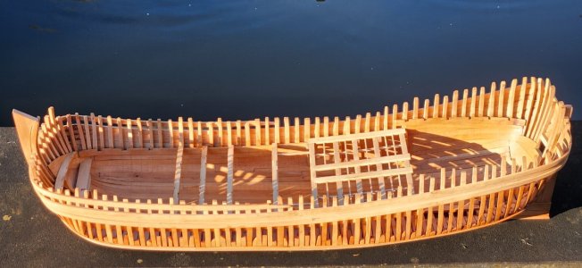

Slow progress on the deck but getting there.

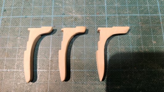

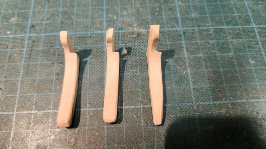

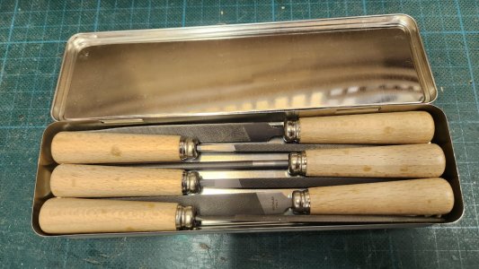

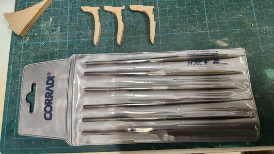

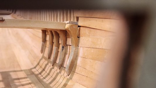

Knee production for which I also invested in some nice new files.
These work much better as my old standard files.

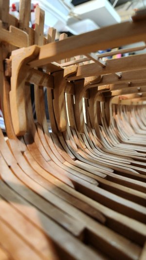

Knees installed, this side of the hull remains open.

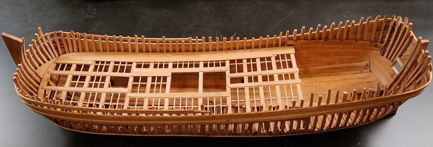

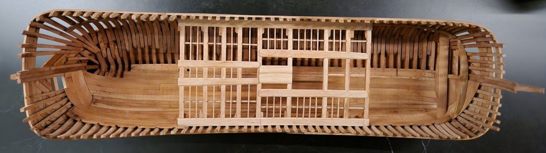

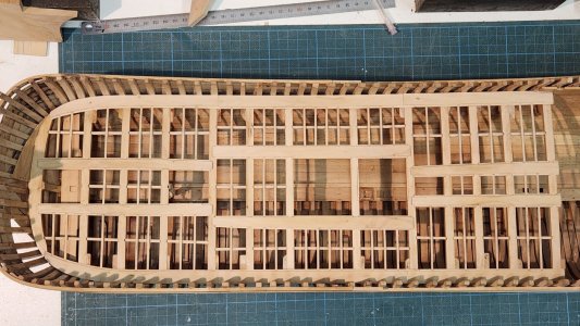

The first deck section finished.

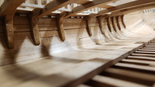

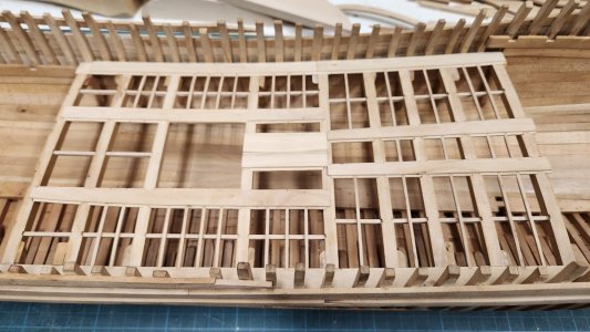

Work on the second deck section beams and knees in place. The knees are partly bolted and treenailed through the hull as noticed in the Samuel wreck.

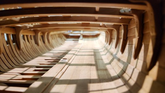

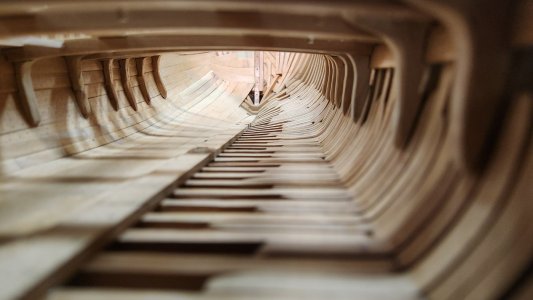

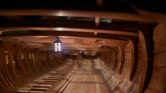

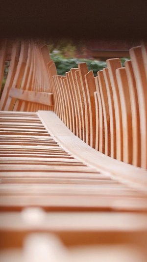

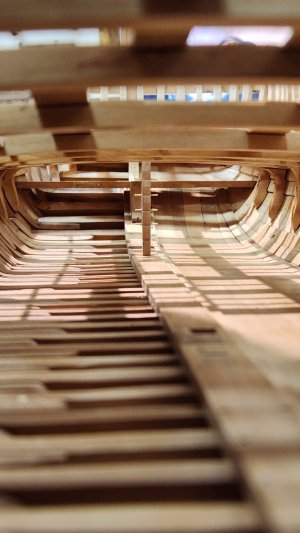

Looking foward through the hold.
And looking backwards.
The second deck section nearly finished.

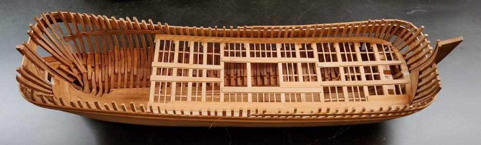

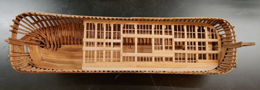

A nice amount of installed knees, Maarten. And impressive inside pictures.

Beautyfull! Looks like beeing in a real vessel.

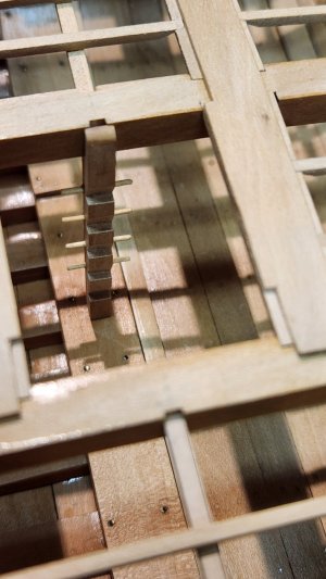

Question: how do you drill the holes and place the bolts underneath the beams?
Hi Rob,

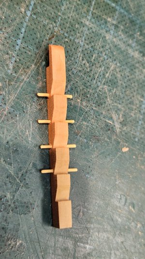

The bolts through the knees and hull are drilled from outside the hull inward.
Then I fit the bolt from outside and clinch it on a small anvil I put inside the hull.
The bolts through knees and beams are drilled from the free end of the deck beams.

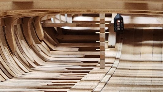

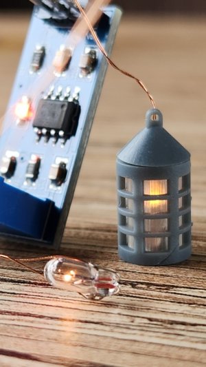

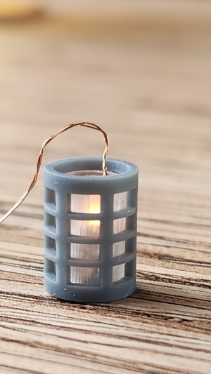

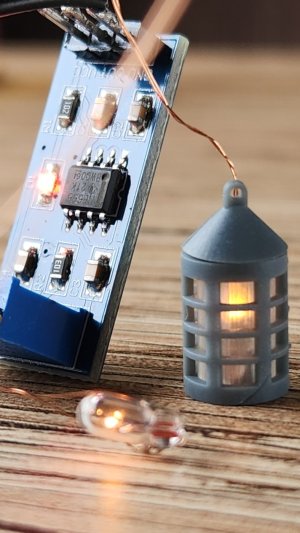

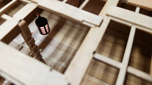

As the orlop deck is nearing its completion I am testing with the lighting of the hold.
As LEDs are mosltly to white or to orange I am now using very small glow bulbs in combination with a NE555 pulse generator to imitate the flickering of a candle.

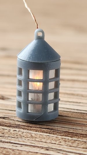

The lanterns are 3d printed by Chris @SZKUTNIK
After the test painting and finishing will follow.
The lanterns are painted and assembled. Mounted on a hook in the deck beam next to the fwd hatch and the aft hatch.
The wiring I have fitted into the deckbeam before fitting the planking.

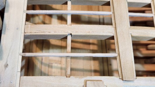

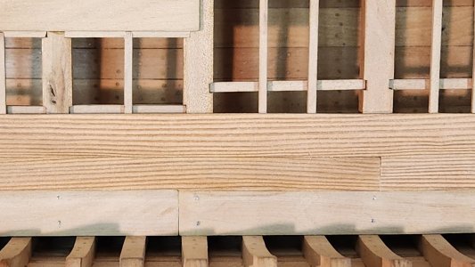

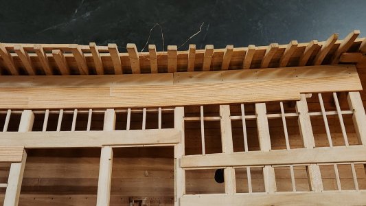

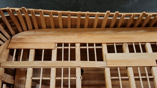

After a small side step to the ladder and lanterns in the fwd hold I go back to the deck construction. The waterways and schaarstokken are bolted to the deckbeams.
I have taken this from Vasa where an identical construction can be seen in the reconstructed deck mock-up in the museum.
Van Yk also mentions this that the waterways are bolted on the ships side with long bolts. I questioned if this were horizontal bolts fully through the waterways and the ships framing or through the deckbeams only.
In the model I fitted the bolts through the deck beams as in Vasa. The bolts on the schaarstokken will follow after sanding the deck.

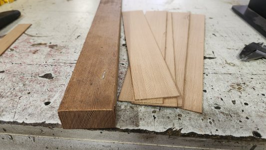

The deck planks in a Dutch merchant vessel are in general not from oak but from pine.
All the oak parts in the ship I do with pear for the pine decks I use a Larch with a very fine grain.
The pine (larch) gives a nice contrast to the oak (pear) in the deck construction.
All deck planks are again different in width as can be seen in real 17th century ships and the rest of the hull.
