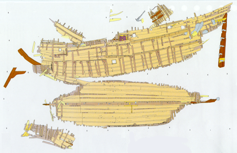

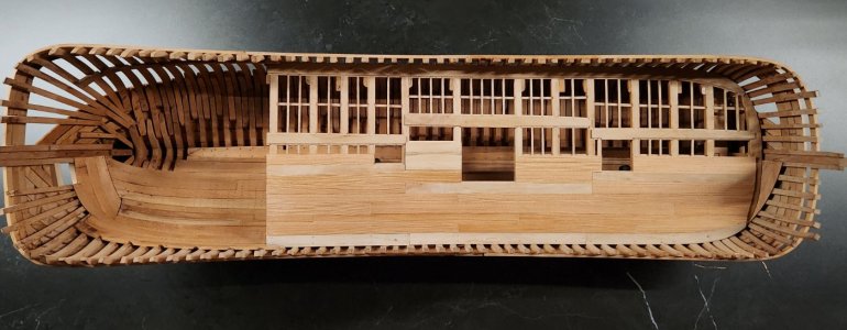

Thanks Ab for the added info. I will add the horizontal bolts to the PS waterways as they will only be visible in the none planked deck. On the SB side I will add them on the outside of the hull only. I haven't seen any of these bolts in the accesible wreck data as these are mostly invisible or these parts are in most cases not remaining, do you know if these are visible on the Scheurrak SO1 wreck as here the whole ship side was conserved?Waterways were indeed bolted horizontally through both the ships sides and the waterways.
The English word for 'schaarstokken' is 'binding strakes', although their appearance is different. In the English method they only run from beam to beam, in the Dutch method they are part of the longitudinal strength of the construction.

No, I don't know, but these bolts were driven in before the huiddigt was applied. They remain underneath the planking.do you know if these are visible on the Scheurrak SO1 wreck as here the whole ship side was conserved?

Hi Ab,No, I don't know, but these bolts were driven in before the huiddigt was applied. They remain underneath the planking.

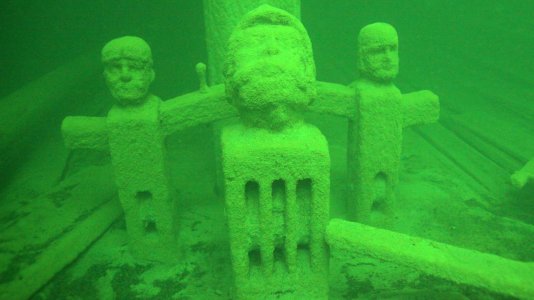

Have a good time during your holiday, Maarten.As we are heading towards Sicilia with our motorhome it is time again for a new "MHCP", motorhome holiday carving project.

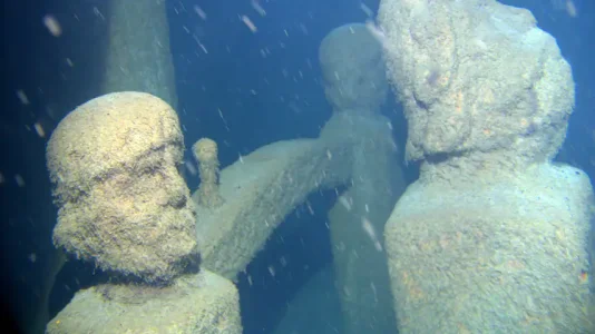

This time it will be the knightsheads. There are 4 on the ship. 3 behind the main mast and 1 behind the fore mast just before the main winch.
I do have ROV pictures and video of these.
The main mast.

The fore mast which is severely damaged.
For a 100 ft ship Van Yk mentions the following about these.
The main mast knight is square 14 thumb "inches"
The fore mast knight is square 12 thumb.
The main top sail knights are 7 to 8 thumb.
The example ship of Witsen is showing larger knights but this is a bigger ship than my 95 ft big Fluyt.

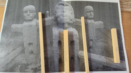

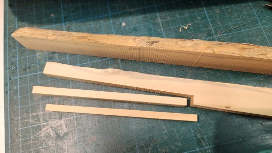

Of the mentioned sizes above I made some lengths of boxwood for each individual knights head.
I start with the top sail knight.

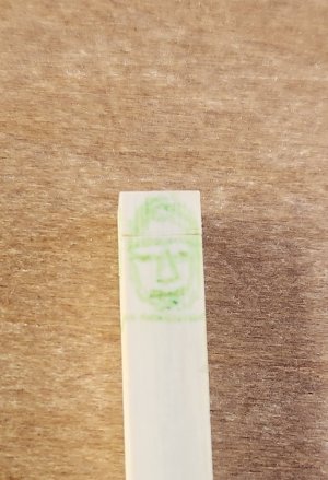

He is wearing a wollen hat of which you see an 17th century original below. This one was found in the ice on Spitsbergen where a lot of Dutch whalers are burried in the permafrost.

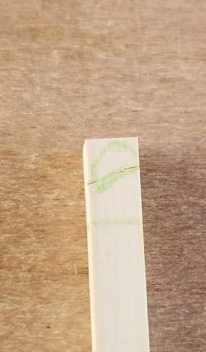

By lack of a decent pencil I made just a very rough sketch.
Let the fun begin.
