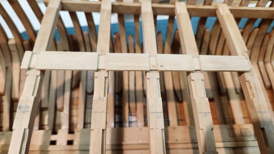

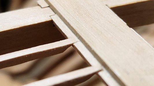

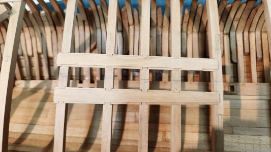

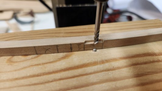

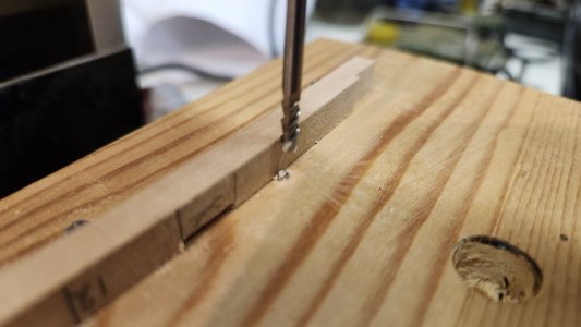

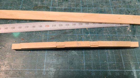

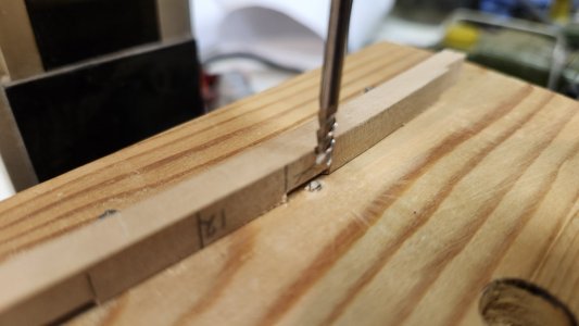

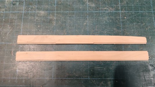

Milling the schaarstokken. I have choosen to only partly cut into the beams to keep there strength, this means also a part at the back of the schaarstok is removed.
For the milling I use a guidence pin to set it at a fixed milling depth.
To mill the opposit side the mill has to be adjusted to be flush with the guidance pin.
Now the pin follows the contour of the other slot and copies it.
The rounded ends I finish with a chisel to square ends.
All waterways and schaarstokken are now finished.

Thx Peter,‘Schaarstokken’ with nice slots are always a pleasure to see, Maarten. All parts are nicely leveled!
Thx Paul, this works very quick, first all the beams on one side. Adjust the mill and then do all the opposit sides.Very clever solution to create matching slots!
That is exactly how it works, especially the force in my caseDear Maarten,

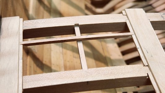

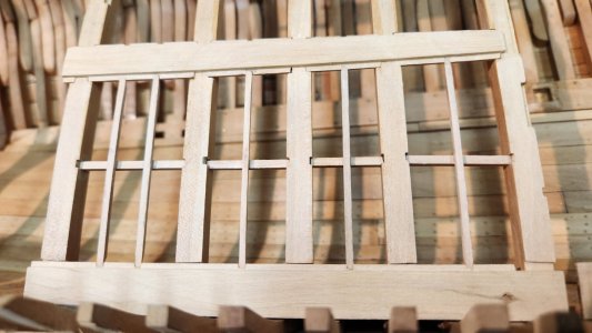

Mooie verbindingen naar gelijkenis van het voorbeeld, Maarten.The work on the deck continues with the carlings or in Dutch the grieten and kalmajen.

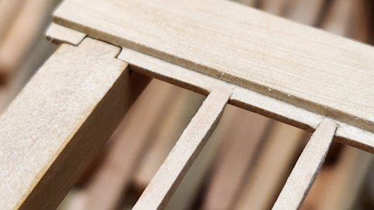

This is what Van Yk mentions about them.
"The ribs which are fitted between the beams, to improve the rigidity of the orlop, with 3 or 4 ribs depending on the space between the beams are called grieten. At the ends they are fitted into the slots. For their support two ribs are fitted in the ships length, called kalmajen. The thickness of the grieten is equal to the outer hull planking, the kalmajen equal or slightly thicker. Their shape is mostly square."

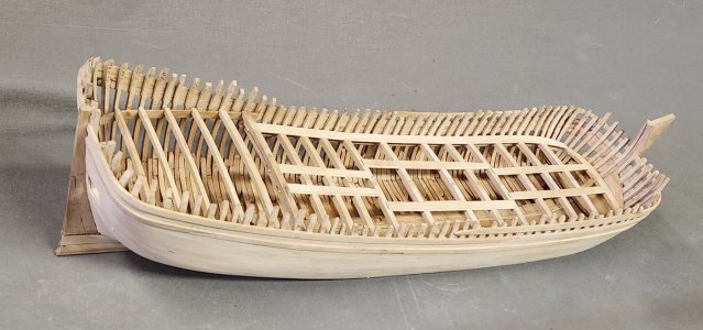

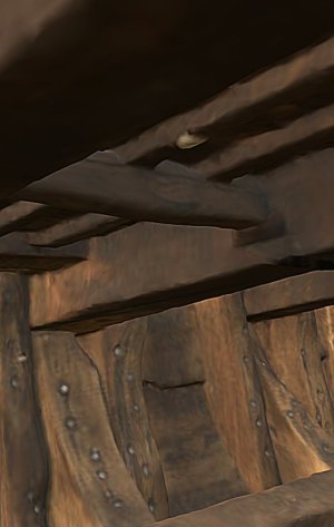

In my model I use less grieten and kalmajen as mentioned by Van Yk for the orlop. Reason for this is as I have seen it on the orlop of Vasa. On the majority of the orlop deck there is only one carling between the beams.

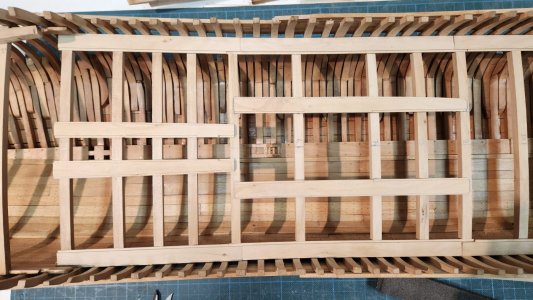

This is how it looks on Vasa.

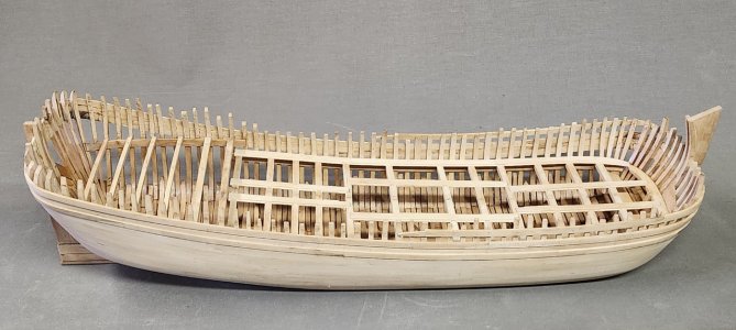

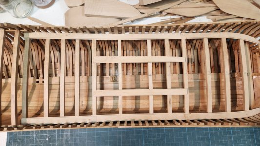

And on my model
And from beneath.

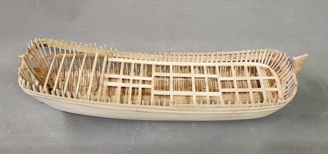

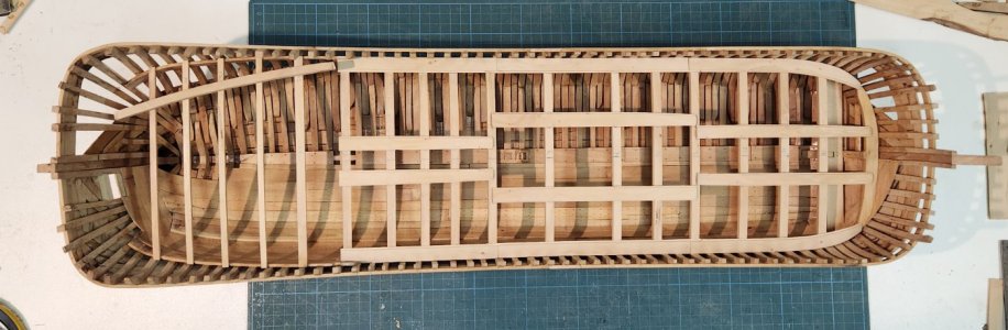

An overview of the current status.

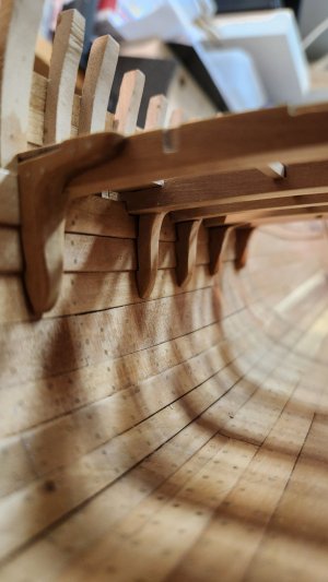

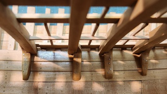

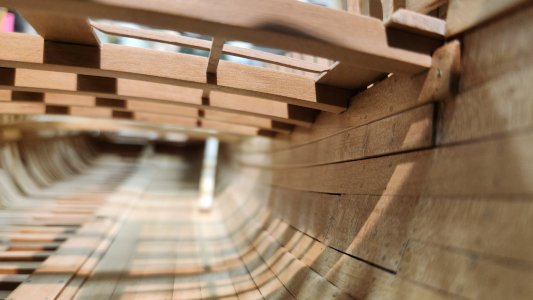

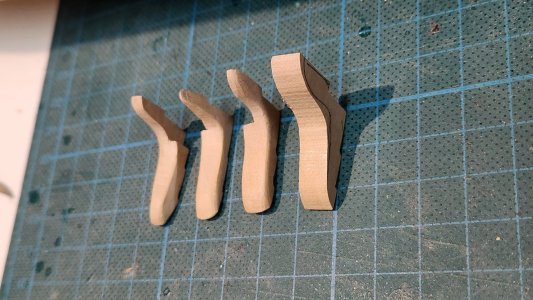

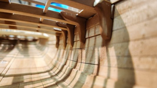

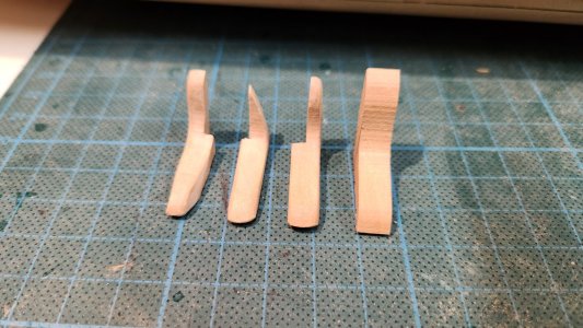

I'm loving the random precision, Maarten!Here I started on the knees of the orlop deck beams.

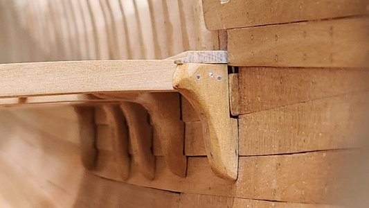

Again I make every knee different in shape. The knee is fitted to the ceiling planks only where there is a frame member to fit it, this determines if the knee is fitted fwd or aft of the deckbeam.
The fitting of the knees is a combination of bolts and treenails.

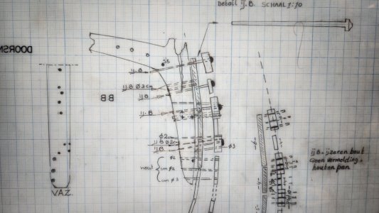

See below as example a knee fitted in the Samuel E81. Also Vasa is showing bolts fitted thrue the knees of the orlop deck below the waterline.
The knees are fitted in place and bolted to the beams.

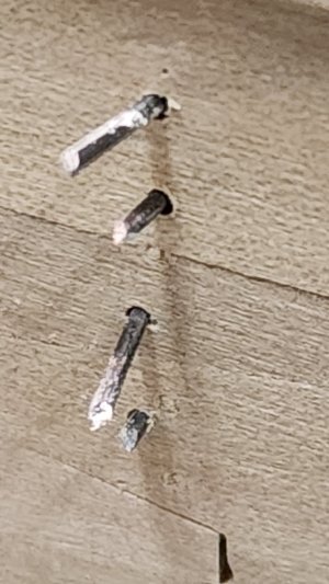

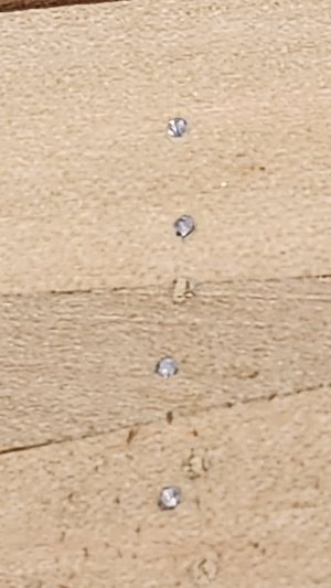

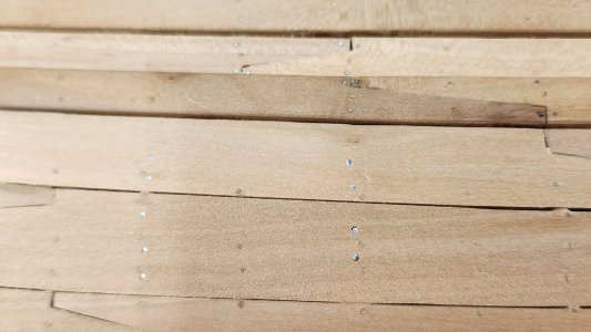

The bolts are rolled with a knive from 0,7 mm steel wire
The bolts fitted thrue the hull before cutting and riveting.
And after riveting.
And on the inside.
