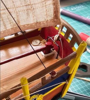

You are absolutely right :-) Indeed I have already experienced this in a small way. When I was attaching the driver to the Endeavour, I realised that if I did what it said in the kit, then the sail would look ridiculous because it was only attached to the gaff. It was too late to attach to the mizzen mast (too many lines in the way now!) so I added an eyebolt immediately behind the mizzen and ran a line from the clew to the eye bolt. That at least made the sail look plausible! It still needed a sheet, of course, or it would just blow in the wind and be useless. I discovered that the real Endeavour had an iron-horse so I made one of those and attached the sheet line there. there was really no room - it is not a great model! But it looks OK to non-experts. It also has my first coil of rope!
