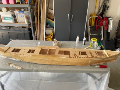

Good afternoon Vic. Your ships are like the Texan weather….extreme……from a tiny Uss Constitution to this massive creation.She’s starting to take shape. View attachment 536089
. True story ..she is taking shape. Cheers Grant![]() |

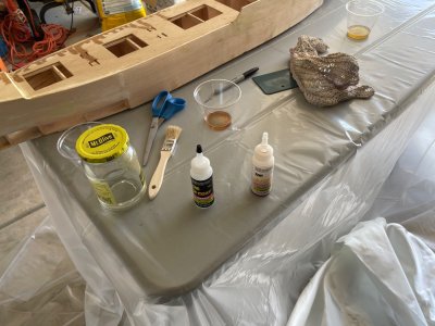

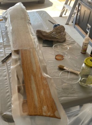

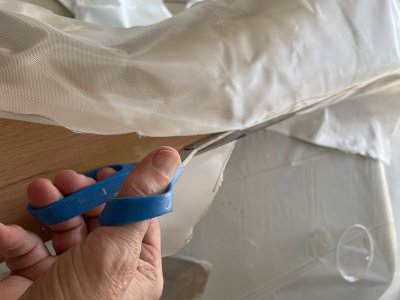

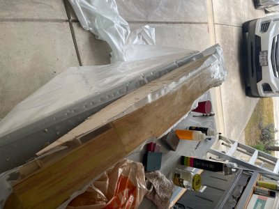

I thought I was going to have to go to the back yard. But then I found some plastic drop cloth so I wouldn’t get the epoxy all over her garage floor. She did let me pull her car out for two days while it dries.Looks good, Vic! I see the Admiral sent this job to the garage...
I tried sanding them down as far as I could before I sanded through a couple of them. I also used a lot of putty. It’s not perfect, but I’m hoping the paint will help. I’ll prime it and paint it. My only concern right now is the seams at the bow and stern. I’m hoping sanding will help there. I’m also considering another layer of epoxy after sanding the hull. Thanks for the encouragement and tips, Jim.Great job, that's exactly what a good fibreglass job should look like. From my experience there is no better way to cover a ship model which intended to represent a steel hull. Should you ever decide to build another hull of this type consider sheeting the frames/ bulkheads with 1/32 bass plywood, and then fibreglass. This method saves a lot of time planking with narrow strips which should not be seen at the end result.
