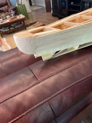

That does sound counterintuitive.For those interested in the Naval Architecture of these vessels, she has a “cruiser stern. Although counterintuitive, at higher speeds, ships with longer waterlines are more easily driven than those with shorter ones. This has to do with the wavelength of the waves generated by movement of the vessel’s hull. As speed increases, the amplitude of these waves increases and wavelength increases until there is one large wave at the bow and one at the stern. When this happens a huge power increase is required to move her any faster.
The cruiser stern increases this waterline length. As a side benefit it also better protects the rudder than the old fantail stern.

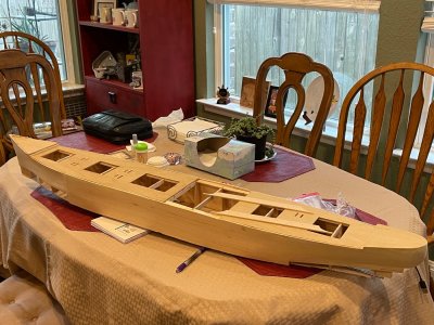

I've gotta ask: does your sponsor understand how big this ship model is?She’s starting to take shape. View attachment 536089
Paul, he understands ho scale. I show him pictures occasionally and he gives me thumbs up. He is combining two bedrooms to make his train set. This diorama will fill one wall of one room.I've gotta ask: does your sponsor understand how big this ship model is?
