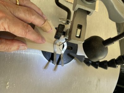

I have to post it on my phone. Then I have to go back to my computer to make the images rotate to where they're supposed to be. They look better now that they're not upside down, Paul. You and Kurt really responded fast! Are you on vacation or something?

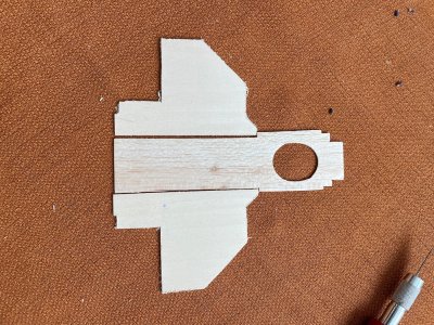

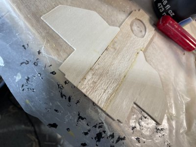

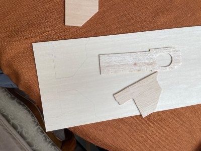

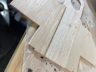

The thickness of the wood is not consistent. I wonder if I shouldn’t use this as a template and cut out a single piece from bass wood that I bought from the store; otherwise, I’ll have a couple of ridges that are quite visible image.jpg
