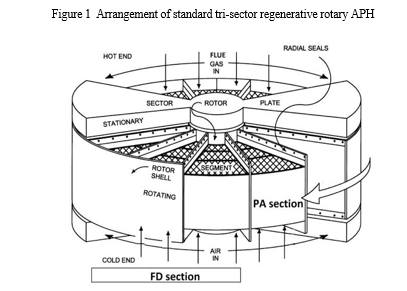

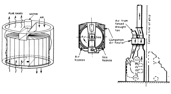

The S.S Exxon Benicia had a regenerative heater exchanger. It transferred heat from boiler exhaust gas to incoming boiler combustion air. It did this using a cylindrical rotor formed from hundred of plates arranged in a radial direction. The rotor hot boiler gasses heating the plates on one half of the rotor, and a motor rotated the rotor such that the heated plated moved from the passage containing the uptake and boiler gases to the intake passage through which the combustion air flowed through. The combustion air picked up the heat from the plates. We had to clean the soot off plates every few months when the boiler was shut down by entering the combustion air passage through a hatch and using a water hose to wash them off. The water was diverted to drains so it didn't enter the boiler airbox below. Clever economizer unit!

View attachment 555825 View attachment 555826

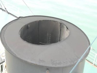

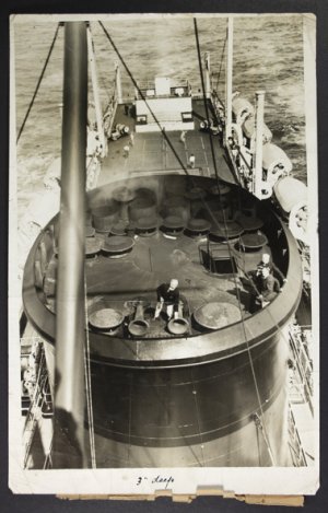

And what would that look like on the top? Would there be dampers or hinged plates where the gasses would escape, or would there just be a large hole the size of the inner funnel?

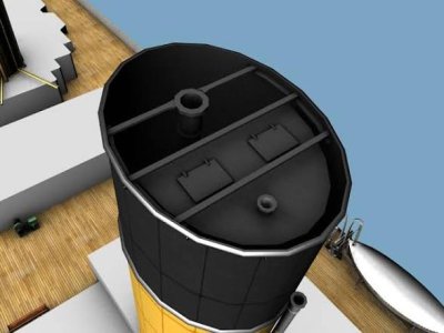

Is this what it might look like from the top?

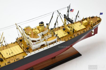

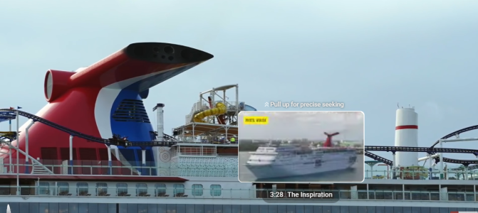

@Vfordyce 's image is closest to what the top of the funnel would look like on a C-2. Designs vary. Intake air would enter louvered vents, typically on the rear or side of the funnel, away from the exhaust openings at the top so that exhaust gases would not re-enter the boiler intake. These vents also allow air to reach the intakes of the engine room air supply fans, which blow cool air into the engine room so Engineer's like me don't pass out from the heat. Without intake and exhaust fans, the engine room would go from 108-120 deg F up to steamy 130-140 deg F in a matter of minutes. Ask me how I know... :D On the C-2 model below, the exhaust flue protrudes a bit, but that also indicates the diameter of the flue on a C-2. The hole for the exhaust flue is not shown on this model. Mixing fresh water with exhaust gases which contain sulfur creates a weak surfuric acid would would eat the uptake (exhaust) tube in a short amount of time. So, expelling the gases without them contacting water and having that contact carbon steel is a must. When the boilers are not fired in port, a flue cap was placed over the exhaust flue outlet to prevent ingress of rain. Perhaps this cover is shown on the model below, closing off the flue.
Modern cruise ship funnels take air into louvered vents on the side, and exhaust gases exit out the end of one of the wings on top, preventing mixing.
However, this design can, like with circular exhaust tubes, still collect soot deposits and have hot spots which, when combined, cause funnel fires.

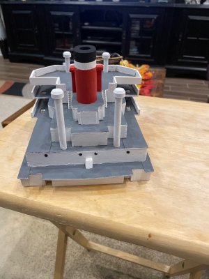

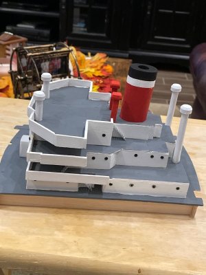

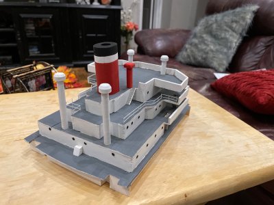

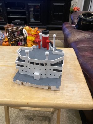

The superstructure is almost done. It's pretty rough. I'd like to blame it on the wood and the condition of the kit, but it was all me.
View attachment 558843View attachment 558844View attachment 558845
Prepping wood in order to get a smooth finish takes a lot of work. Open grain wood always leaves a rough finish when painted unless primed very well. It's hard to make wood look like steel without filling all the pores. Sanding to a fine grit can only get you so far. You did the best with what you had. Your next one will use different techniques and come out better. This looks just fine, however. Is this model intended for RC?
Yes, it is. That’s why it’s balsa. The top deck I used bass because the pieces were different thicknesses. If I had it to do over…I’d probably use my own wood for most of it. It would have been a lot more expensive and would have taken a lot longer. Thanks for looking in, Kurt.
I'm interetsed in seeing this ship sail. What you put in the hull to control the ship would be a learning experience for me.
Unfortunately, we'll never get to see that. The owner wanted it to be a waterline model. They do have all the directions for the motor and the steering. Those would be bought separately. I'm sure that there are newer and better options for engines and steering today. If you'd like, I'll send you the information on motor or steering. Let me know.
