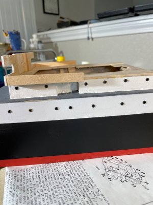

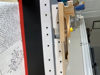

Can you find any numbers stamped on your balsa pieces? Mine were obliterated over time. And I did not put on the bottom pieces of large balsa below the waterline, but I still had to cut off a couple of inches off the bottom to reach the waterline.
I'm not complaining--just amazed.
The numbers on the pieces in my kit look like they're as legible as the day they were made. It's hard enough to find the pieces among the many pieces in the box with legible markings, it must be very frustrating to try to find pieces without markings.
The ribs/bulkheads extend about 1 3/8" below the waterline and then as you know get glued to the base pieces of balsa. My plan is to cut the bottom 1 3/8 off the ribs before gluing them in place which will result in a waterline hull without having to cut it after assembly. Then I'll add a piece of 1/4" plywood to the bottom to stiffen the hull.
The bulkheads won’t fit the balsa base. Many of them curve inward. If you cut them off before they reach the bottom, they will be wider than the base and the pegs going into the slots on the base won’t be there to fit into the base. That’s why I opted to build to the false deck/base and then cut off the bottom. Also, I used 1/8“ hardboard for a new base and I left about 1/4“ more of hull. That gave enough space for the „water.“
Thanks, I know the bulkheads will be wider and will need modification to fit into the slots, I've already planned for that. When I cut them shorter at the bottom I'll cut them to shape to create new "pegs" to go into the slots. And when I add the plywood base I'll make the plywood the correct shape where the bulkheads are wider. When being the build I will start a thread on it and I will post photos of the process of lowering the bulkheads.
