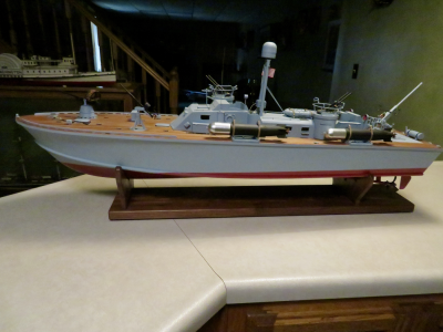

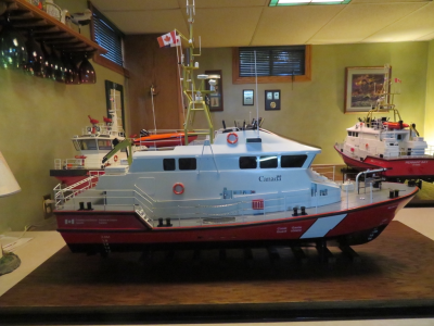

All of my ship hulls over the past 20-25 years have been built the same way. Whether for office display models for customers or RC for myself. The hulls have been framed up, planked or sheeted with what ever type of wood ( pine, birch, balsa,) I choose. They were then covered with a thin layer of epoxy and very light fibreglass cloth. After everything was dry and trimmed I applied two to three coats of epoxy finishing resin with light sanding in between coats and then painted. This method has served me well for a perfect hull every time , but the big secret is to never think you are going to cover construction flaws with final coatings of anything. These are some of my finished hulls;
