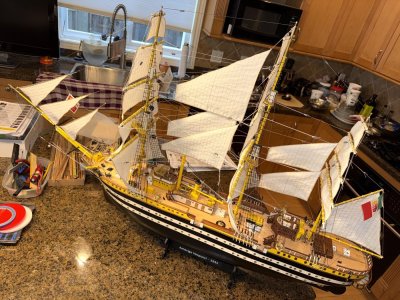

I conducted the first sea trial today on sails (in the pool). There were four goals today. Verify ballast adjustments, perform self-righting tilt test, confirm rudder authority, and see how she performs on sail power.
Winds were very mild today with gusts to 10 knots.
Findings:
1- The ship requires an additional 500g in the stern to bring the hull on it's lines.
2- With the hull heeled to the rails, the ship self-rights with authority. I'm confident NO external ballast will be required. (See short vid).
3- Rudder authority appears to be adequate. When conditions required it, a short 'blip' on the throttle turns the hull smartly. I do not think I will need a rudder extension
4- Sea trial on sails. Full disclosure.... the pool is not the ideal setting for this test as it does not offer sufficient open-air. Still, I now have the confidence to continue tests in the Ocean. I still have to learn how to handle a square-rigger, especially coordinating the fore and main sails... however the prop is always there to get me out of trouble.
With this behind me, I'll complete the build and fine tune the automation.
Would it be fair to say this is the only Radio Controlled Amerigo Vespucci currently sailing the seas??? :cool:

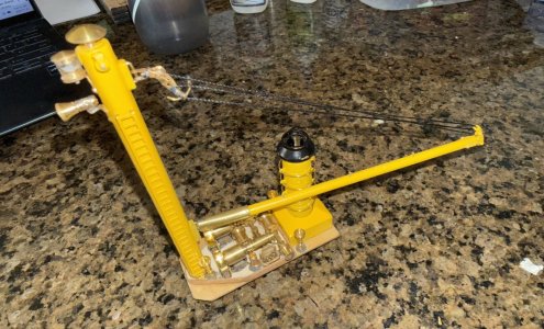

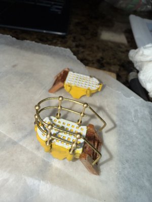

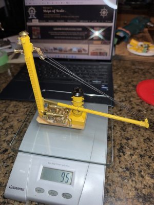

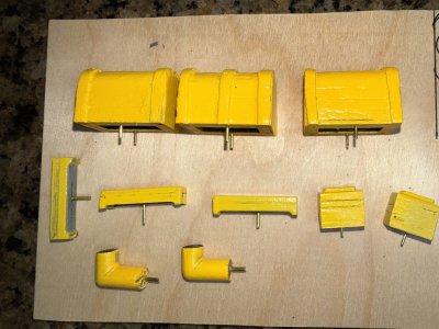

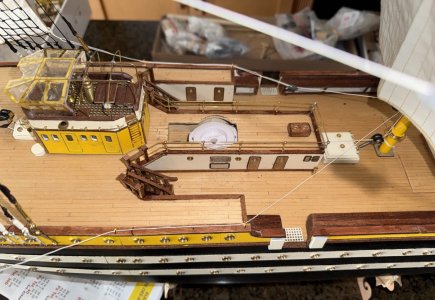

With the last sea trial behind me, I'm again focusing on the preparation all the scale deck accessories. Given the ship will see a 'challenging' environment, I'm pinning all these little bits to ensure they don't get swept out to sea.
I'm also given consideration to opening the bulkhead at aft section of the motor room to allow me to slide the batteries further aft for better weight distribution. No easy task given access limitations.
Stay tuned....

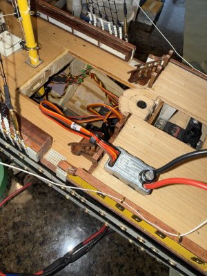

I've been making a few adjustments to the engine room of late.... First, I replaced my cheap motor Electronic Speed Controller (ESC) with a more robust unit. My cheapo controller would lose reverse mode on occasion? No idea why... so I elected to upgrade to a proper Mtronic unit.
In addition, I installed a separate Battery Eliminator Circuit (BEC) that allows me to power the sail winches and rudder directly from the main batteries. It's a 10 Amp unit which should provide adequate power under all operating conditions.

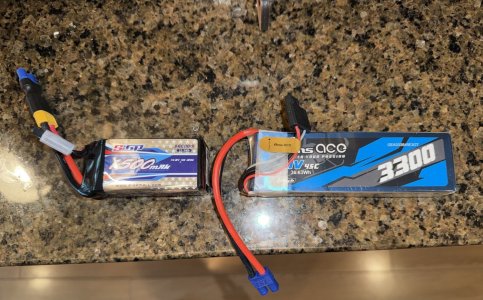

Finally, I replaced the Qty:2 3300mAh, 12V batteries with Qty:2 1500mAh 16V batteries. The net effect is a reduction in 200grams of weight, and a reduction in energy capacity from 79Wh to 48Wh... still plenty for hours of sailing.

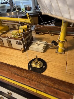

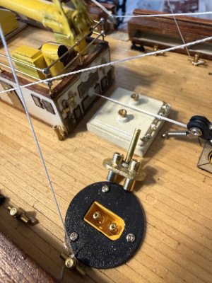

If you're looking for a simple way to isolate your system power supply, I've found a modified bulkhead connector makes for a convenient foundation for a pull-link.
The 'link' can be housed in pretty much any deck component, or in this case, disguised as a random vent.
The pull-link allows you to start-up the ship at the pond without risking any water ingress.

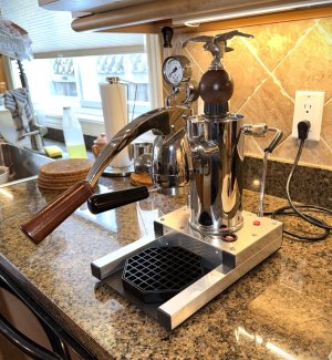

You're absolutely correct! I too find it therapeutic to focus on other projects for a while... then eventually return to the ship build.

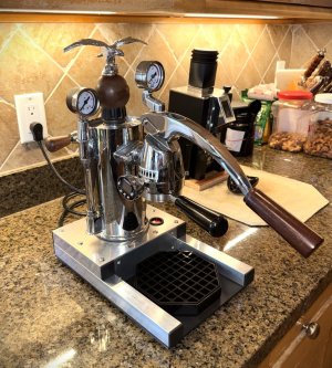

This time I fabricated the coffee-machine I always wanted. Using old parts from old coffee machines, and building a custom mounting frame. I now have a hybrid espresso machine that should hold me over until I come up with some other hairbrained idea.
With hope, this ship build will be completed before that happens :)

JJ, I love the expresso machine. Very Cool! Magic Mike
