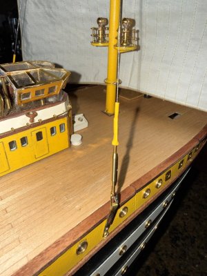

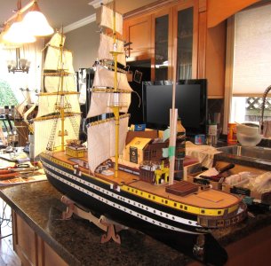

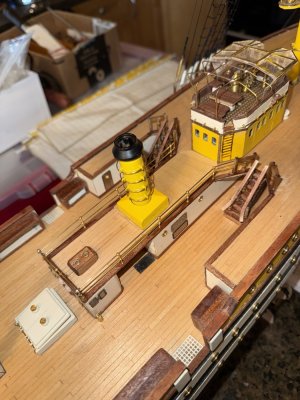

Sorry about the delayed progress report. I've been focused on preparing the yards and the final fitting of the jib sheets and the jib running rigging.
Next step will be sorting the foremast sheets.
Once I figure out what works (and what doesn't) I'll extend that knowledge-set to the main and aft masts.
Not much progress to report.
Forward mast is largely complete save some scale details.
Main is mechanically complete. I'll string the stays over the next few days.

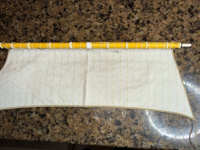

Starting to think about lacing the sheets to the yards. I may try using dental-floss to lace the sheets given its waterproof qualities and ease to work with.
Stay tuned....

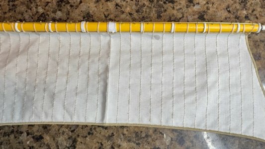

I've been experimenting with using dental-floss to lace the sails with little success. I find the floss too slippery and ungainly to work with.
I settled on .8mm waxed polyester thread most commonly used for leather work. It's much easier to work with, knots can be sealed with CA adhesive and has waterproof qualities.

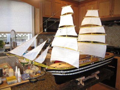

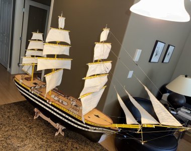

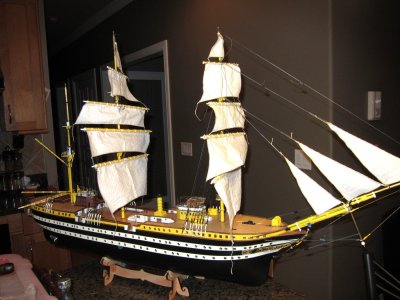

Two masts completed. Sheets laced.
Only the mizzenmast remains... estimate 4-6 weeks to compete that task, after which the ship should be ready for its next sea trial....on sails.

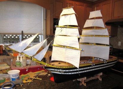

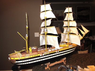

A little update. All the masts are now complete. Plus, one more day to complete the shrouds.
I should have the Mizenmast sails all laced up by the end of the week.

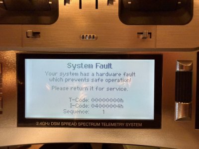

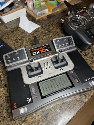

As mentioned above, I procured a new radio for this project. It arrived the other day where I immediately charged the battery, then registered the transmitter with the manufacturer (Spektrum). I then downloaded the latest firmware for the radio to bring it up to date.
Performed the firmware update procedure. ... and then... nothing!!
The radio froze!!! Nothing I could do to reverse the upgrade, or reset the product.
Now I'm stuck returning it to the manufacture for repairs.

The radio is back from the shop... with firmware upgraded and fully tested.
I expect the last winch servo to arrive next week at which time it will be installed, and final running rigging can be run.
We're getting close!

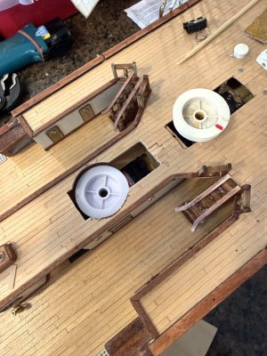

Final winch arrived today... I should have it installed over the weekend.
Perfect spot!
Measure twice, cut once.... that was easy.

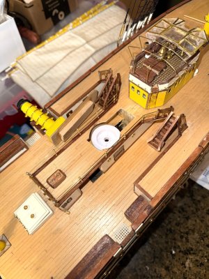

The forth, and last sail winch servo fitted below upper deck.
A quick hatch remains to fabricate to keep things water tight.
I plan to use white, four strand, braided 40lb PE line for all the winch running rigging lines.
With the fourth and final sail winch servo now installed, time to focus on the last challenge...the running rigging.
I'll study the Vespucci layout over the next few days in an effort to try to emulate the original rope routings. Of course there will be deviations to accommodate the RC hardware limitations.
