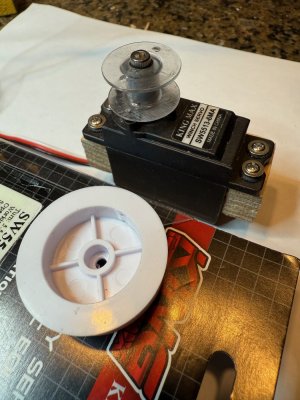

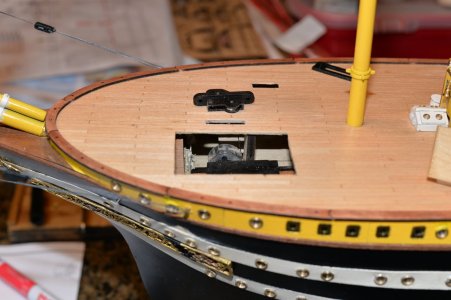

Spinnaker Winch
The spinnaker winch is proving to be a challenge. I needed to fabricate a special horizontal servo winch mount, and replace the OEM winch drum with a smaller spool.
Some of you will notice that I used a sewing machine bobbin for this winch drum. I sleeved the bobbin ID with a carbon fiber tube, and drilled it open to 5mm to fit the servo drive gear.
Although the bobbin is half the OEM drive diameter, it still provides 200mm (8-inches) of line travel. More than enough for the spinnaker.

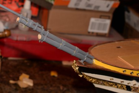

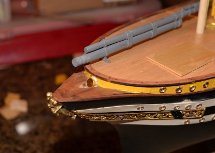

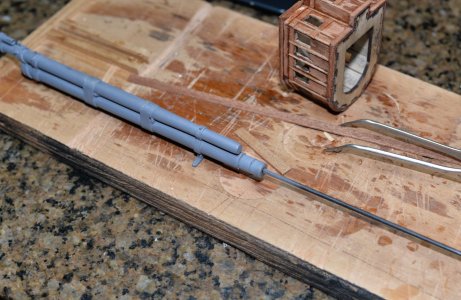

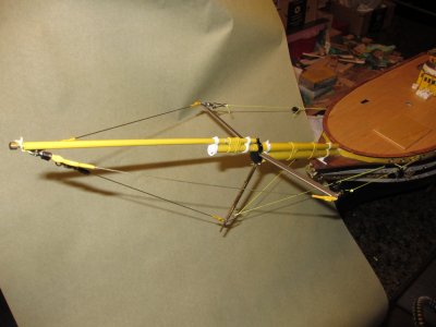

Bowsprit

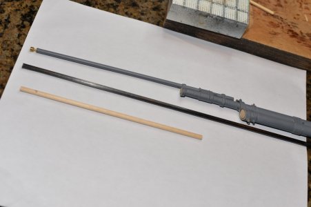

Who would have thought that the bowsprit would have posed such a challenge.
As much as I would have preferred to assemble the kit bowsprit in accordance with the plans, it had become obvious that the kit materials for the bowsprit, although very scale-like, were not up to the rigours of sailing. Plus, it became apparent that the ship would not fit in my car (or the Vespucci wagon) with the bowsprit in place.
To that end, I am currently mocking-up a more robust bowsprit that could be easily removed from the prow during transportation, and then re-installed at the pond without tools.
The 3mm dowel Flying Jib boom was replaced with a carbon fiber tube, plus a 2mm carbon fiber rod was inserted into the base of the Jib Boom to add rigidity.
Both the wood dowel striker and the yards will be replaced with equivalent functional brass and stainless units.
In addition, a brass tube (9.5mm ID) is bonded into the ship prow to allow the bowsprit to be inserted and then locked into place using functional jibstays.
The bowsprit tension lines will be secured with ‘bowsies’ (on order) which will allow me to assemble the unit pond-site with little fuss.

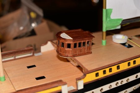

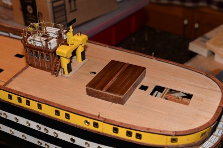

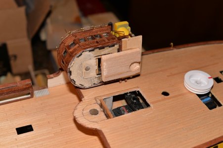

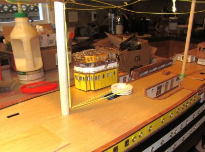

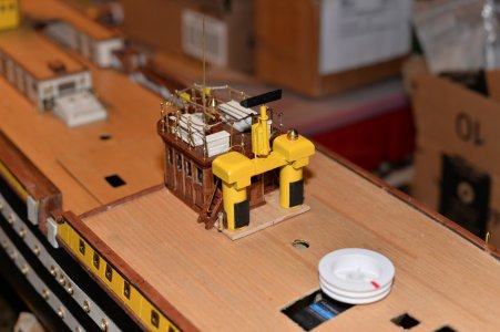

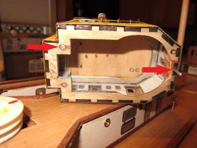

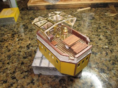

I've completed the aft deck structure which I believe is the Communication / Navigation building.
It has been modified such that it also doubles as a structure to conceal the deck access opening to the rudder steering-servo motor.
As with the main sail servo winch, the structure is held in place with a magnet, and positioned with a snug fitting centering block.
Next step is to build a suitable cover/hatch for the aft spanker servo winch.

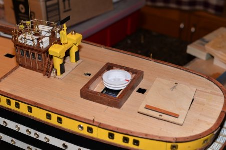

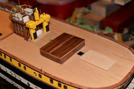

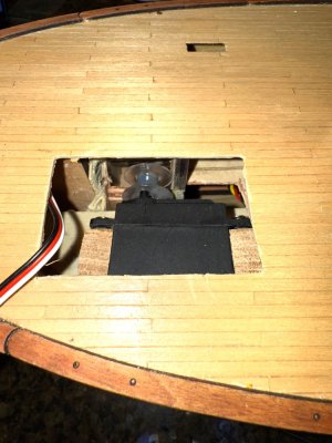

Spanker Servo Motor Hatch
Spent a leisurely Sunday fabricating an access hatch for the Spanker servo-motor. As before, held in place with a couple of magnets.
One more hatch to fabricate for the tiller opening and we're ready to move onto the masts.

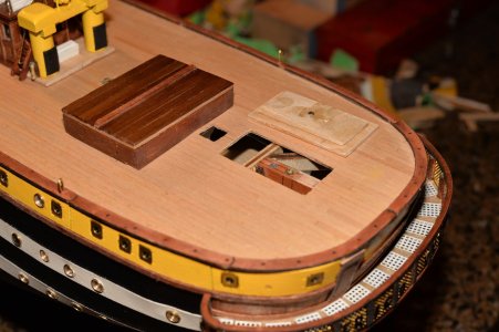

Tiller Hatch Cover
Just completed the tiller hatch cover. Still needs a quick varnish...as soon as the rain stops.

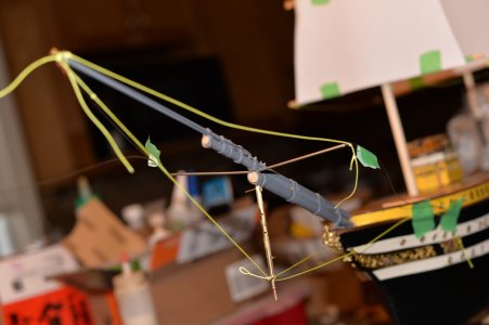

With the RC gear sealed and concealed, next is to complete the bowsprit over the next couple of days, then on to the Foremast.
Bowsprit Tensioned
My materials order has arrived allowing me to complete the Bowsprit tensioning. At some later stage, I'll install all the decorative chains and ropes that the ship calls for. However with the installation of these shrouds, the bowsprit can now support the loads expected from the jibs and foremast.
The rigging is anchored with hooks and clips allowing easy pond-side assembly.

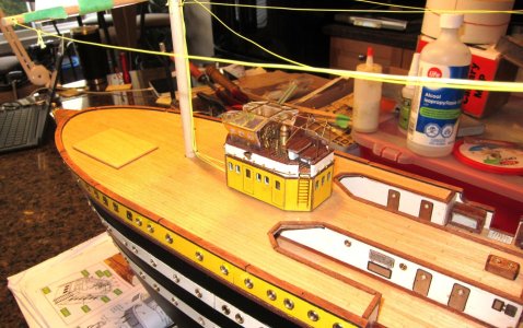

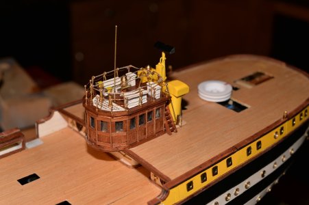

Does anyone know what this aft-end structure is called?
It's been a while since I toured the ship, but I'm very certain that structure near the stern is the wheel house. The other structure, near the bow, I think was the communications room. We weren't allowed in, but through the windows, I just saw some radios and monitoring equipment.
I actually looked into it just now. I was right, that rear structure is a wheel house, but is specifically called the manuel stern rudder station, which houses 4 wheels that the crew uses the manually control the rudder. There is another wheel located at the bridge of the bow, but this one uses hydraulic assistance to steer the ship.
Makes sense.... I revisited the regulations and this is what I learned:
According to SOLAS Chapter II-1, Regulation 29, ships of 100 gross tons and above, and all passenger ships regardless of tonnage, must have a main and an auxiliary steering gear system. The main steering gear must be capable of turning the rudder from 35° on one side to 30° on the other in not more than 28 seconds at maximum service speed, and it must be operable from the bridge under normal conditions. The auxiliary steering gear must be independent of the main system, capable of steering the ship at navigable speeds, and brought into operation within 45 seconds of a main system failure.

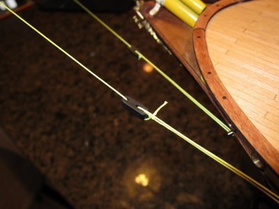

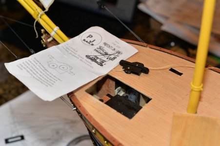

Jib Winch Servo Control
The jib winch setup has by far been the most challenging of the three sail control winch servos.
I sourced a transitional deck pulley component from JP Sails out of the UK that offers an elegant solution to the winch/deck rigging transition.
I’m not entirely happy with the model of winch servo I used for the jibs (Amazon special) as it cycles through its travel range on power-up… none of the other winch servos I used on this model do that! I’ll see if I can still source a superior sail winch through HobbyKing. Failing that, I believe Hitec still offers a sail winch servo…. all be it at premium prices.
With this task out of the way, I can now continue with the fabrication of the mast and yards, whose assembly is handicapped by the horrible documentation provided with this model. Fortunately, we can thank Gilbert for his excellent AV build-log which has proven itself invaluable.
View attachment 568158View attachment 568159
Vid:

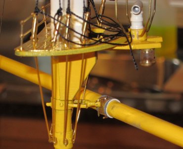

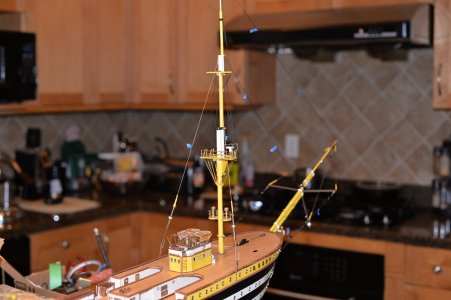

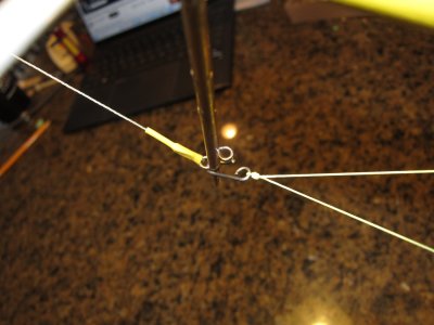

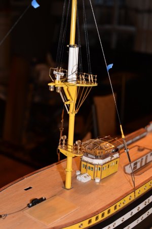

Foremast Progress
The foremast assembly is coming along...all be it slowly. Thank goodness for Gilbert's assembly thread which offers an excellent resource.
Given that this will be a functional ship, the masts require stays that can be tensioned. For that I utilized materials and techniques that I've utilized for my IOM builds. Utilizing adjustable turnbuckles and stainless stay wire, I am am able to tension the mast, and in turn the bowsprit.
I've located a source for mini brass style turnbuckles that I will give consideration to using to replace these stainless units to better fit with the ship style.
A couple of pics....

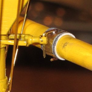

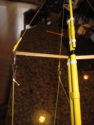

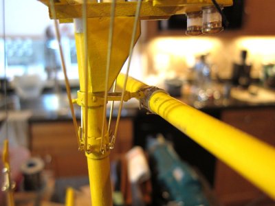

Fore Main Yard Pivot Detail
My focus has now moved to the yard pivot detail. For the foremast main-yard, I reinforced the yard with a brass ring, then soldered a .8mm brass rod to form the pivot point with the mast.
Time will tell if it's robust enough to survive use. Should it fail, I'll replace the brass wire with a tempered stainless steel wire.
Note that each yard will have a different mounting detail. Sadly, the kit plans provide little to no detail how this attachment point should be arranged.
I welcome your input in this matter.
