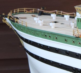

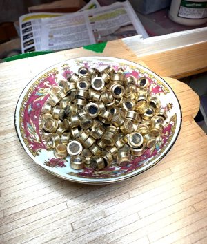

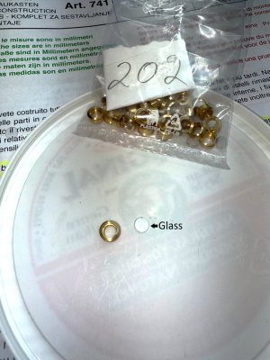

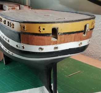

Sorry to harp back on this issue, however if I maintain schedule, I'll be installing the Air/Port holes next week.
I need to evaluate the risk of water ingress into the hull should I install these air/port holes as instructed.
As seen below, the port holes are brass rings in various diameters, each press-fit with a 'glass' window. My fear is that should these 'glass' windows fall out, it leaves a water path into the hull.
My options are to glue the windows into place using 'thin' CA glue...which will 'fog' the plexi-glass. Or, epoxy a small dowel inside the brass ring.
Of course, fitting a small dowel into the ring would be the ideal solution, however there are some 200 air/port holes that would take 2-days to modify.
Any suggestions?
Can you put the "glass" in it and then back it with something as a fail-safe?
That would be the PERFECT solution.. however now with the decks installed, there's no way to reach the backside of the port holes.
My first major build error :oops:

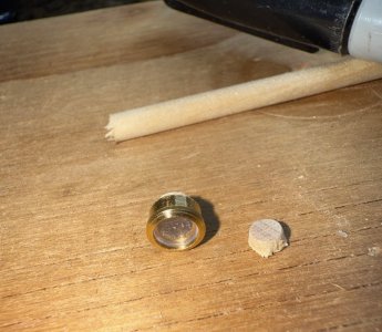

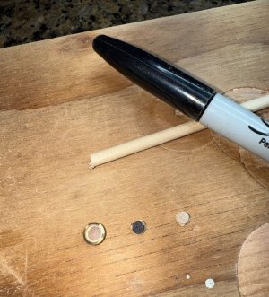

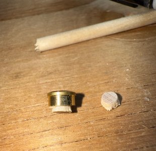

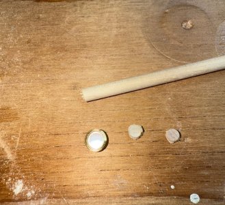

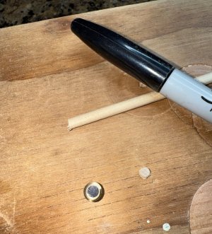

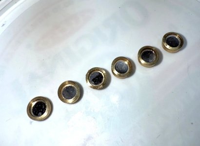

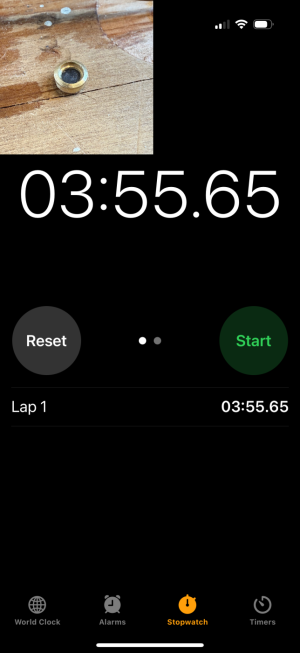

Here's a sample of one port that's been 'water-proofed'. I shaped a cork to fit into the back of the brass port, then CA glued it into place.
The glass window is then press-fit into place.
Sadly, I have to admit that this is the best (and time consuming solution).

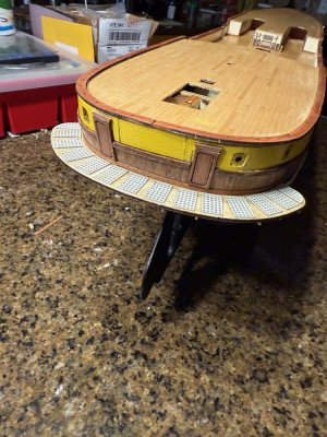

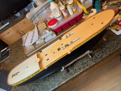

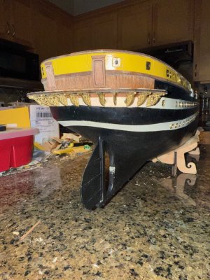

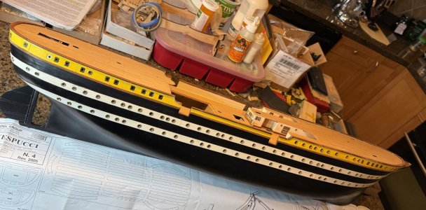

I'm pleased to report that the hull is now complete and ready for pool tests.
I'll have to fabricate a tote-wagon and get her in the water soon.
Afterwards, it's time to focus on the topworks.
