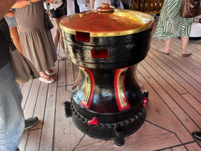

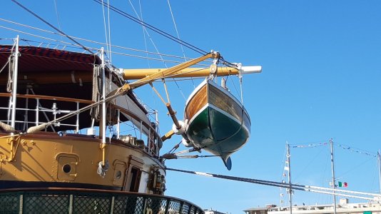

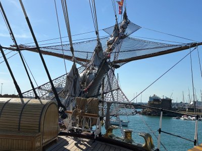

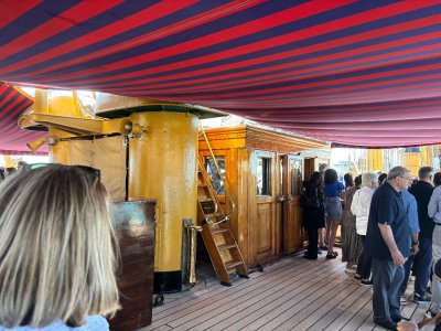

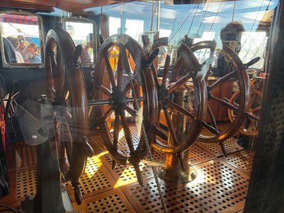

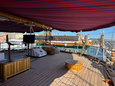

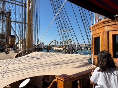

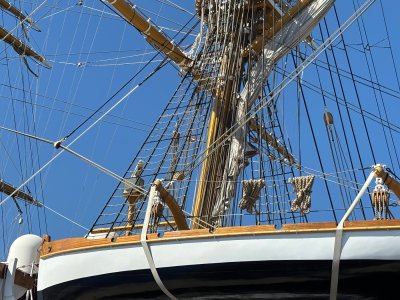

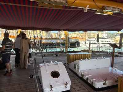

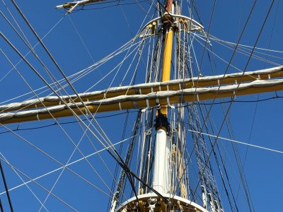

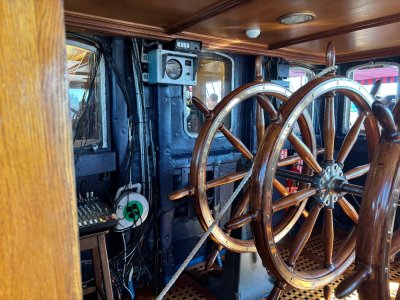

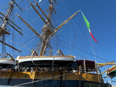

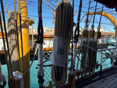

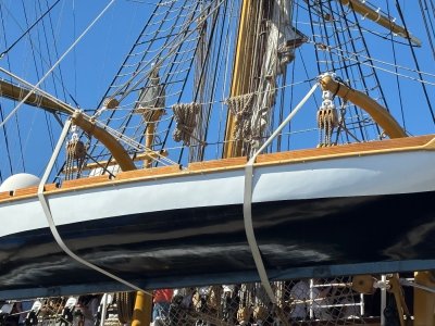

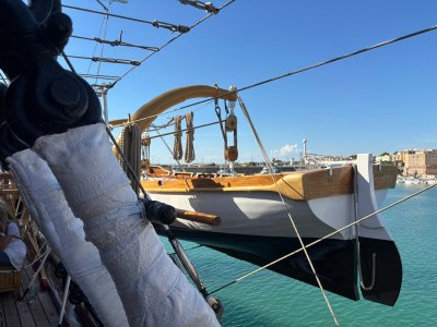

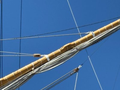

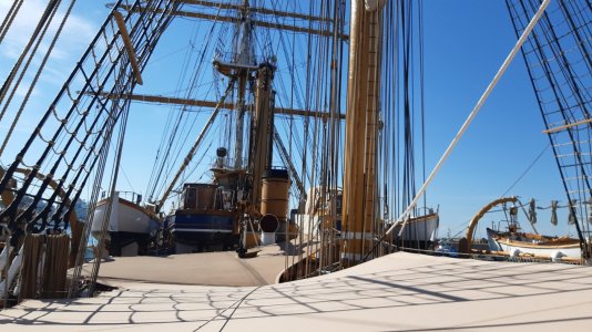

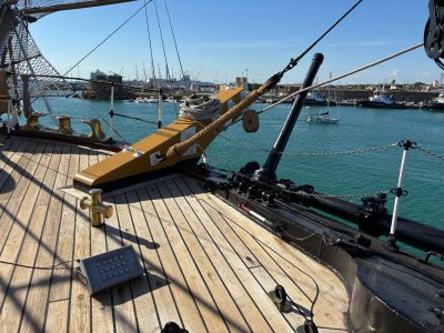

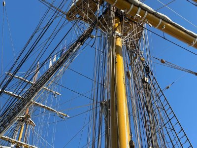

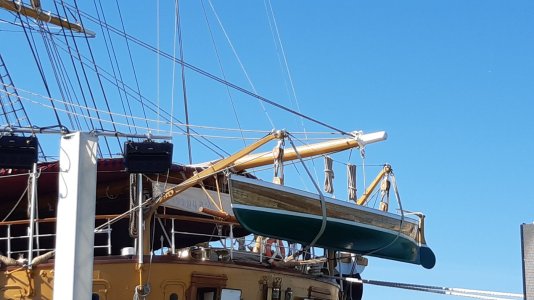

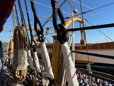

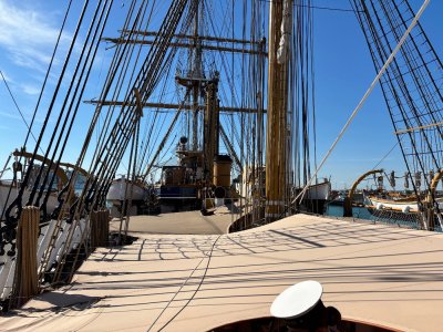

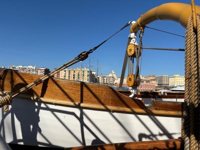

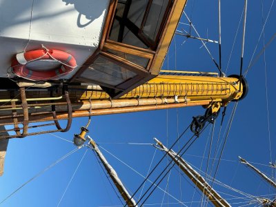

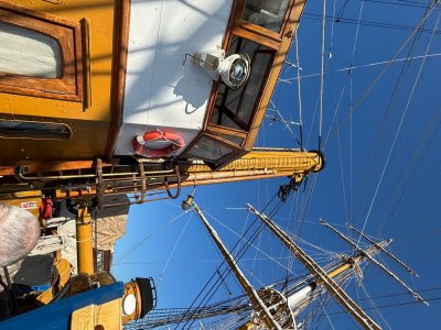

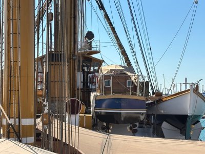

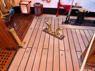

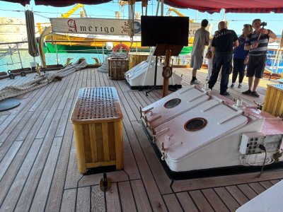

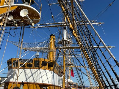

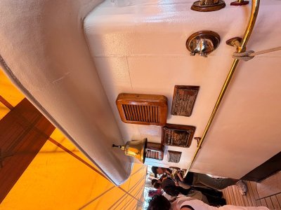

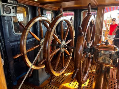

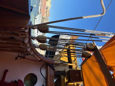

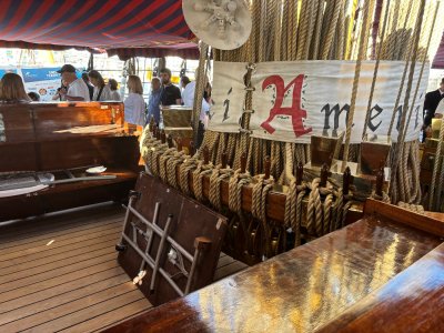

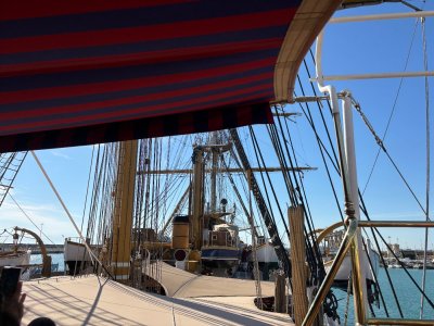

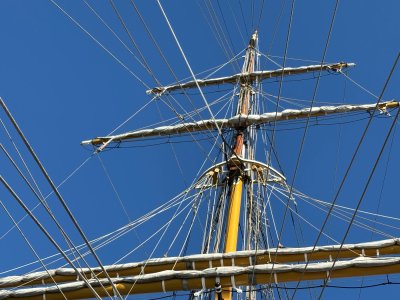

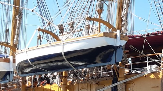

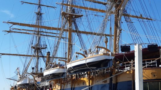

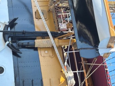

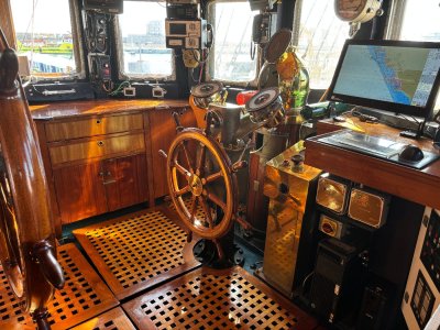

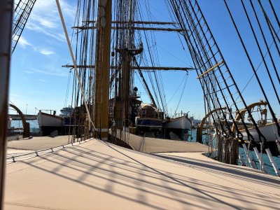

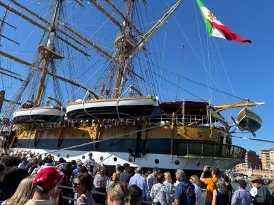

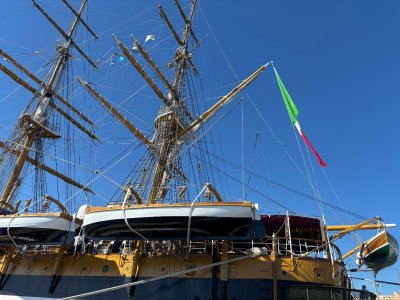

This is a very cool concept, converting a static model to an RC boat. I feel like it would be the ultimate test to see if the design is accurate enough for the function. I look forward to seeing the results.

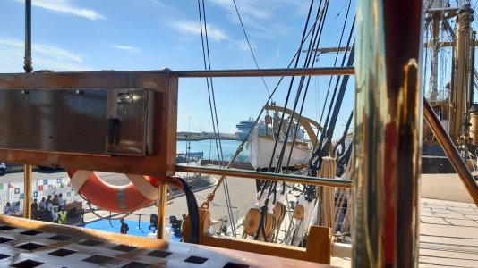

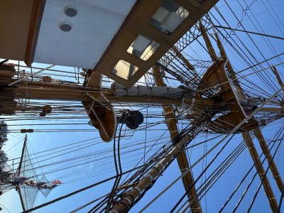

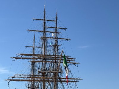

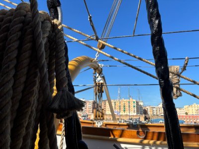

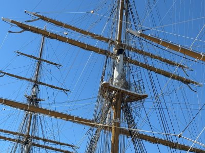

I actually had the pleasure to see this ship in person when it came to Los Angeles last year as a part of it's world tour. It was a very fun experience.
Other posters who have had the opportunity to tour the Amerigo Vespucci managed to take some great photo's that are a great resource for scale model builders.
I've been looking for sources that describe the running rigging accurately that might help me understand how the mains sheets are controlled.

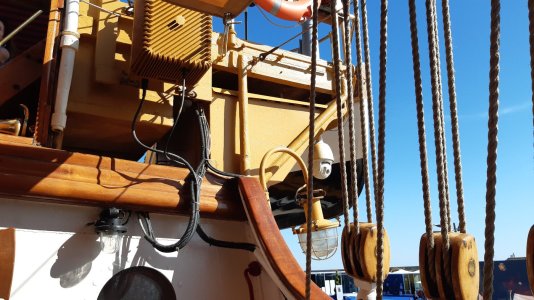

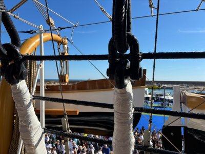

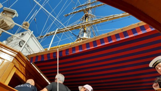

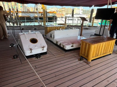

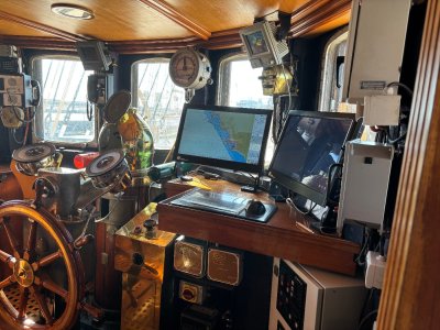

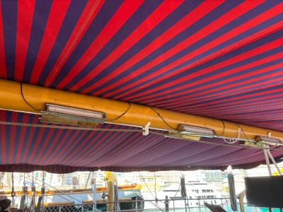

Ho capito la tua scelta, hai di proposito scelto una nave classica con vele quadre una "full rigged ship". La scelta più difficile complimenti.
Mi sto godendo i messaggi e le immagini passo dopo passo, se non ti dispiace li commenterò mano mano.

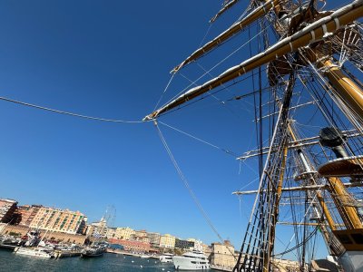

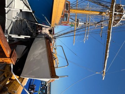

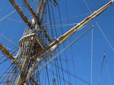

Sono stato a bordo del Vespucci, se vuoi ti mando qualche foto che mi è rimasta, spero di possa essere utile.

I'm enjoying the messages and step-by-step images; if you don't mind, I'll comment on them as they happen.
I was aboard the Vespucci; if you'd like, I can send you some of the photos I have left. I hope they'll be helpful.

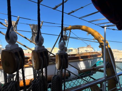

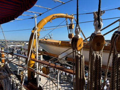

Your feedback and comments would be greatly appreciated.
Any photo’s you may have of the sail running rigging would be very useful.

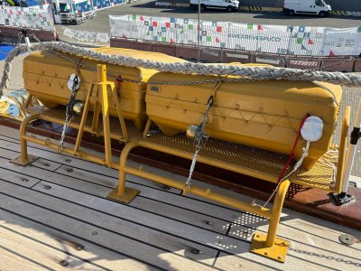

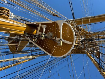

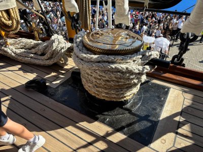

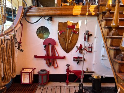

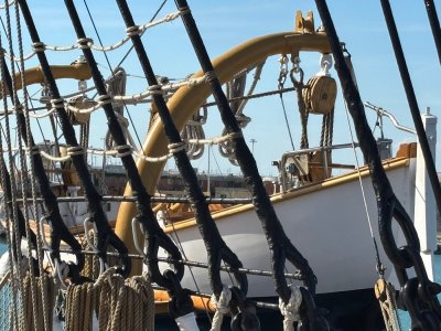

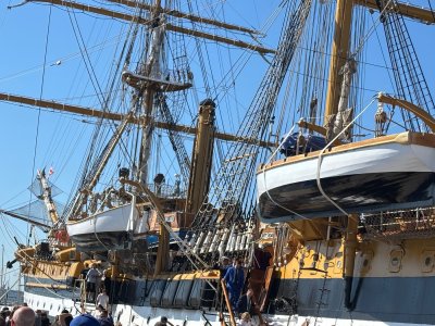

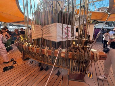

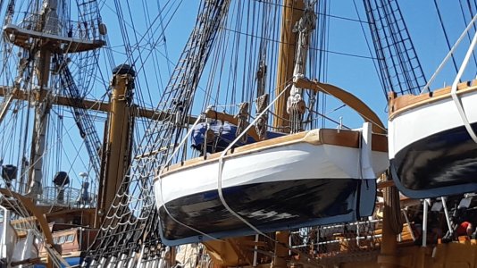

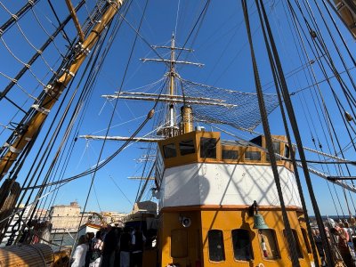

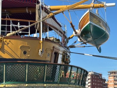

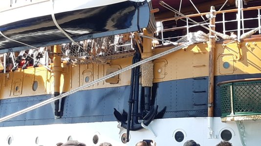

Il tuo feedback e i tuoi commenti sarebbero molto apprezzati.
Qualsiasi foto tu possa avere del sartiame della vela sarebbe molto utile.

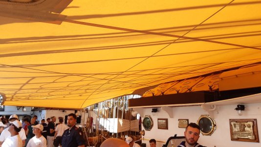

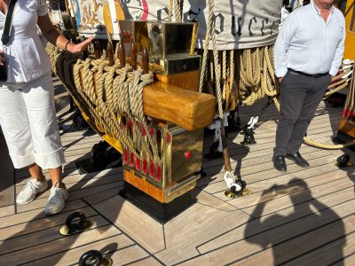

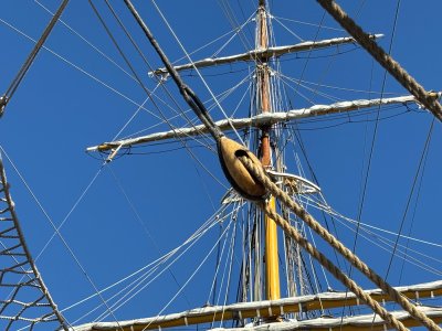

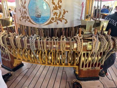

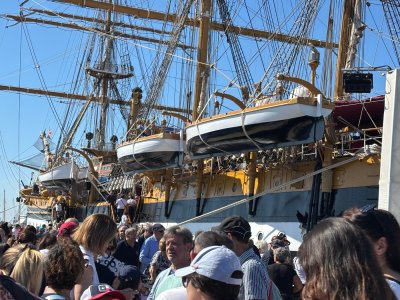

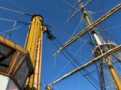

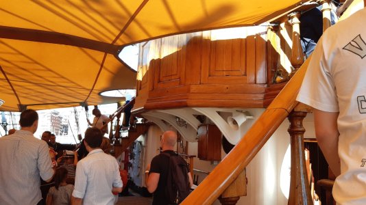

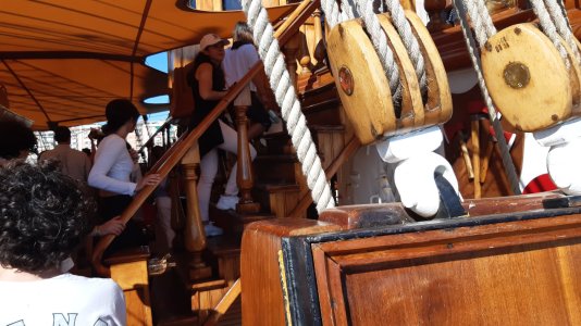

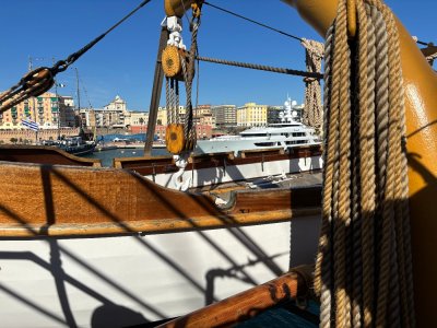

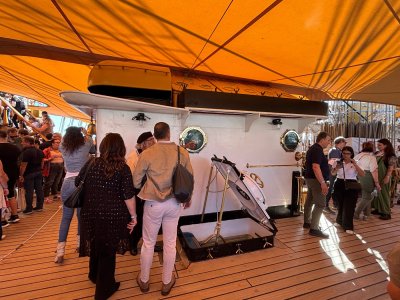

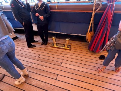

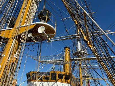

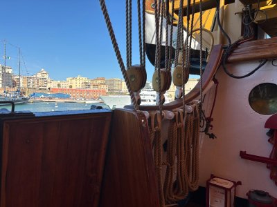

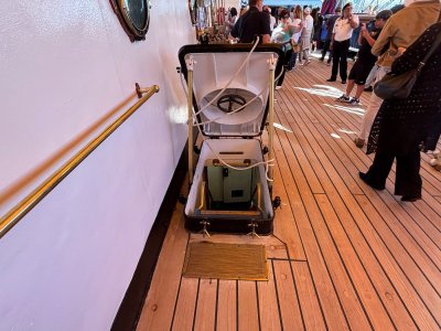

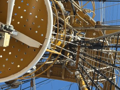

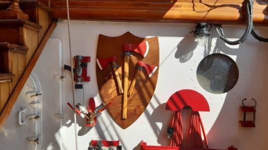

Ciao JJ Lad.
Ho inserito le foto spero che qualcuna ti possa essere utile.
Se tutte quelle foto sono troppo ingombranti, scarica solo quelle che ti servono e poi avvertimi così le cancello tutte, a te rimangono solo quelle utili.
Se invece non ti danno fastidio le lascio li a beneficio di tutti.
I've added the photos, hoping some of them will be useful.
If all those photos are too large, download only the ones you need and then let me know so I can delete them all, leaving only the useful ones.
If they don't bother you, I'll leave them there for everyone's benefit.
Thank you so much for the exceptional photos. They are an excellent resource both to myself and the SOS community. The Amerigo Vespucci is truly a beautiful ship.

Grazie mille per le foto eccezionali. Sono un'ottima risorsa sia per me che per la comunità SOS. L'Amerigo Vespucci è davvero una bellissima nave.

By the way, what camera did you use to take those wonderful photos?
A proposito, quale macchina fotografica hai usato per scattare quelle meravigliose foto?
Ciao JJ Lad.
Beautiful pictures Alessandro
I wish I had those when I built my Vespucci
Ciao
Hi JJ I used my Smartphone, of little value.
