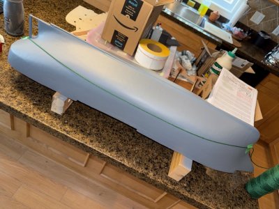

With a coat of primer on the hull, marking the NWL is pretty straightforward.
BTW, now with a coat of primer, it's much easier to spot the blemishes on the finish. Which begs a question, just how 'perfect' should I make the hull? I can spend a few hours of filling and sanding to obtain a blemish free surface, however the actual ship was never built to that standard.
How do you builders approach this issue? Do you try to obtain a concourse like finish, or do you allow some blems in the completed model to increase the level of authenticity?
Hi JJ
Wnen I built my AV, I tried to have the hull as smooth as possible, as much as I could. But for sure it's not 100% smooth.
At least it's good enough for my taste
Your hull looks great after the primer.
What I did was several coats of primer (2 or 3 I believe) with some light sanding in between.
Cheers
Hi JJ
Cheers
Hi Gilbert,
Thanks for sharing your experience. I think I'll do the same. Most of my blems appear to be in areas where the fiberglass didn't lay perfectly flat during the cure. Some time water sanding should be adle to address these areas.
Thx,
JJ

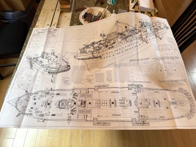

Which brings me to the matter at hand.... the drawing below is the only 1:1 scale schematic included in the kit. However, it only illustrates the 'plan' view. How did builders of the AV accurately locate the position of the port holes without an accurate, scale elevation view?
Am I missing a schematic?

Hello JJ
If you look at booklet #2pages 12-14, you see the boards that include all port holes
I feel this is the easiest way to correctly position these windows, using plan sheet 2 as well
Hope this helps
Cheers

Hi Gilbert,
I'm surprised Mantua didn't include a properly dimensioned schematic for the port-hole locations. However with the documents you referenced, I'm confident I can locate them in the generally correct location.

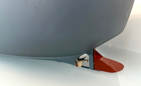

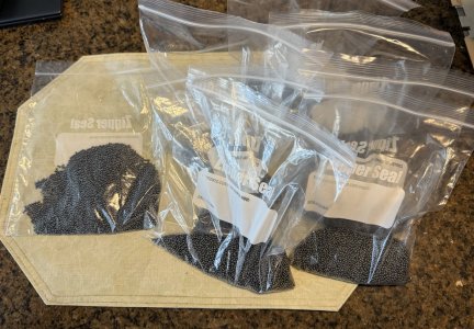

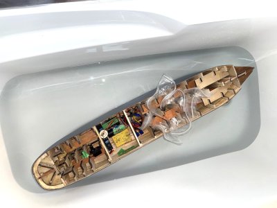

The lead ballast arrived today and I quickly got to work.
In my Post #12, I had estimated that if the kit was designed to scale, the model ship would displace 14.023lbs, or 6360grams.
The hull was assembled with motor, propellor, rudder, batteries and all associated electronics.
I then divided the lead ballast into 500g packets and loaded the Pb on board to float the boat on its normal water level (NWL).
With a tare weight of 3160grams, it took another 4000g of lead to ballast the boat for a displacement of 7160grams.
I suspect the additional 800grams of displacement was gained from the fiberglass layer I added to the hull.

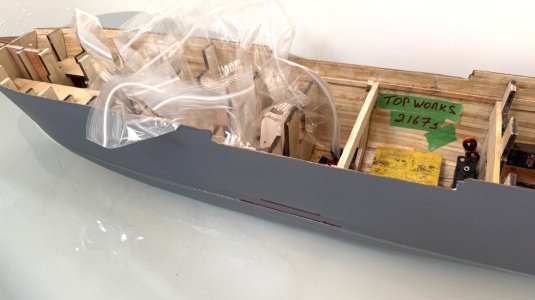

I will need to estimate the weight of the deck topworks and reduce that value from the total ballast.
0_Lead 500g bags.jpeg1_AV 4KG Ballast.jpeg2_AV 4KG Float.jpeg3_AV Rudder Depth1.jpegFiberglass.jpeg

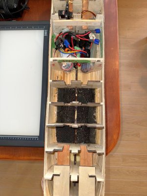

Poured the ballast today and mixed with slow-cure epoxy.
I used 3500grams keeping 500grams in reserve to trim the boat when complete.
Once cured, I can fix the decks and proceed with the prescribed build.

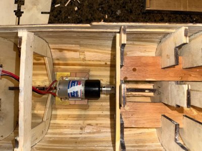

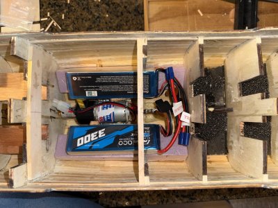

Motor is now mounted into position. A flex coupling secures the gearbox output shaft to the prop shaft.
Note that the motor is not hard-fixed to the hull...rather it's permitted to float in an effort to reduce any vibration and noise.
Normally, I would affix the motor in place with rubber feet, however as the motor sits so low in the hull, that approach isn't practical.
A friction fit brass bracket keeps the motor in position.

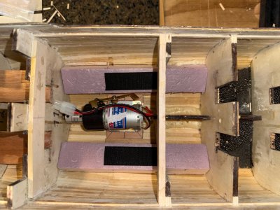

Just about ready to secure the main deck and batten down the hatches...but first needed to fab a couple of battery mounts.
Some insulating Styrofoam blocks carved to fit the hull, and a couple of strips of Velcro is all it takes.

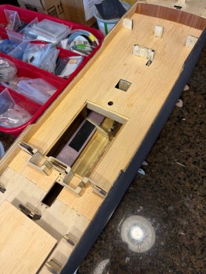

I'm well into the tedious exercise of deck planking..... wondering, are these deck planks supposed to be stained?
Can't find anything in the build guide that confirms if a stain should be applied to the decks?
Any guidance would be appreciated.
Hi JJ
I used 2 coats of matt varnish with a light sanding after the first coat
Quick update....
Completed the deck planking today. Next up... prep the hull for paint. Then a couple of sea-trials to test the propulsion and rudder.
Still need to figure out sail controls, however I have decided to limit control to the mainsails, spanker and jib.
