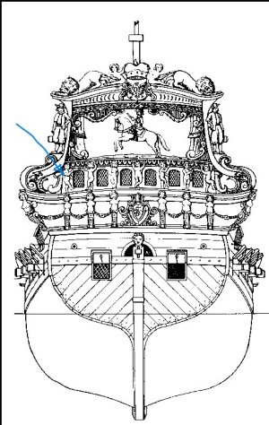

Alright, folks, I've made some progress on my carving journey and wanted to share where I’m at. I’d genuinely appreciate your thoughts and guidance, especially if you can spot areas where I’ve gone off course (unless, of course, the whole thing is one glorious mistake!).
Constructive feedback is most welcome, I'm here to learn and improve.

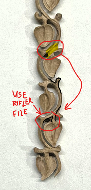

This is great JImsky! If I could make a few suggestions...
Yellow highlight - don't pass over or through branches, instead stop before the intersection and come back with a rifler file and create a sharp corner. Then you can round that area with a file or the edge of an xacto knife by scraping. I like using an xacto knife to round edges on inside corners because it has a fine sharp tip and I can access the inside of a corner. Hope that helps. Don't limit yourself to one tool. I use all kinds of dremel bits, files, and an xacto knife on each piece I work on. I throw everything but the kitchen sink at it...ROTF

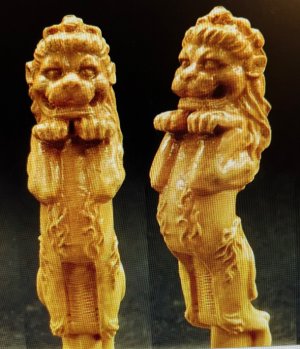

And I realize that making a face is quite difficult. You will have to take into account the contours of the side and front. The nose and chin sticking out, the deeper lying eyes. Making a head takes a lot of practice. I also hear from fellow builders who do this work that this is one of the hardest things you can do. My first face I made was also completely out of context. Nose was out of proportion to the rest.
What has helped me a lot to delve a bit more into the proportions of a head are Loomis' drawing methods. If you Googled “Loomis method” you will come across many of his books (which are free to download). This method uses circles and proportions to create a face. With this in mind, I even manage to make a head without an example. Just transfer what was in my mind to wood.
I do not claim that wood cutting or milling is easy to do, but you can teach yourself. It takes time but from the other side it is fun to do. For these two examples I cited, I also made a bookmark with a head of a figure from the Dzhengis Khan era on the end.

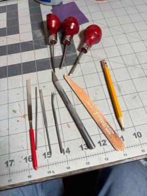

Thank you, I don’t have the experience or expertise you do, but I started out with just an xacto as a carving knife and micro files.
I think it’s important to develop good hand skills prior to jumping into rotary carving. I do both now. I still find rotary carving can mess up a piece very fast…lol. So more hand control and tool experience is needed. And of course carving runs the risk of cutting yourself, so I always make cuts going away from my fingers if possible.

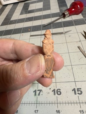

Here is something I am working on now…
It’s in the crude initial carving phase. Thus far I have used nothing but an xacto and files. This enables me to get sharp edges of if I chose. Sometimes rotary carving leaves you with everything rounded off, which is normally not what you want. So I use it sparingly.

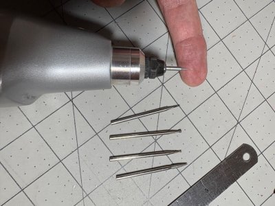

My tools…
IMG_8028.jpegThese are my standard go to tools.
And rotary tools…
These are just a few I have, but the ones I use most. I have 100s of dental burrs, as a friend of mine owns a dental lab. ;)

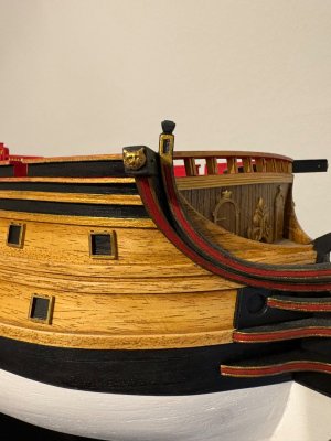

A few examples of my work on my current build…
IMG_8030.jpegIMG_8031.jpegIMG_8032.jpegIMG_8033.jpegIMG_8037.jpegIMG_8038.jpegIMG_8040.jpeg

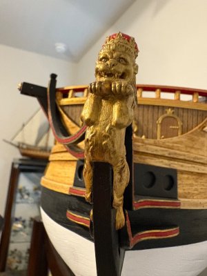

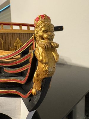

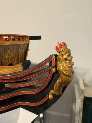

The figure head was purchased from CAF and highly modified. I it was a good foundation to start with … I cut the crown off and added fangs and teeth, more detail in the hair, eyes, etc. and carved a new crown. I used an xacto and files on the crown.
How it came…
No disrespect to CAF, but I didn’t like that it looked like it had a smile, no teeth, blank eyes, and the crown was wrong for my ship.
To make the cornea of the eyes, I made a custom gouge out of a piece of tubing with the correct id, then pressed it into the middle of the eye. Then I came back with an xacto and removed a little material all around the diameter I had just cut. So sometimes I am creative and make a tool I need.
As you can see I changed the nose to be more like a Lion imo. ;)

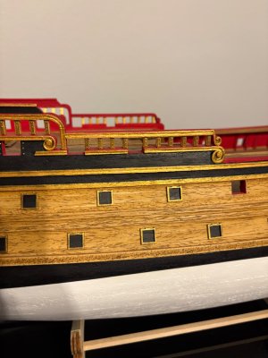

The scrolls and coat of arms and the galley carvings employ both rotary and knife and file work. I try to use whatever works best for the situation.

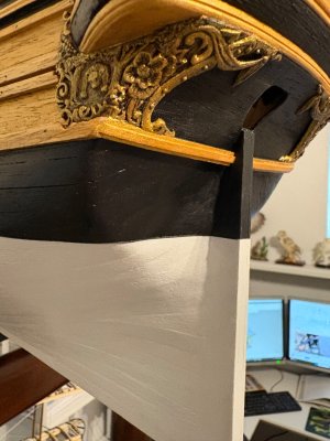

Also when I started the build of the Norske Love, I referenced the scratch build by Karl..
This was the sister ship to the Norske Love and it is very similar. His sharp detail on the carvings is top notch! I reached out to Karl, and he was nice enough to give me some tips to get started carving.

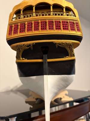

On my ship I am going with a paint scheme of black and gold, so all my carvings are painted and much smaller in scale. I think the paint is actually to my advantage at this point because I can use dry brushing to help bring out detail. ;)

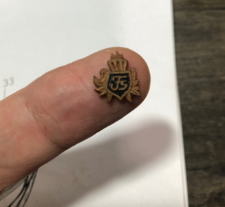

On this coat of arms carving, I used pearwood. To get the sharp edges on the F5 text, I first cut around the edges with an xacto knife and then used the rotary to get the depth around it, and when getting to the edges i kept the burr at an angle to get to the vertical cut and the edges stay sharp that way. At least that's how I did it. Not saying you have to, but it helped me.

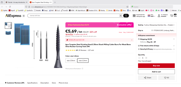

@Jimsky I searched a few others who sell them. Maybe they deliver to the states.
Many thanks, I have those burs, I bought them way before increasing tariffs
