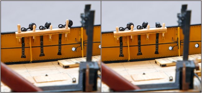

First, 2 detail photos of last-minute adjustments:
I had made a mistake with the size of the belaying pins. I had made them 10 mm, which is 50 cm as the original.
But they are 40 cm, and that is a factor too large. On the left, on the outside, is the oversized one. In between are the correct ones, with a full belaying pin rack on the right.

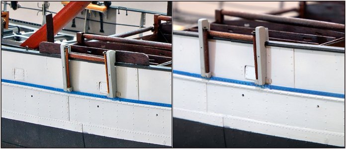

An observant volunteer on the Balder drew my attention to the 'standing 'geestrollen' / hoist rollers' being too short. These need to reach the top of the uprights to be able to haul in the nets properly.
Removed the top eyes, made longer rollers, and secured everything again. (Right is wrong, left is good) 'It's all in the details!'

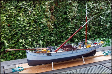

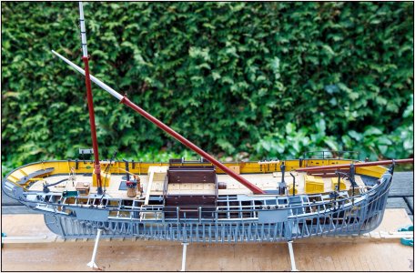

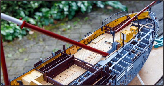

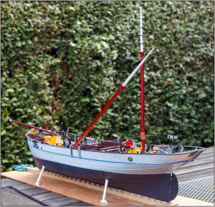

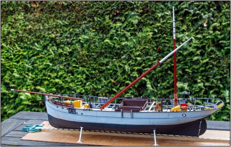

It was beautifully calm and cloudy, so diffuse light. Time to capture outside how the Balder looks now with everything on and around the deck and bulwark.
This will be the setup I will continue with:

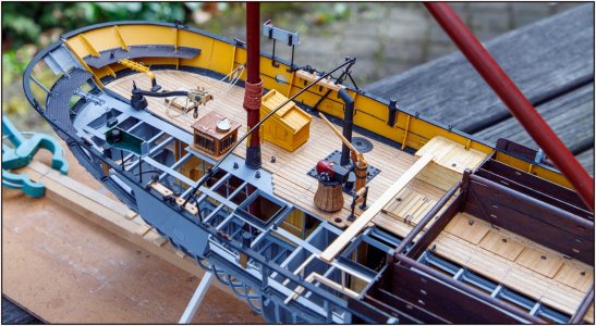

A slightly better view of the deck:

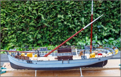

From front and back:

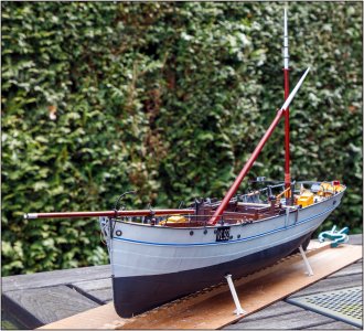

Zoomed in on the fore and aft decks:
