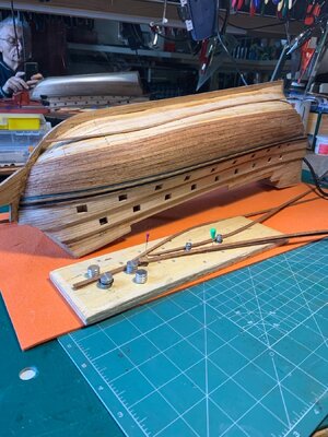

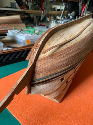

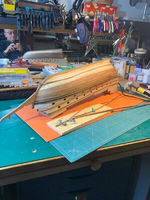

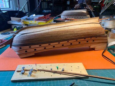

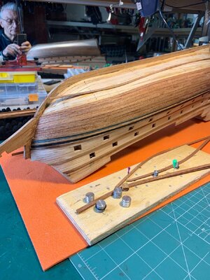

I started the final 2. planking on the primary planking of my new model La Couronne from Corel. The attachments can give you an idea for tapering and positioning of the stripes.The material of the stripes for this part of the planking are mahagoni,which needs much care while longitudinal tapering and during hot and wet bending. They are very brittle because the kit is from 1990. I am using CA glue for the planking. I could have also used aliphatic glue or Uhu Hart but hey take more time to dry

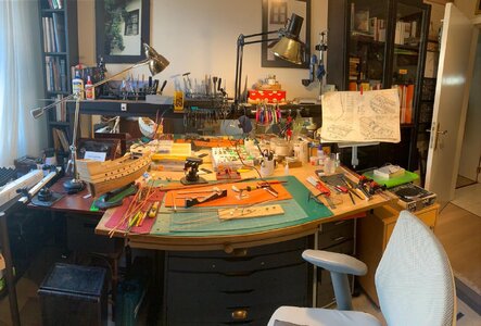

Thank you for the photos including the selfie in the mirror. It nice to be able to visualize the person I'm texting with.
What a beautiful ship and I like your workshop layout.

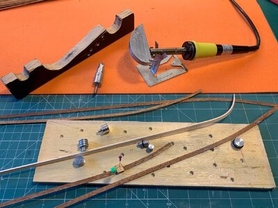

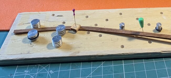

I couldn't help but notice the bending jig on your worktop. Did you make this?
The bending jig on the photo consists of a simple wooden plate with randomly drilled holes (just for different bending angles) The articles made out of wood in the picture are made by myself ,the rest are bought .
With water soaked stripe part which should bend is gently worked out with allready heated soldering iron headpiece incrementally on the bending jig till the desired bending effect is reached (specific head attached)..The pins can be made out of alumunium or s-steel or even out of hard wood to avoid possible rust if sometimes the bended part has to stay wet on the bending jig.

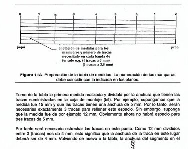

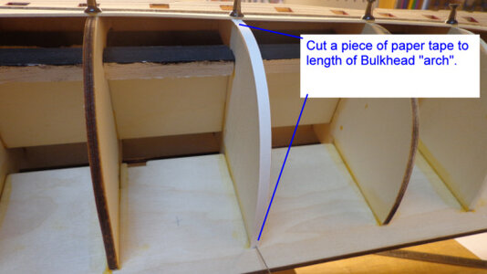

have a look at the MSB JOURNAL. Another one is an article, that I have sent out various times about planking for beginners - my bible - this is what you need. I very seldom use dobbel planking, because following the instruction, you do not need in most cases to do a 2Nd planking, if it is not needed for other reasons.
