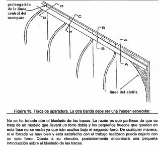

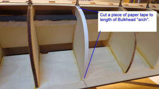

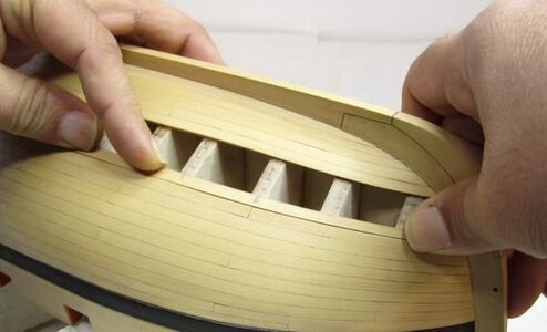

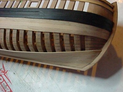

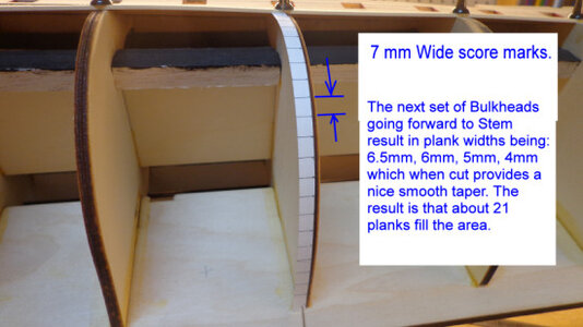

In your case listen to an old Rat like me -more than 60 years of build- and follow the beginner's guide of planking. You will have to measure the widest bulkhead and dive it with the with of the plank- in many models about 4 mm - this will give you an idea of how many strikes you need, not only here but along the whole ship. This means that each strike will have to be cut -which will described in the beginner guide to planking - I sent the article out last week let's say midship you need 70, then you will need 70 on steam- naturally cut into it fit. I learned very early from an Old sailer, that from the start there are 3 main planks- nº 1 about 2 mm below the main deck, and the 2Nd is the GARDBORD ONE. then divide one in the middle. now as you mention the are builders who make 3 or more bands for a more exact measurement. It is correct some builders start from the top and go downwards, then at the same time go upwards. ay the end they will meet approximately in the middle
when done this itIS IMPORTANT to insert a BOWFILLER and some a stern filler.

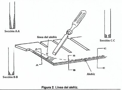

@ El Capi & Ted R. Thank you for your responses. I've put the planking on hold as I'm going to install the bow and stern filler blocks. Also, I searched and read several build logs and found one that had a lot of excellent inputs from El Capi. I think the SoS member was xmtrdude and his Polaris build was in 2022. One of the suggestions was to install the keel before the planking. And following the Beginners Guide to Planking tutorial, I'll carve the bearding line and rabbet on the keel. Then I'll start the pre-measurements before the first plank goes down.
