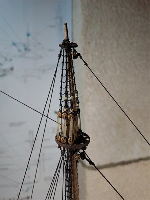

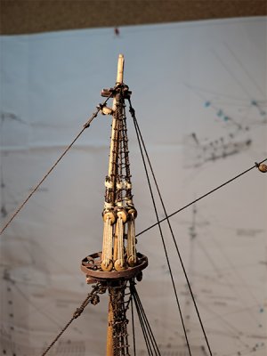

Over the past week, I continued with the fore topgallant shrouds, the fore topgallant stay, the 2 fore topgallant backstays, and installing the fore flagpole.
That is quite a mouthful, and hopefully everything is named correctly. ;)

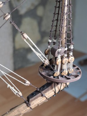

As can be seen in both photos, the topgallant stay is already in place here. Including 2x the 4-1 blocks.
Next, here is the stay image from the underside at the bowsprit. Running along both sides of the bowsprit, through the sprittop.
With some "aging" dust. :cool:

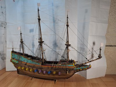

While I was looking at the photo, I noticed that a deadeye block was facing backwards. (but nobody else sees that. Right... :rolleyes: )

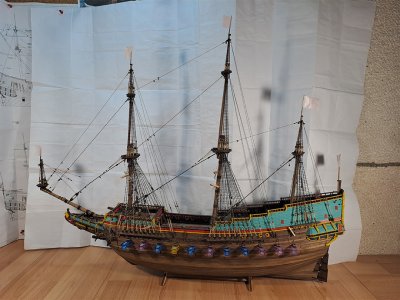

After that, I put the flagpole on the foremast. All masts at there top height.
Once I had mounted all the blocks to the various stays and shrouds and checked everything on the drawing, the standing rigging was finished for me.
Including the full photos of port and starboard.

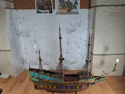

Great work! What is on the gunports? Clips to hold them?
These are clips not to hold canon or ports, but preventing me from hitting off the gun ports. Just like the 4 fake flags on top. So when I turn the ship I see al the preventing obstakels. ;)
I hit some in the past. And had to do then over. Also the flagpole at the back. And one when I hit a lamp. :mad:
Never happens to me (more than once a day) :rolleyes:...

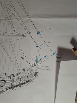

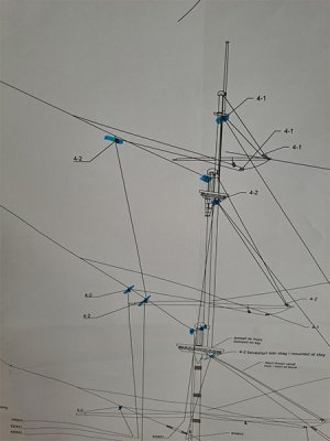

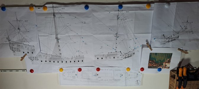

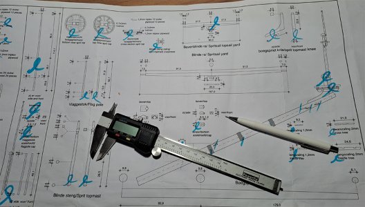

First, the drawings of the standing rigging have been removed and those of the sails installed. As well as an image with all belaying points.
The one with the yards and the accompanying lines was already hanging there as a background.
There is a window behind it, but it never opens. So now it is a "bulletin board".

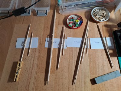

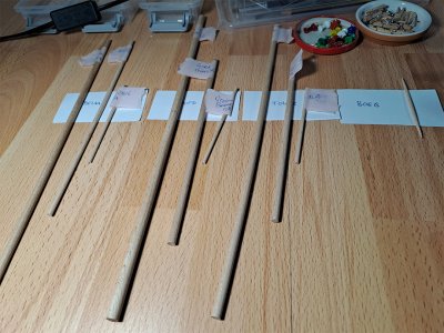

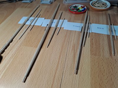

All yards sorted and labeled. The one for the top sprit sail was already finished, as can be seen in the photo.
This one looks very thick due to the shadow. But it is actually only 2.2 to 2.3 mm. The ends are only 1 mm.
See drawing.
All parts will be made by hand using only hand tools. So no power tools involved. No Dremel either.
So, lots of planing and sanding this coming week.

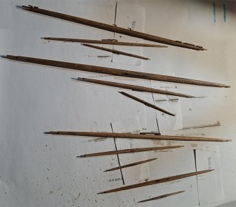

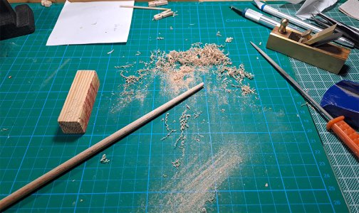

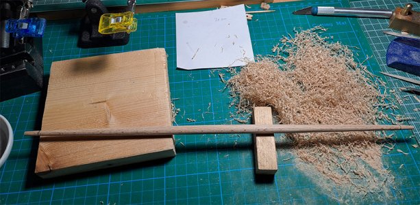

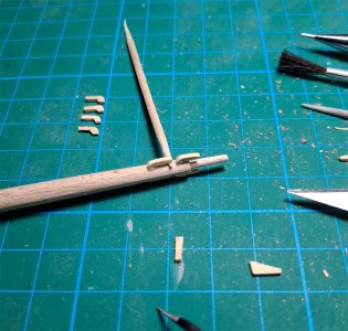

As predicted, I spent the whole week planing and sanding the yards.
And attaching the small wooden suspension brackets to the yards. By Tuesday evening, 5 were finished.

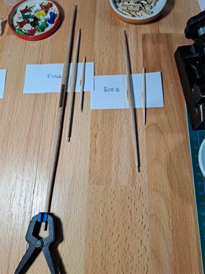

Of these, the largest yard on the foremast has just been glued and is therefore being held in position for now with a small clamp.
The yard with the most working time is the largest yard on the main mast. Below, off to a good start on Thursday evening.
The curls are only from this yard. With every yard, I start with a clean surface. :rolleyes:
The status as of Sunday morning is that 10 out of 11 are ready.
The big mizzen yard is now in the "scaffolding". (as they see in some languages)
The rest are ready for the next step.

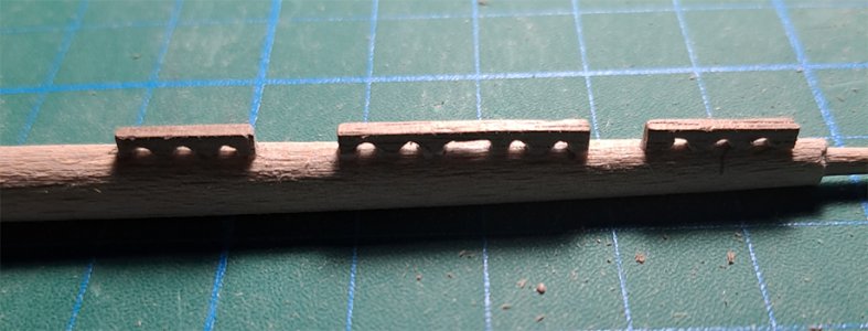

I spent the past week working on finishing the mizzen boom. It actually involves more work than you might think at first glance.
Especially the small parts measuring 1mm by 6mm. There are 8 of those on it.
Parts will also be added to the top of the boom through which the rigging will run later.
Sometimes a clamp just needs a little support after gluing.
Then all 11 of them are ready to enter the aging process. Without anything breaking.:)

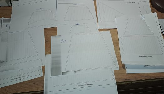

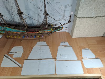

To start with, I first made a copy of each sail from the large drawing.
There are 2 sails that do not fit on an A4 sheet. So, these in 2 parts.
Next week, I will create a plan of action and gather the right materials to make some test pieces

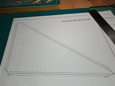

The update for week 25-2026. Today, for a change, on Saturday.
Thanks for your likes.
After making a copy of each sail, I added an extra hemline. My wife and I are going to make the sails together.
It will all be handmade again, just like the entire Batavia project.
The double hemline is there because she is going to make a "rolled hem." Naturally, everything on a test piece first, but that is for later.
With a rolled hem, the "frayed edge" is inside the hem, so you don't have to cut anything off later.
You therefore fold along the first line first, and then do the whole thing again. Just "press" the hem nice and tight.
We'll see if it doesn't end up being too thick, but that's why it's a "test piece."
This does require some experience, and she certainly has that with all her handmade projects.
PS: Her "shipyard" is also bigger than mine. :rolleyes:
But that aside. :)
After all the sails were marked out, I neatly cut them out and placed everything sorted on the workbench, along with the correct yards and rod.
