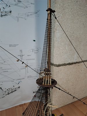

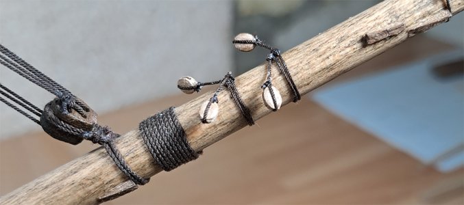

The foretopmast stay has also been installed. With a detail of the connection on the bowsprit. (According to the drawing)
On the port side, this runs along the sprit mast backstay.
There are also two sets of 3-1 blocks mounted on the bowsprit for guiding the bowlines of the fore-topsail and the fore-topgallant sail.
These all run from above these blocks via a 3-1 block on the two stays above them. But more on that later in the process.

I spent the past week working on the main topgallant shrouds. Finished, and the photos speak for themselves.
Both are ready. And as can be seen at the top, the main topgallant stay has also been installed.
Which had already been prepared in previous weeks and temporarily attached to the foremast.

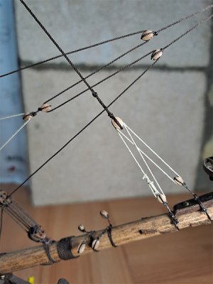

Here is how the main topgallant stay is rigged on the fore topmast.
A double block and a single block with a tackle.

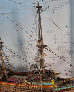

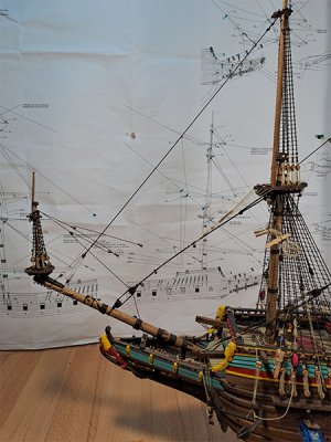

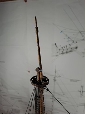

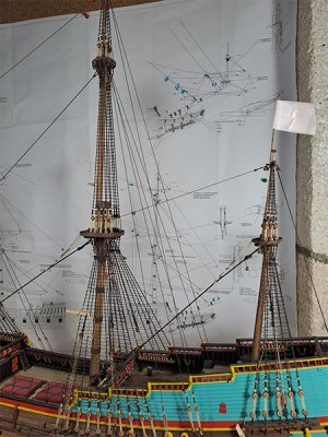

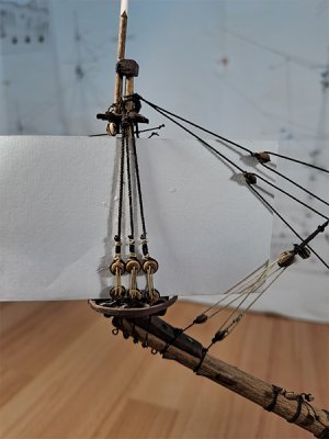

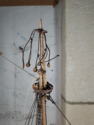

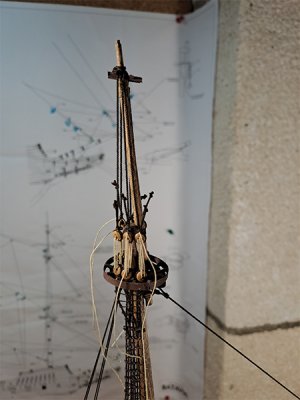

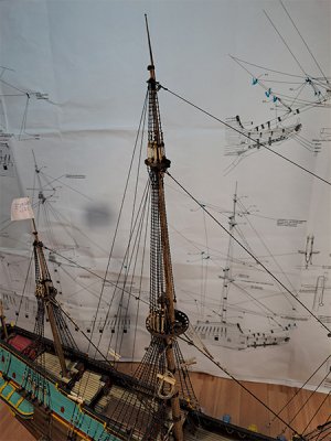

The update for week 21-2026.
Thanks this week for the likes. And the comments.
As "planned," the 2 main backstays were placed, which run from the top of the main stay. I'll just call them main gallant backstays for now. ???
Immediately after that, the flagpole was also placed on the mainmast.
So, "highest point" reached. Beer(Topping-Out_Beer back in the time in building construction when I was young ;))

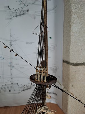

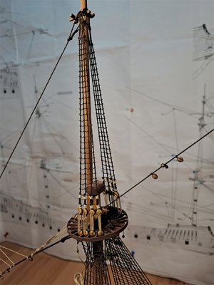

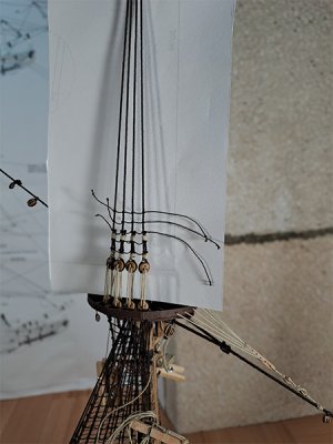

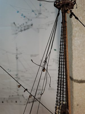

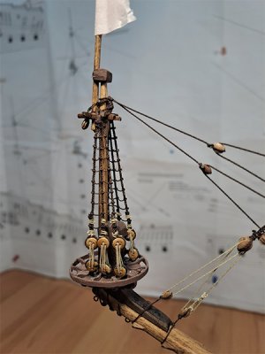

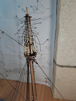

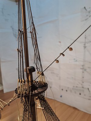

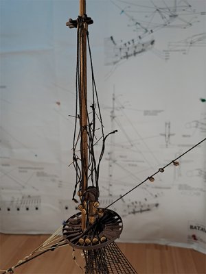

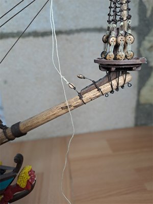

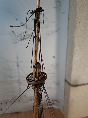

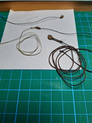

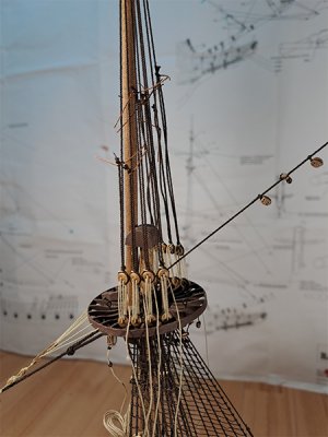

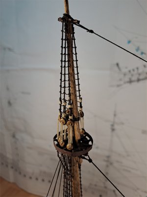

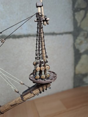

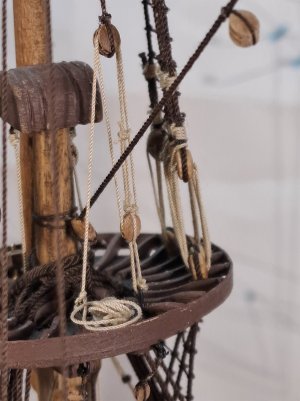

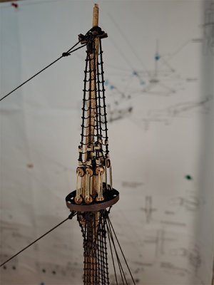

Preparations have also been made for the fore topgallant stay. It consists of the stay (brown), 2x 4-2 blocks, a tackle (beige) in between, and a lower rope (brown) which will run through the bowsprit top in front, under the bowsprit.
I will install this after the fore topgallant shrouds are finished.

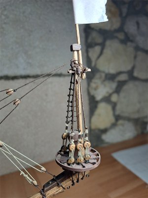

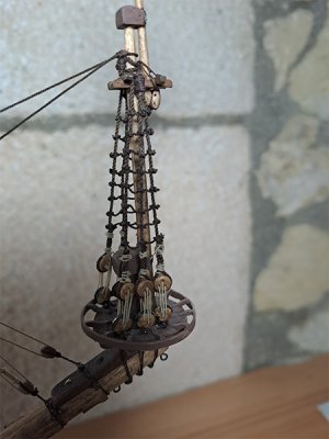

Also hung the last blocks on the main topgallant stay and started on the fore topgallant shrouds.
With the current state of them as shown in the last photo.
The coming week is dedicated to finishing the fore topgallant shrouds, installing the fore topgallant stay, and, I suppose, installing the fore topgallant backstays as well.
I’m making this name up myself because I cannot find this name in the book of Rolf Hoeckel’s descriptions.
"Model Building of Ships 16th and 17th Century, P.N. van Kampen and Son". (is in Dutch/Netherlands. Mabey there is an English version. I do not know)

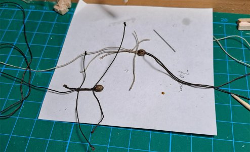

I am new to this forum but I am building the Batavia now and just starting the standing rigging. My previous build was the Prins Willem. After I complete the dead eye assembly it wants to twist slightly, all of them in one direction. In my previous builds I have not seen this. It is not that bad but I see yours are straight. Any suggestions on what I am doing to get the twist. Or what I should do to correct this.
Hi Johnny,
This is not always happening. The turning.
In my case I always hang the ropes, after I cut them in length, with a small weight for 2 days in free space. The weight will turn the rope like it will when you put tension on it.
Make/prepare the tackle.
If you attach the deadeyes, you see that the rope still want to turn.
But if you take the rope between your fingers from the top to bottom and start moving, it start turning and you see the deadeye turning. When you reach the deadeye, your "turning" is almost out of the rope, and try to fix the deadeye in place. Take the tackle and make at least 2 or 3 connections. But keep the deadeye fixed from turning back.
In most of the times if the tension is light on the rope, it will not turn back. In my cases it did not.
But do not fix the tension strait away.
If it still turns a little try a little more tension or a little less.
This works for me.
If someone else knows more or better ways, please reply. ;)
Thank you. This makes sense to me. The line in the kit is tightly wound on a spool and I can see it has a twist when it is undone. I found that wetting and pulling the line helps greatly to relax the line and I can see hanging it with weight will add to straighten it. I will definitely proceed this way.
