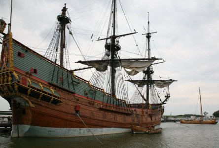

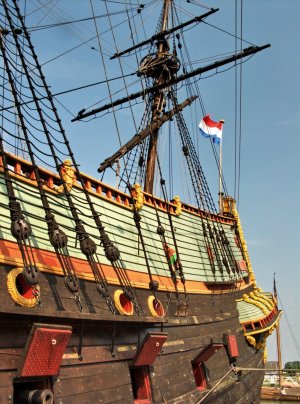

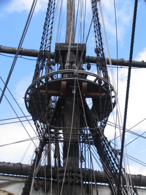

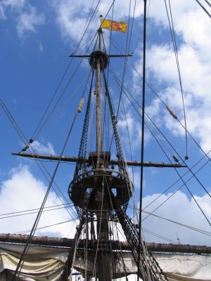

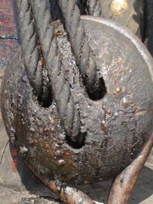

Dear Clemens! You need to paint the deadeye lanyards black. The lanyards, like the shrouds and deadeyes, were completely coated in grease.
View attachment 606981View attachment 606982View attachment 606983View attachment 606984

I have almost the same images as you show. And on the Batavia replica are more things build on that where not on the original in that time.
I'm not make a copy of the replica Batavia. ;)
A kit is not always authentic.
I use the brown rope and the beige as contrast. Instead of the black on your images.
So for me I keep it this way. A kind of freestyle.
Igor is right about that; the halyards, just like the shrouds, were tarred. The reason was to make them resistant to salt water. But tar was also used during tensioning to ensure that the rope slid through the eyes a little more smoothly. As a lubricant, in other words. So that more tension could be applied. Afterward, they were tarred in their entirety. In fact, all ropes that came near the waterline were tarred, including the tacks and sheets, for example. However, a thinner mixture of tar was used, unlike with the shrouds or stays, which sometimes literally looked as if they were covered in a thick layer of tar.
But I get your point about contrast; this sometimes looks better on a model.
