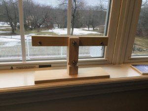

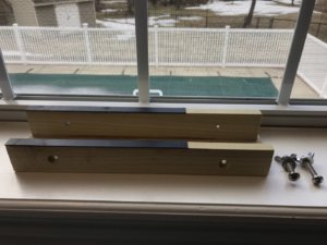

I and several other forum members have made different versions of hull/keel clamps. I made mine using simple hand tools and have used them on my Enterprise, Sequin Tug and Lobster boat builds. I’m not a wood worker, don’t have many shop tools, but like to use what I have on hand to do my variou projects.
You can find a description of my effort in my 1799 Enterprise
Jan
