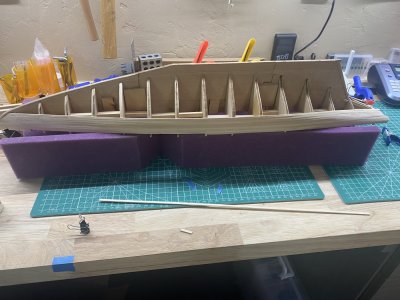

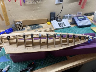

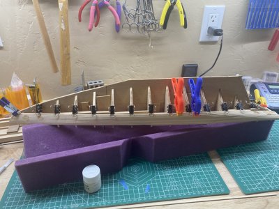

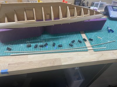

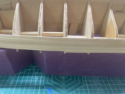

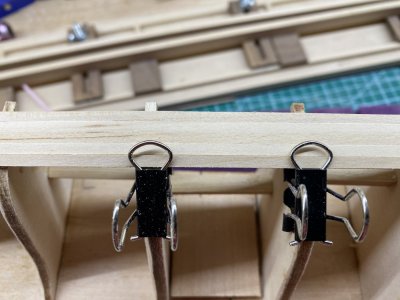

Hi Rob. At the beginning of your log you mentioned the log of the Suburban Ship Modeler. He was planking the deck after installing the bulwark and waterways. And he placed the nibbled outside plank against the waterways. That was in my build-log also part of the discussion if the decking was leveled with the waterways or the waterways on the deck planking.
I posted some pictures of the leveling on the original BN and the BN-II in -> this post <-in my log.
And if you are building the deck that way, then you can build your deck inside that waterways:
But there are also models with the waterways on the deck planking.
Therefore, it depends on quite a few variables in the construction of your model.
In your 1st post you also wrote this conclusion: “there are at least 4 different ways to do this build”. So that also applies to this specific part of your construction. This was ‘just my work around’.
