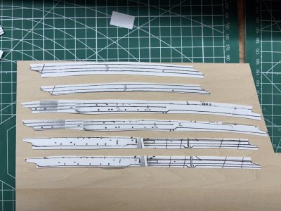

I made 2 copies of the rail plans and decided where I wanted the scarf joints (away from any belaying pin or deadeye areas) I penciled the scarf joints in using the front and rear rail pieces as a form. I then cut them out. I was going to flip one piece of them over for the starboard side but I realized I could use the forms face up and just flip one set of the finished pieces to use on the starboard side. This would make my cutting more accurate. As with the rear and front rail pieces I made previously, I attached them to some 1/16" basswood sheet and glued them to the wood with rubber cement.
At this point the project will again be on hiatus until January. I am looking forward to restarting it. I will be working on my Black Swan kit in the meantime.
Nicely planned, Rob. Looking forward to the results.
