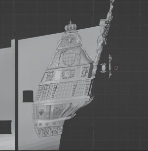

Brilliant 64 Gun Ship 1690 3d Project
Yes; there was always small archng of the stern, as well as all the decks; none were pancake flat..
A bit late, but, was the round up (rounding) of the decks on French ships similar to that of the English ships? The closest I could find is below.

Well, as long as you are happy to hear about possible corrections:
Of course, my current travails suggest I am the last person who should be offering corrections of perspective ROTF.
Oh, one other thing; will you be making an inner frame around those fleur de lis? there seems to be one on the drawings....
Guess it's darkest under lanternROTFThanks again
Please feel free to share your thoughts. I often spot simple mistakes in other people’s work at first glance, only to repeat them in my own without realizing itROTF So please, point out those silly mistakes to me.
I will, ifI see them:))))))
