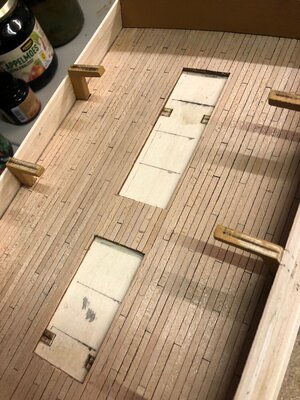

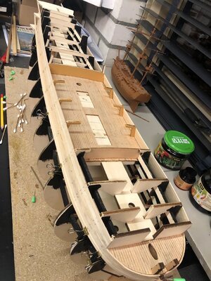

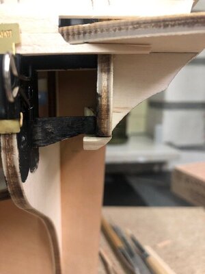

Hi all,
Finally making a start with H.M.S. Victory from Panart art. 738. This is the first time for me building a wooden model. I will share my findings and challenges along the way. Hope you enjoy the result till now as much as i do. It will be a slow process but that no problem. Hope to get some feedback along the way.
Detail of the lower deck:

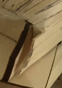

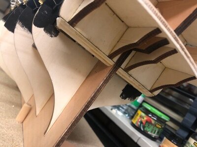

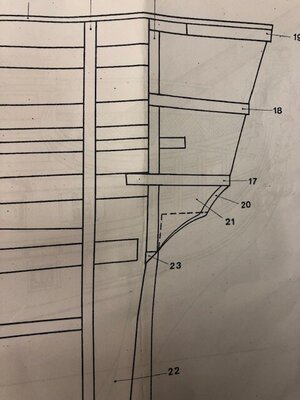

Hi Stefan. I notice your plank just below the stern cabin support is cut short. I had the same instructions and made a big mistake by not ensuring the stern planking extended and bent all the way to the edge of the stern part 21 in the instructions. If you look at my log page 1 about a third down you will see what I am referring to. So far you are owning this.

Thanks for your feedback. I looked into your log in detail seeing the issue and correction.

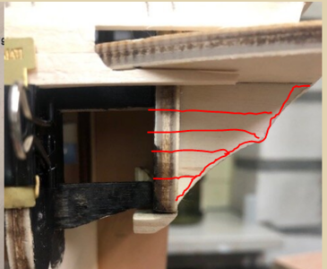

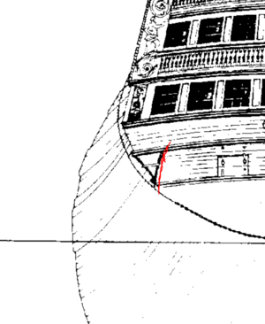

I am trying to visualize in pictures below and the action a have to take:
Sanding down the corner somewhat to make a smoother line to the stern:
Extend planking till the end of red line:

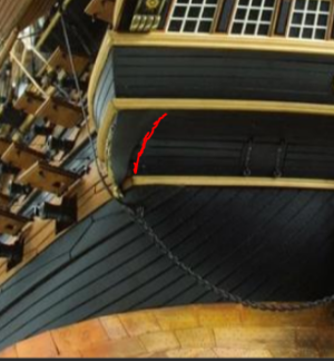

Reference from a colleague builder:
Line on the life model:
I think performing the actions above should give wanted result. What do you think. Something i overlook ? Thanks again, your help is appreciated!
Hello Stefan yep that is perfect. Use other reference points from other builds and research as the Mantua/Panart instructions are poor and many items need to be changed. It is super fun doing so and I only woke up to this realization 2 months into my build.
The Panart instruction leave much to you own imagination but that is ok. I am very happy there is internet nowadays to investigate the work from other builders

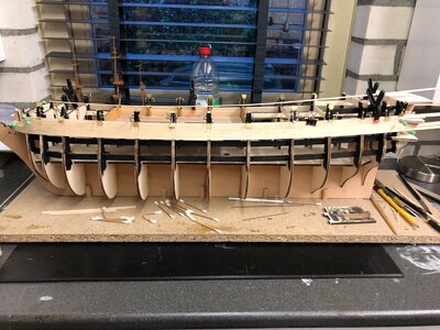

and reference material and ofcourse the original ship in Portsmouth. I am making progress planking the hull. Will start very shortly at the challenging part that needs sanding/fitting the strippes very carefully. Masts and upperdeck dry fitting ofcourse.

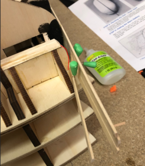

After investigation started bending planks around the stern. Superglue didn't work. So using woodglue instead. 1 done waiting patiently until fully dry because of the tension around that corner. 3 to go. We got all the time in the world. :)
