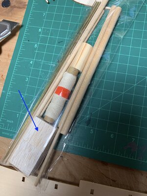

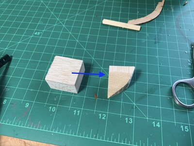

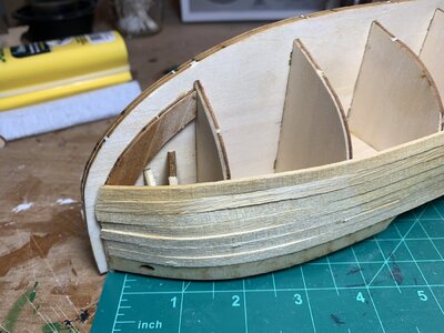

There are really no step by step instructions, so I had to rely on some input from a number of people on the Billings Boat facebook site. An early question was what the square balsa wood blocks were for. There's no mention of them in the visuals or the instructions. It ends up that they need to be shaped and inserted at the stern. Also the planks aren't long enough to go right around to the stern. So I will have to add and bend some short pieces to go around the stern.

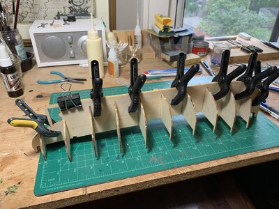

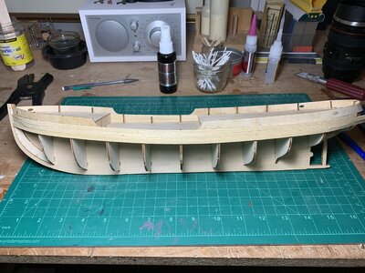

The Billings instructions suggest building the halves of the hull separately, adding the planks to each half and then gluing them together in the end. However the keels were slightly warped and I was worried that if I built them separately and adding planks tom each side independently from the other side, it could throw everything out of alignment. So, I put the two halves together (that got rid of the warping) and will go from there.
Great to see your log up and running Carl.
I think you are wise to build the hull in one complete piece. I constructed mine in the two halves as suggested in the instructions. To be honest I couldn’t see any real advantage that way.

I also thought if it was one piece, it would be easier to make sure that the decks and gunwales were lined up with each other and symmetrical.
I find it interesting that the kit producers don't always use common sense in their instructions. Its always best to apply your own sense.
This is my first Billings kit in almost 40 years. I have done a number of Occre kits, but no ships, just trains and trams. I must say that the Occre instructions are very good. Each step described in detail along with drawings or photos. This one, the Billings St. Roch does leave a lot to common sense. Fortunately there are others who have built this so I am constantly looking at their photos, etc..

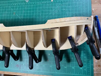

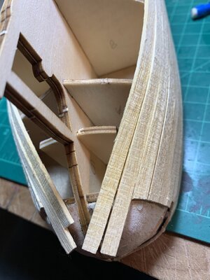

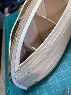

I am well on my way through the planking. I must say, despite my efforts, here will be a ton of work ahead to sand it into shape. Lots of ridges. Fortunately I will be painting, so I just need to make sure things are smooth.
I did not use wood glue. I tried to use wood glue and tacks, but I found the bulwarks to be quite narrow, and getting the pins to stick was problematic. So I have been using superglue, plus accelerant, and it seems to be working OK.

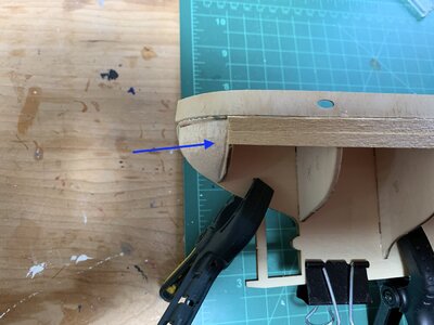

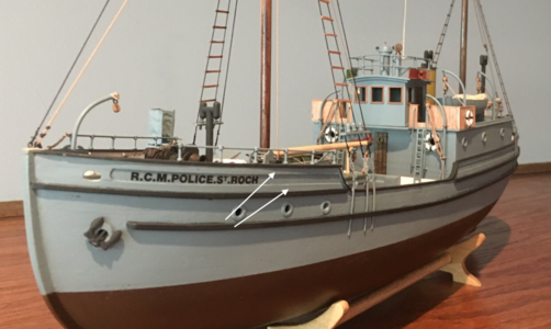

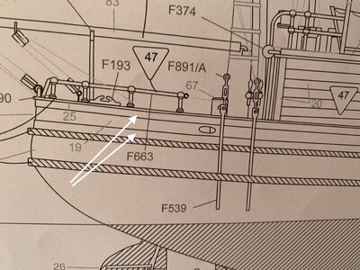

I have a question..What kind of strips did you use here (see arrows). Were these the same as the hull planks or the narrower ones?
Hello Carl, if I remember correctly I used the same ones as the hull planks. The center for’d one (in line with the name) was filed into that curve you can see. The topmost plank was trimmed as necessary.
(Edit: I just checked the model itself and it looks like I used thinner width planks aft but the same thickness as the hull planks - testing my memory :D )
