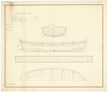

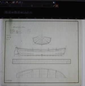

The original drawing shown below is ZAZ 7030 from RMG. https://www.rmg.co.uk/collections/objects/rmgc-object-86821
I inserted this drawing into my CAD program, but the original drawing can be printed at any print shop in whatever scale the builder would like if no CAD program is going to be used.
Once inserted into the program I scaled it to 1:36. NB: If anyone wants a copy of the drawings that will be following in this build log please feel free to PM me your email address and I would be very happy to send them to you. I can send as PDFs, JPGs or PNGs or in DWG or DXF for those using CAD.

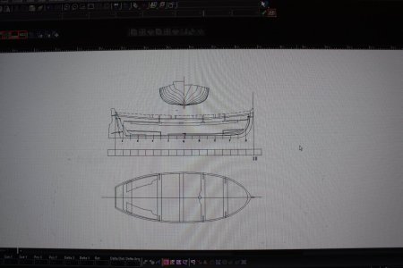

Below are two photos (poorly done, sorry) of the screen of the original drawing that was inserted followed by the first tracing. These are both adjusted to 1:36 scale.
Tracing on the CAD screen
Tracing saved to file.

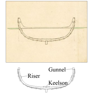

Most contemporary drawings that I found for cutters in this size range do not have a cross section showing the lapstraking. I did find one for a 22 found cutter and reduced it's breadth to match that of the 18 footer to estimate the breadth of the planking. Steel does not give the breadth of the bottom planks in the list of scantlings so this drawing is a big help. He does give the thickness at 5/8" and the drawing shows the planks are 7.5" broad with an overlap of 1.5" . The keelson and risings sizes are sized based on the Steel scantlings.

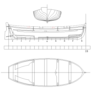

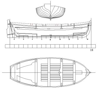

I put together a spread sheet of scantlings and double checked the first drawing. A few corrections have been made and a few questions arose as well. First, the drawing in post #8 has had a few items added and small modifications and cleaning up has been done as well. It is also posted below.
The scantlings spread sheet will follow shortly.
In the drawing I have added the footwaling and keelson. I was not sure of the breadth of the footwaling but found a contract that called for 4 inch wide boards so went with that. The keelson breadth is given in the scantlings. Thickness for both are also in the scantlings. Steel calls for ears so I added them but have some doubts that these were found on cutters circa late 18th century and early 19th century. I also added the knees aft and breasthook forward. These appear to be common so I have added them even though some contemporary drawings do not show them. I am guessing they assume any boat builder knows they would have to be there. Any input on any of these points, or anything else that does not look right would be greatly appreciated. Note that the heel of rudder has been shortened in the drawing to being closer to the scantlings and drawings of other similar boats. If the drawing is enlarged, the pintles and gudgeons have been made a bit more clear.

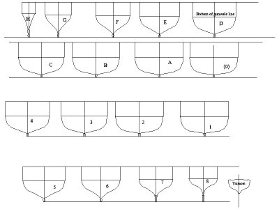

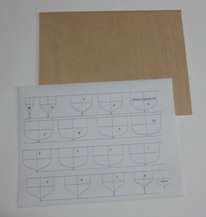

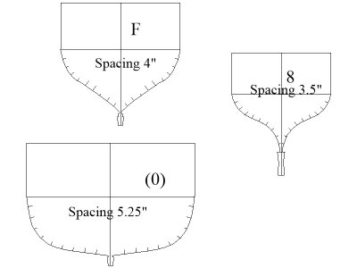

Next up was drawing the moulds. I traced the station lines then redrew the shape less the thickness of the frames to come up with these formers, one for each station line. The extension on top is there to provide space between the building board and the boat itself. I also marked the line where the planking ends and the gunwale will go on. These were drawn at full scale so they can be reduced to any model size scale drawing needed in a few seconds.
Choosing the number of strakes of planking is a bit arbitrary but I use the scantlings for the upper strake or landing strake as a guide for the breadth. In this case 10 strakes is what I came up with, but it may be fewer with broader planks. In order to plank a hull as was done on actual vessels of the time, the frames have to be marked off. I find it is just as easy to do this on the drawings at three or more stations and go from there. The spacing of course varies but with one set up forward, one midships, and one aft, it is easy enough run the planking in the proper sheer.
The planks themselves will be 1.5" wider than the spacing as they overlap with the clinker construction of the cutter except at the bow which will be addressed later. In short the breadth of each plank will go from about 5.5" at the stem to 6.75"midships to about 5" aft at the post.
I am considering going to nine strakes as in the cross section in post 8. Any thoughts from members on this would be most welcome as it does not seem to be something set in stone that I can find so far.

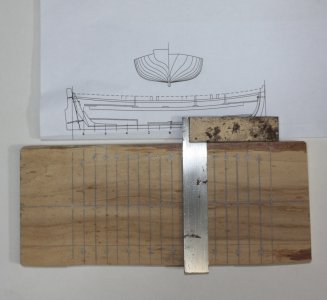

Made some sawdust today starting with the building board which is 1/2" plywood about 4"X8". A centerline was drawn on the board then using the profile drawing printed at 1:36 the location of the frame formers were marked.

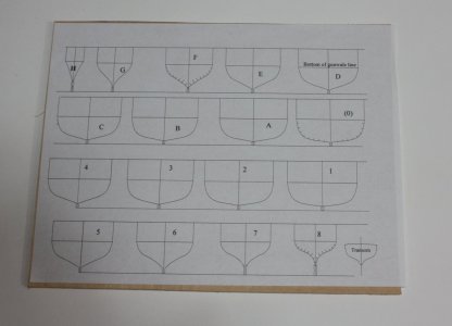

I did reduce the number of strakes to nine, matching that of the contemporary plan for a similar size cutter posted above. The formers were then printed onto a sheet of cheap label paper as I prefer it to printing on plain paper and then gluing to wood. The first pic below shows the backing sheet of the label paper. I cut a piece of plywood sheet to about the same size as the paper, if only for convenience sake. I used a hand saw only to prove a table saw was not necessary.
After wiping down the sheet of plywood with alcohol (so it would dry quickly) and a rag, the backing on the paper sheet was peeled off and the printed side applied to the wood.

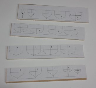

The strips of formers were then cut so they were easier to handle and hold in a vice.

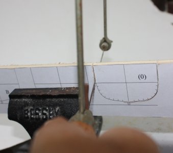

The next photo shows a former being cut with a coping saw. A scroll saw is much easier, but again, I just wanted to prove, if only to myself, this could be done with a hand saw.
