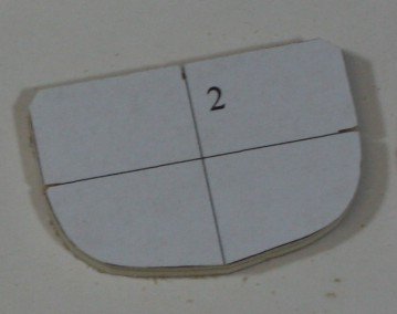

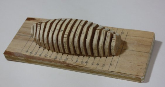

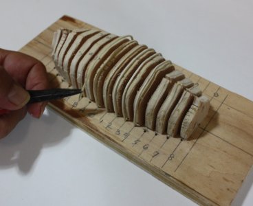

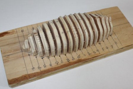

The sketches below will give an idea on how I am building the forming set up for the frames. Pics of the building board with the formers and frame location holes later today. Keep in mind that the materials are stock sizes so a full shop is not needed, but the overall size may be a tiny bit off.

Great question, but so far I never had a problem with that. The way the hull is built it is surprisingly strong. The full frames will be going on next and taking care not to get glue on the formers is critical in order to avoid hearing the dreadful CRACK when taking the planked hull off the formers. Next is the preassembled keel, dead wood, stem, and sternpost. After they are glued to the full frames the half frames and transom go on. More details to follow with pics. After the framing is done. plank the hull. Once the glue is dry clip the frames at the building board and remove the hull from the formers. The hull breadth MIGHT open a tiny bit, but if it does, when the thwarts go in on top of the risers, just squeeze/clamp the hull so the thwarts fit tight until the glue cures.
I'm watching TV while working on a launch that is built the exact same way. I'm making sure that my planks fit the frames and the form almost perfectly before gluing them. That will prevent stress and help the boat hold its shape when popped off of the form. Just as Allan said... if there is any deformation the thwarts will take care of things when installed.

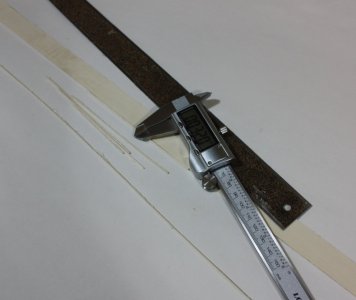

I started making the frames. On the actual boat the moulded dimension of the floors was more than at the top of the frames, but as they will be covered with the footwaling planks I did not go to the trouble of making the frames as was done on the actual boats. For this scale I used a sheet of holly that is just under 1/32" thick. Strip basswood 1/32X1/32 (0.8mm) can be purchased and will be very close to scale. The actual size of the frames at the top of the futtocks for an 18 foot cutter would be smaller than 1/32" by about 0.003" or 0.09mm so not really noticeable by the human eye without magnifiers. Again, I am trying to make this so stock material very close to the actual size needed can be used. Basswood is easy to bend to shape, similar to the way holly works, and can be found on line. More on how to do this framing in upcoming posts. In this case I used a steel rule as an edge guide and scalpel to slice strips to make the pieces that will be used for frames. A bit of scraping or sanding is usually needed on one side, but if care is taken, it will be only a little work. If premade strips are purchased, this sanding should not be necessary.

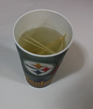

The full frames are now over the formers. The frames started out as straight pieces of holly and soaked in water for 30 minutes or more before being bent to shape. The notch at the bottom of the former is to make it easier to manipulate the end of the frame into the hole. It will also make it easier to cut the frame away from the base board when it is time to remove the boat from the former. In cool weather I will hit them with a hot air gun, but summer in SW Florida garages makes it a bit like an oven so the frames are dry and hold their shape within an hour.
Soaking the frames in plain water
6 of 9 Full frames over formers and inserted into building board

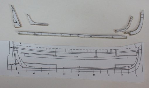

With the full frames in place, time to make the keel, deadwood, etc. I printed the profile on label paper then cut out the parts and stuck on small pieces of castello boxwood of the proper thickness, 0.1" (2.5mm is very close for anyone using sheet stock) All the pieces need a little filing/sanding, a little fiddly but nothing complicated. I am using chisels to reduce the thickness of the deadwood where needed at the stern, and the deadwood on the apron forward.

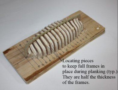

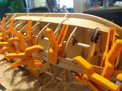

The keel, stem, post and deadwood have been assembled and dry fit on the building block. Now that it fits, the transom will be added and the assembly glued to the full frames. The frames tend to move a bit on the formers so I usually glue some small pieces that are thinner than the frames to the formers to keep the frames in place.
The only stage that is scary for me is removing the planked hull from the form. If any glue gets in the wrong place there is a noticeable "CRACK" sound. I have heard it a couple times over the years, but surprisingly/luckily, it was minor and caused no damage to the framing that could not be quickly and easily fixed. Hope this one also goes well when the time comes. :)
