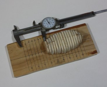

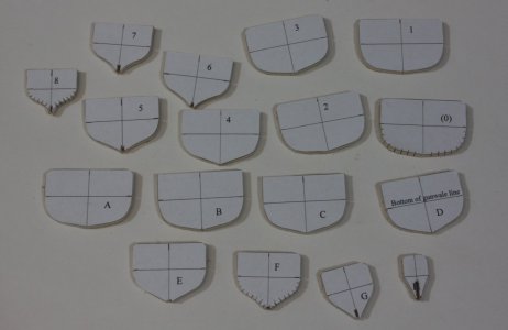

Ordinarily I use all my power tools from milling machine to lathe to small table saw, but this one was only to show a scratch build for a boat is not all that difficult with handheld tools, with or without power.My idea of a coping saw and chisels have been replaced by a CNC router and a milling machine

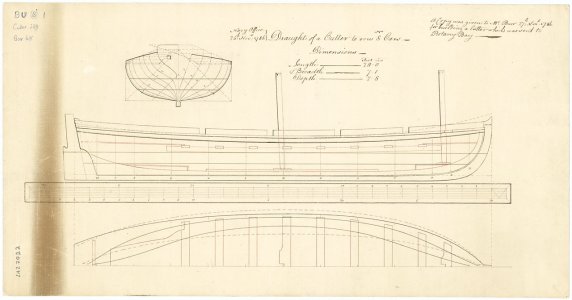

Thanks Christian. Should have some photos of the building set up of the formers on the building board shortly. Cutting most of the formers by hand is taking a while, but getting done.Really nice preparation

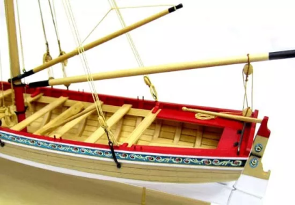

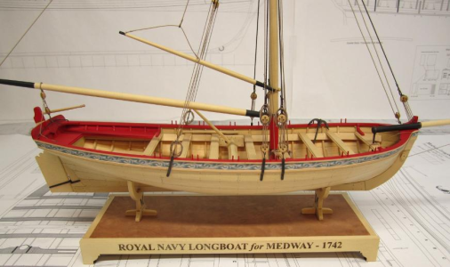

Great catch Bob.Nowhere do the plans indicate any sort of mast step beneath the second thwart aft which would be necessary to hold the mast in place at its foot.
There is a ring bolt between the 2nd and 3rd thwarts
syrenshipmodelcompany.com
I remember this conversation and common sense says the rigging cannot work. As much as I rely on RMG for information, they admittedly are not without errors or incomplete data in their explanations. They are absolutely a caring and gracious team and I for one love to reach out to them but most of them are not trained as naval architects so cannot always help as much as they would like to. Considering the amount of information that is there an occasional error or incomplete explanation is understandable. My granddaughter will be starting college this fall and library science and archival studies are her focus. I am already pushing her to move to Greenwich and get a job at RMG when she graduates, or maybe do an internship there to get an inside track. Now if I could only talk her into taking a minor in naval architecture........The explanation of why the RMG contemporary models are so glaringly incorrectly rigged remains a mystery
