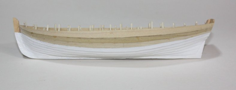

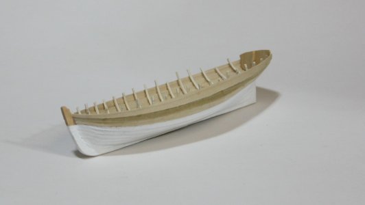

Started over with the new keel, stem, post, deadwood, transom and planking. It came out much better than the first try. I searched for information on painting these boats and I did find a few photos with the hulls payed or primed on the lower part of the hull. Some followed the shear of the planking, others followed the waterline. I also found a contract that called for the hull to be primed from the waterline down as well.
I thought it looked great until I took photos. Blowing up the photos shows every tiny imperfection so a great tool to use on any model as it progresses. There are a few spots that still need attention (scraping), but overall I am much happier than the first attempt.

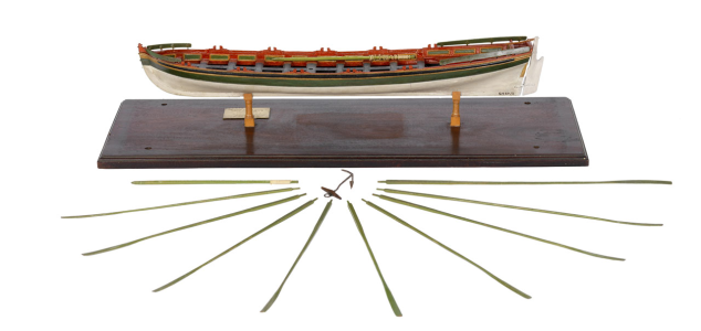

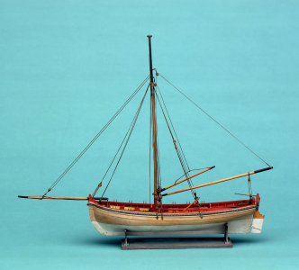

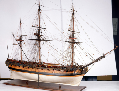

Example of a painted barge model made in 1794
Example of a longboat model made in 1742
Boat on fully rigged ship model with ship's boat made in 1761
'My version of painting the hull

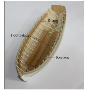

The keelson and footwaling went in next. The risings followed. The thicknesses are shown in the scantlings list. The keelson is an inch thick and the footwaling 5/8". The breadth of the keelson is 9 but I could not find any information on the breadth of the strakes of footwaling. Looking as some cross section drawings and models I estimated the breadth. Not that there is a small gap between the strakes of footwaling. This was done so water could not accumulate on top of it where the oarsmen feet were sitting.

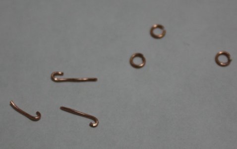

Making the ringbolts for the lift rings and eyes is pretty straight forward. While I have used and still occasionally use brass, my personal preference is copper wire as it easy to shape, strong, and much easier to blacken than brass.

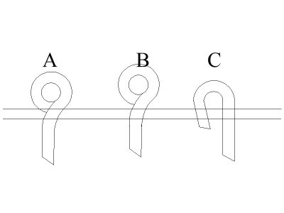

At our small scales, making an eye bolt that does not stick up above the wood in which it is inserted is difficult. The size makes photos hard to see the details, but the drawing below should help. A is what the eyebolts usually looked like when secured on the ship. B is what we often see on models because it is very difficult to seat the eyebolt without carving out a groove, and C sits the loop low to the surface of the wood but without a full eye. Choices........

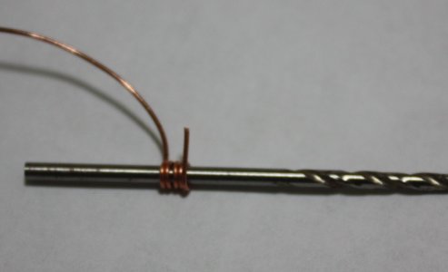

The eyes and rings for this scale are made of 24 gage copper wire.
Making rings around a drill bit. Once the spring is made and removed from the bit, a snipper was used to cut multiple rings.

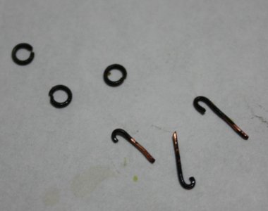

Pieces were soaked in acetone for a minute to remove any finger oils and such.
The cleaned pieces were brushed with diluted liver of sulfur and they blacken instantly. I left the tips unblackened so dot of glue will adhere to the copper, not the blackened portion. If the rings were to receive any stress I would have soldered the rings.
