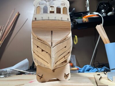

I'll be starting the hull planking soon, so I 3d printed a 1:1 hull section to help form the planks. I really don't know how I survived so long without a 3d printer.ROTF
Nice idea if you have the scanner and printer. I did this directly on the hull though I had to wait till the planks dried before I could glue in place. This idea would certainly speed up the planking process with one of theses for each of the horizontal profiles for the bow and stern section.
Very good way with this selfmade form - great idea
