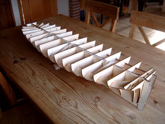

This morning, I started to release the keel plate pieces from their backing sheets to check how they fit together. The keel plate consists of two layers of pieces that are supposed to line up once they been assembled. There was a problem - a BIG one! Once assembled the two keelplate-halfs didn't line up - one side was longer than the other and thus, in some places, the slots for the frames didn't line up either. I later figured out the problem was that pieces A4 and B3 were identical. Further checking showed that A4 was correct, however, B3 needed to be corrected. Some slots for frames were closed, others opened and the piece was lengthened by some 12 mm.

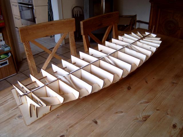

Once completed everything was fitted together without glueing and here is the result:
Here you can see where slots were closed and this side of the keel-plate lengthened.
Despite the problems, I am thrilled with the result. But I am an experienced modeler and I have a well equipped workshop. I have to say that most modelmakers with little experience would be completely overtasked with these errors and would most likely give it up at an early stage. I still have to see once the hull stringers are being mounted if everything finally lines up after all.

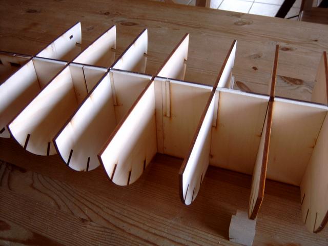

Early this afternoon I fitted the stringers to the hull and everything fitted perfectly. The corrections that were undertook to the keelplate were doing it the right way.

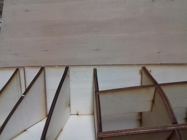

There's the next problem: There's a significant step along the bottem edges of the Frames:
This will need to be taken care of before planking Begins.
