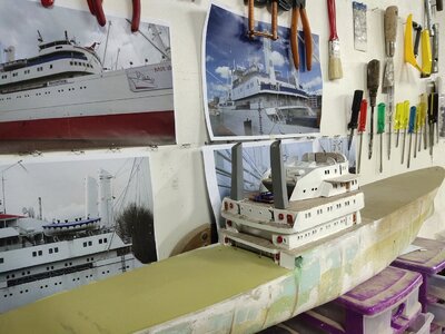

I have made the funnel bodies. I made a frame using balsa and added trimmed polystyrene to get the desired shape. Then wrapped it with aluminum sheet.
For the second funnel body was shaped from wood. It was a faster way. Following exactly paper model plans is not always the best way, some self planning is good but this comes with experience.
Funnels were sprayed with epoxy primer and sitted temporary. I planked the rear side of bridge deck and scratch built vents and few other pieces
The last part was the smallest but the trickiest one. I used the styrene - putty method to shape the top of the bridge deck.
However at 95% complete, a bad reaction of primer and a new acrylic spray I used distorted the red color and despite my efforts , it was beyond repair. Therefore bridge deck piece and roof were removed and rebuilt from the start.
This time I used 0.5 mm plastic instead of aluminum. Although I try to restrict use of plastic on this model I shaved quite a bit of time and effort especially shaping the windows. Also this time I used less pieces as shown on plan, paper models need many support pieces than plastic or wooden modelsIMG_20210602_224241.jpgIMG_20210612_185521.jpgIMG_20210612_185531.jpg

I was wondering to skip the planking process and go straight to smooth the hull using car body filler, sanding and repeat the process unit I get the desired effect. Which I did. Then took it upstairs to dry quickly. It would be proved a disastrous decision.
Even hull didn't have any visible imperfections, it took around half kilo of filler to cover it all. Then after a few minutes the hull area between frames collapsed. I have seen this happen on another project while using rubber adhesive glue. Probably catalyst heated polystyrene and forced it to shrink. I added locally some acrylic putty to fill the gaps. Even it was easy to work with, body filler on the other hand is not. So working with hard and soft ingredient at the same time is not an option. Another layer of car body filler will do the job although this would require lots of extra sanding effort plus will increase even more the weight of the hull.

Learning from the rookie lessons I already started the process of a new hull with different approach. With better materials and lighter as the previous one would require a big amount of filler. Keel will be made from 4mm plywood instead of 8 so I can work easily the sharp bow and the round stern. Bulkheads are made of 2-2.5 mm wood instead of 3. For main deck a strong wood less than 1mm thick will be used instead of the 2.5 mm MDF which proved too heavy and problematic (don't forget I use paper model plans so I need to to adjust wood thickness according to plans.)
Done gluing the frames. I sanded them down, balanced them and glued the deck this time in several pieces.
I went to the only local model wood supplier but he was closed. I was looking for mahogany or birch plywood less than 1mm thick. So I ended up using balsa 1mm. Very easy to install but also very fragile. Need to handle it with caution
I finished the hull as well the filling between the frames. I used a thick coat of acrylic patty as a sealer between foam and car body filler. After sanding it down I will coat the hull with layers of thick acrylic primer for extra protection.I also shaped the curvy stern and tall bow with glaze putty. Rest will be covered with high quality car body filler. This will give the strength and hardness needed as practically there is no hard planking.
