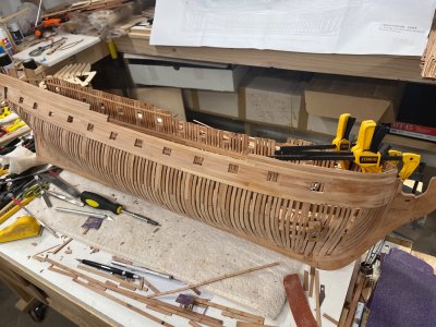

Is the well and shot locker in your photo just resting where it is and not yet fixed in their final location?

Correct. Everything, so far, is only dry fit while finalizing dimensions, locating on beams, etc.
Once I get all compartments done and get a couple coats of finish below platforms, will start to glue up structures.
Now, working on 3-4 courses of exterior planking around gun ports to get dimensions correct and give extra strength to framing, etc.
As noted earlier, have had to rip replacement planking in some locations, especially the small angled sections between ports. Seems like they are all short as supplied and zero work around except to fab new ones. As I indicated, however, there is plenty of extra material remaining on sheets with all framing removed to rip new planks and allow wood to match fairly well......folks, don't throw anything away!:eek:
Tim
Just, added. Not really any sanding done yet but planks lay on frames nicely and edges seem tight to adjacent run so I think I’ll be all right.
Some color variance between the 5-6 sheets but that will even out with selective coats of finish when ready.

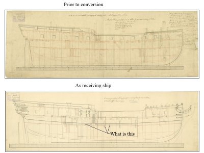

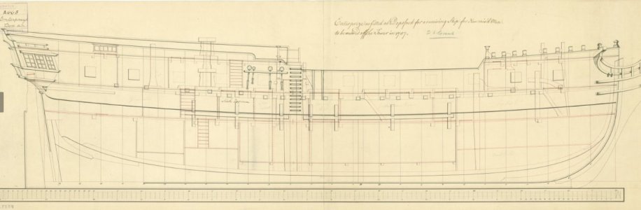

I have a question regarding Enterprise as a receiving ship hulk when she had no masts, wheel, guns, etc. as she was set up as one for more years than she was a fighting ship. What are the parts marked on the drawing below? I am guessing the vertical pieces could be knees, but what was the purpose of these parts?
Thanks
Thanks
Purely a guess on my part, but I would imagine that they cut out a large hole in lower deck to make the hold more available and they did that for additional structural bracing that the deck and beams used to provide. Again, totally just a guess on my part !
I seem to recall with other ships, when altered the horizontal structures, particularly on that deck, may have been platforms for sleeping for all the “ residents” .
Makes some sense to me, but why not hammocks? This is getting more interesting than I thought it would be.
Allan, hello! What you're asking about are bumpers, or, in other words, fenders. These reinforced fenders were installed on all ships and vessels intended for port service. Ports are crowded, and ships often collide. Often such ships are placed close to each other, and in high waves in bad weather they hit each other hard.
Discovery_at_Deptford.jpg Fores's_Marine_Sketches._The_Royal_Navy._Portsmouth_Harbour_-_the_Victory_Saluting_Her_Majesty...jpg Hulks_at_Sheerness_RMG_PU7884.jpg Lebreton_engraving-09-hulk (1).jpg pw3160.jpg The_hulk_Blake_at_Spithead_ILN_1854-1118-0005.jpg
View attachment 548808 View attachment 548809 View attachment 548810 View attachment 548811 View attachment 548812 View attachment 548813
View attachment 548814 View attachment 548815
Thanks uitar. Very interesting. I've seen hundreds of naval pictures, but I hadn't noticed anything like these before.
