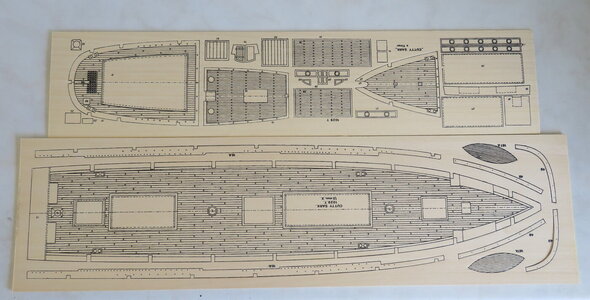

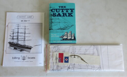

The kit is definitely “vintage” (no laser cut parts). I know that Billing kits from this time were not of the best quality but I will be using this as a base kit for the model build so I’m quite OK with the out-of-the-box quality issues from the day. All of the frames are jig cut and some of the ply parts are die-cut. Other detailing parts are just printed onto ply sheets and need to be cut out (I will probably just use them as templates and make new parts from solid wood). The decorative mouldings and service boats are plastic as are the rigging blocks and deadeyes. The rear transom decoration is a decal. The instructions are the usual basic ones from BB with four plan drawings of layout, sails, pins and rigging.

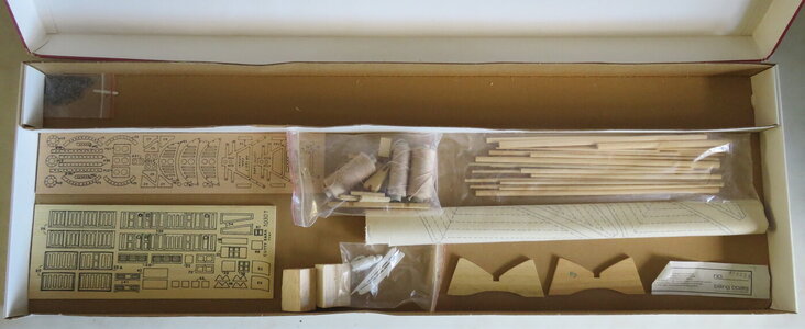

Because I paid very little for the kit I will upgrade it as I go through the build by replacing all of the plastic parts with wood/brass and making new parts where I think the model will benefit.
I have already purchased a set of photo-etched decor parts and a full set of walnut CNC rigging blocks from HisModel. The rigging blocks came in two sets, one for the standing rigging (224 pieces) and one for the running rigging (535 pieces). The blocks are of the correct type and size for this model (759 blocks to rig is however very intimidating!).
I will replace the plastic service boats with wooden ones of the correct type and scale. If anyone knows where I can find some suitable 1:75 kit replacements (or some scale plans so that I could make them myself) that would be great, please let me know through the forum.
I will also replace the rigging thread with some decent rope when I reach that point (I think I will purchase rather than try to make my own).

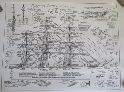

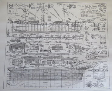

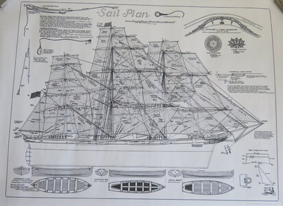

To help with the build and rigging I have bought a set of G.F. Campbell’s plans (General Layout, Rigging and Sail Plan) from the Royal Museums Greenwich. I also found Olha’s book review “Cutty Sark, The Ship and the Model/Longridge. C Nepean'' on her YouTube Channel < CS ref book > and I was able to locate a good used copy of the book in the UK. I do not intend to go the “whole hog” on the model by super-detailing it, my intention is to improve it to a level that I am happy with (whatever that is?).

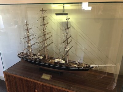

My daughter started up a new job in London recently and she sent me this photo during an amble through Greenwich. What a novel way to preserve a ship and give her access to the public.
I hope you live close by and are able to take advantage of the real time reference material :)

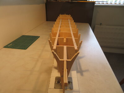

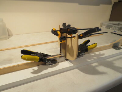

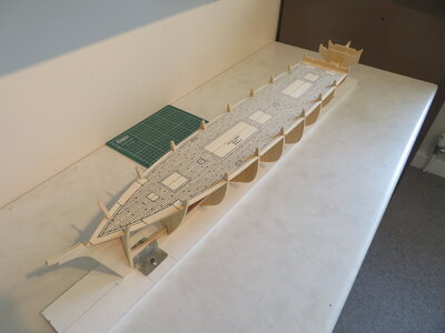

So, first up was to glue the keel, bow and stern sections together. The hull is long and narrow, so I clamped the keel using some angle brackets to a piece of scrap board to keep everything straight. There are no cut-outs in the keel board so placing the centre bulkhead was critical because all of the others are spaced from that (the fun of vintage kits!). Before starting to glue up the bulkheads my wife thought it would be nice to have some cargo visible in one of the holds as I did for my Baltic Trader (some tea chests?). Looking at where the bulkheads are in the hull relative to the hatchways I decided I will open up the forward hold and fit a false lower deck below the hatchway so that I can place some cargo that would be visible if you peer inside.
Because of the error I found on my Baltic Trader I had the good sense to check the bulkhead spacings as shown in the instructions and sure enough I found the gap between the number 8 and 9 bulkheads was incorrectly labelled and the number 10 bulkhead was too high. Very happy that I found those errors before setting the bulkheads because it would have been very hard to correct later. I also thought it would be better to use large cross sectional pieces for the bulkhead spacers rather than the suggested 5x5mm in order to make the skeleton very stiff while I plank. I cut some 25x25mm basswood that I had spare and fixed them at the correct spacing between the bulkheads using some off-cuts to raise them off the keel -total overkill - but why not! With such a long hull each bulkhead has to be precisely placed - so lots of engineering angles and measuring was the order of the day.
With all the bulkheads done I made up the forward hold deck and glued it to the spacer, fitted the deck stringers and roughly fitted the main deck to check that it sat properly on the top of the bulkheads. I will refine the deck fit later so that the edges meet the planking strips.
It’s a start and now that I have the skeleton assembled I have a better sense for the size of the model ……… IT’S A MONSTER! ……… “I’m gonna need a bigger bench!”.

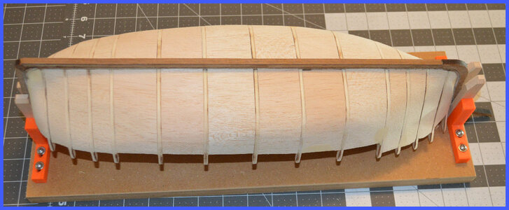

Since you asked, I'll give you my 2 cents regarding blocking/filling the framework.
While it certainly requires additional work, I feel it's justified to fill the areas between the bulkheads. Not only does it provide additional surface for adhesive and pinning it also enhances the fairing process. Of course, this is my opinion and I'm sure others will probably differ. ;)
This is 'one' of my current builds with everything filled/blocked and almost ready for planking to commence. The widest between bulkheads is 42mm.
Another plus is that it makes for a very robust structure.

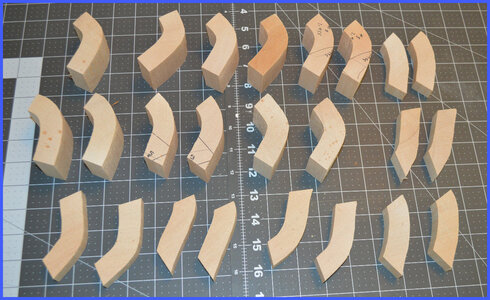

I cut pieces the proper width for between the bulkheads on my bandsaw from 2" x 3" material then layout and cut the individual segments on my scroll saw.
I use hard balsa. You'll hear all kinds of opinions regarding wood type however never had an issue with balsa if you align the grain properly and it sure sands much easier than others such as basswood. I know some use pine.....Whew, way too much sanding for me. I block sand everything by hand not power tools starting with 60 grit working my way to finer grits with 220 as my final grit.
Been using this method for over 50 years building RC aircraft.
