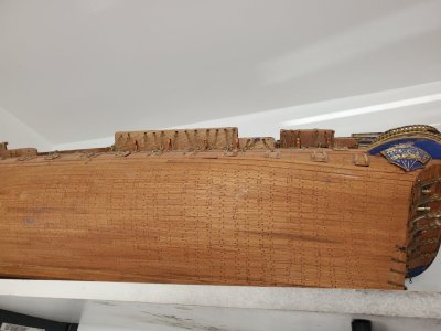

Decking should be Smooth which your is but it needs but the planks should never end in points anywhare
They cannot be fixed onto the hull
If you have a second layer of planking cut into equal lengths of about 5" 8cm
A main plank (Garboard Strake) should run along from the Stern STAIGHT along the keel and end up cut into the keel before it starts lifting beforn the stem I would then start at the lower level of GunPorts and fill in as much as you can down the side of the ship with no trimming of ends
Dont forget to do both sides
Then fil in towards the stem with solid planks

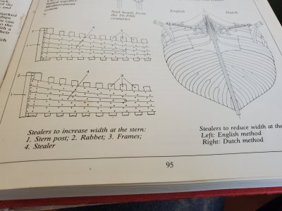

Then use steelers to fill in the gaps
The Dutch use A DIFFERENT method to the English

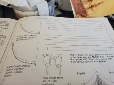

Illustrations are from Historic Ship Models by zu Mondfeld The One Book every modeller should have
If you use the right wood it should not need staining
My San Felpipe showing the best Planking i ever did

hi
