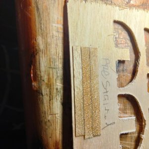

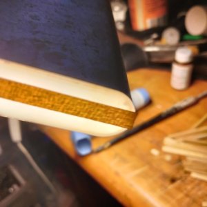

When testing stain colors and building a deck planking sample i found the stain bleeds through to the underside of the plank. When building the deck planking sample I found that both the PVA and CA glues bleed through to the surface.
I don't want the shiny surface created by the CA bleedthrough. I'm afraid of the splotchy finish created by the PVA bleedthrough.
I'm also afraid to prefinish the deck planks prior to installation because I won't be able to glue subsequent deck furniture.
See prestained deck plank below. It was stained with Minwax Golden Pecan oil based.
Any advice is sincerely appreciated.

I want to thank everyone for their responses.
Original post reposted
I don't know what wood is used for the ZHL San Felipe kit. It is extremely porous and only .37mm thick
Ted

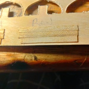

Test panels. First prestained, then glued.
Second glued, stain later. I'll give it twelve hours and check glue adhesion on the prestained side and then stain the raw wood glued for consistent finish and glue leed throughIMG20251109072521.jpgIMG20251109072527.jpg

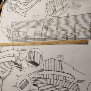

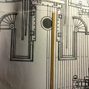

Some of the deck planks shown on the plans are longer than the materials provided. See plan plank directly above the deck plank in the photo IMG20251109075241.jpg
Ted, Although you like to use the woods supplied with the kit, it just might be time to stop struggling with this wood. The samples that you show in your post #53 with that mottled grain structure do not resemble any full scale materials that would be used for shipbuilding.
The ideal solution would be to buy a piece of quality wood and to then rip your own planking material. If this is not an option then visit your local craft store; Hobby Lobby, Michael’s, etc. They usually stock Basswood strip. This would be a better choice than the wood that you’re trying to use. Living in the LA area there should be many choices.
