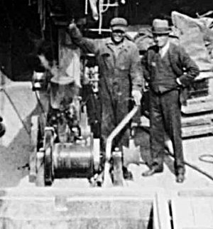

here is a picture of the deck winch following up on research i can ask Burger if they can identify the make and model of the winch. They knew exactly what the engine was so maybe they know something about the winch.
This is a low resolution image and a high resolution image is available from the Wisconsin Maritime Museum collection so in a high res image it would show better details.

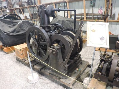

These hit and miss engines could be easily connected via chain drive to power a winch. The photo shows a lever held by the guy that would appear to be controlling a link to the engine.
Roger
I was wrong. I believe that the hit or miss gasoline engine is connected to the winch by gearing per Mariner1941’s post #63 above; not by a chain drive. If you compare Dave’s photo above with that in post #63, the black object at the left of the winch drum is a guard for the large spur gear. It looks like Mariner’s interpretation for his model was correct.

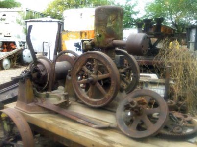

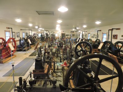

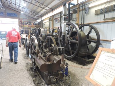

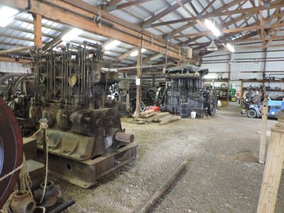

back from my research trip to the power museum WOW! did i learn a lot.

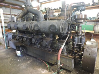

so here is the type of engine used in the White Swan this one was salvaged form a tug boat
The people there were very knowledgeable and extremely helpful. They knew the history of engines going back before 1900. talk about a collection building after building full of engines.

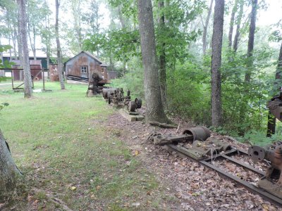

even out in the fields
here is a typical winch of the 1900 to 1930 era

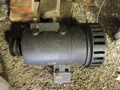

it is the theory from the engine experts the winch on the White Swan would most likely have been electric and not gas powered. These early engines were not gasoline-powered from the same gas we use today. back then gaslight was used and it was produced in limited amount, expensive to use.

It looks like you had a great trip to the museum. So! Here’s the question. Did White Swan have an electrical plant capable of powering a winch? Electric generating plants aboard ships, first called “lighting plants” made an appearance aboard Great Lakes vessels in the mid 1880’s but many ships continued to sail without them. For example, only the later whaleback vessels built in the 1890’s were so equipped.
The steamer Benjamin Noble built in 1909 had an electric plant but all auxiliary machinery including deck and cargo winches was steam powered. On the other hand, White Swan was built in the 1920’s.
You can get a partial answer to this question by looking her up in one of the shipping registers now posted on line. These were published periodically and were used by shippers looking to charter vessels. The one that I found did indicate if ships listed had an electric plant.
