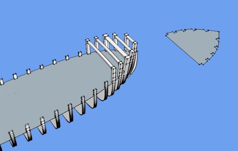

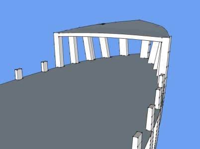

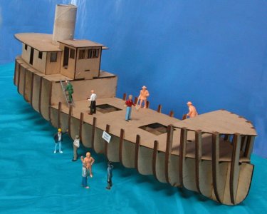

Two decks in place and one more to add
the final false deck fits the same way the upper deck with notches and tabs.
and the fit
at this point the structure of the hull is solid and strong everything is designed to line up and notch into one another.

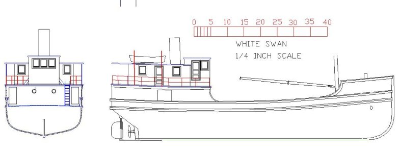

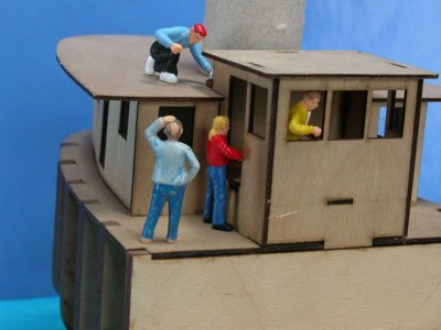

I left off with drawing the basic hull and decks then i took that drawing into Sketchup and created the 3D model. Moving on, drawing the cabin parts are next. The red lines are the planked siding which can be etched into the sides or planking can be applied to the plywood structure.
The sides of the cabin follow the arc of the deck. which may be an issue gluing the side to the deck. What i did here is create a curved slot in the deck and a tab on the cabin side. Now the cabin side is held in place. Each side has a tab and a slot in the deck. While i was at it i also drew the window frames and doors.
This is a vector drawing which can be converted to a PDF file usable for laser cutting or used as is DXF file.

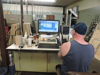

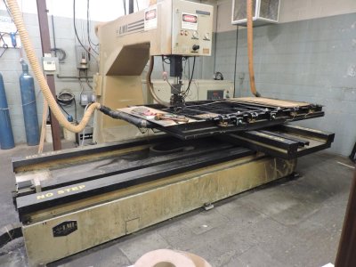

what i am trying to say is you do not need a laser cutter in your shop you just need to know someone who has access to one. Nor do you have to know any CAD or drawing programs a simple hand drawn sketch with dimensions is all you need to do, then send it to me
Using laser cutting in your project is not some mysterious CAD high-tech process. A high school kid can program and run a laser cutter. But on the higher end i do have access to a CAD department and a team and lasers, so if you sent me a drawing no matter how simple or crude it can be converted to laser cut parts

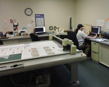

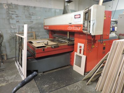

my grandson Josh who can do most anything with a laser and computers
Eric in the drafting dept. who can created files from a basic hand drawing to a cutting file
Tommy at the controls of the lasers
the two laser cutters which are big and powerful
so the school for model shipwrights is at your service

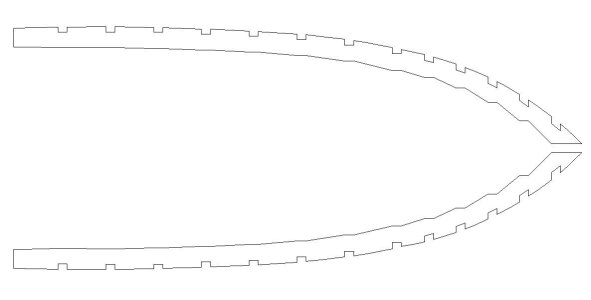

Back to the drawing board here is the final outside profile drawing

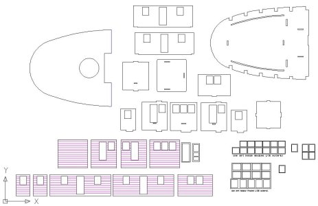

so far by using the hull lines and profile drawings we have a set of bulkheads. The bulkheads were imported into sketch up as a DXF and assembled.

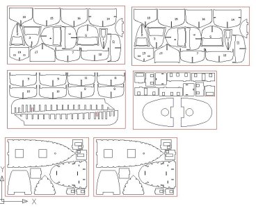

Now comes the part where the design is laid out for the laser and the parts cut in plywood. Here we see a two swan layout to maximize the use of the plywood sheets.

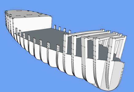

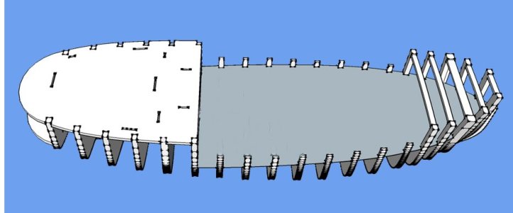

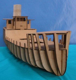

The final results of the designing cut in plywood. By using a laser i am able to adjust the slots and tabs for a tight fit. Cutting such small slots by hand would be difficult not impossible just difficult. Making adjustments for cutting is best left up to the laser cutter, they know exactly the width of the laser beam and can make adjustments. All you as a designer has to give them is you basic drawing.
so lets review the results
sure it is an interesting model to build, just look at those 1/4 bulkheads!
the entire structure fits together with tabs and slots, as a matter of fact there isn't even a drop of glue holding it together.
i got to take a closer look
Yup that is sure a nice snug fit!
so this is the entire ship from stem to stern all snuggly fit together? So does that toilet paper tube come with the bulkhead set?

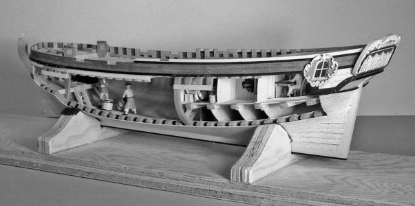

but wait you do not have to stop here the designing can continue with a plank on frame hull.

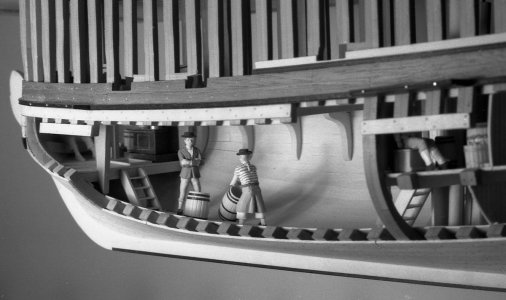

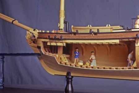

you can bash the bulkhead structure by opening up one side to show the inside of the cabin and engine room. something like Harold Hahn did
ahalifax14c.jpgahalifax22c.jpgahalifax37.jpgahalifax45c.jpgbhalifax84.jpgbhalifax85.jpgbhalifax131.jpgbhalifax132.jpgbhalifax135.jpg
or maybe a larger scale cross section of the cabin and engine room with the engine installed. I am working on a 3d printed model of the engine.
adding more details is up to the builder for example look at the inside of the bulkheads, notice the timbers
once the structure is assembled you can cut down the top of the bulkheads then add a waterway and bulkhead timbers

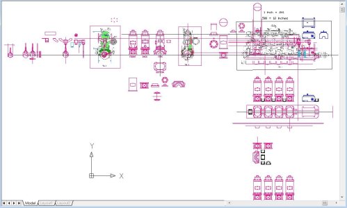

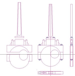

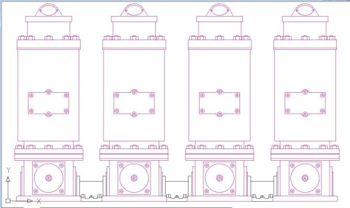

Here is the start of a CAD drawing of the engine
modeling the engine right down to every nut and bolt takes model ship building to another level.
The offer for a set of bulkheads is still available even if you do not intend on jumping on the build right now you will have the bulkhead set for a future build.
