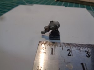

My attempt to scratch build the 20mm gun horn, due to the noise, the 20 mm sits near the engine room, so the horn was used to notify the gunners. The horn is small, and I was working from pictures. took about a week I got it as close as my skill level will allow Still I think its a nice touch . and one you committed to detailing, h1.JPGhg2.JPGh3.JPGh4.JPG your all in
