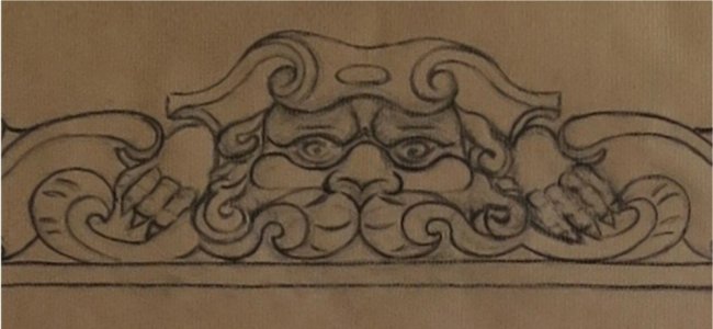

The vdV of GIDEON drawing was enlarged and glued together to 680x570mm
Due tonthe very big enlargement out of the book Dutch Warships 1640-1745(?) the details are quite blurry:
Much blurrierererer as you go closererer:
My question: Is there any source with some better dpi-quality (so my drawings for the putti and so one are not only pure gesswork)?
Thank you very much for your intrest and support.

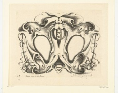

Starting with collecting some ideas for the stand - a semiregular pattern on a lattice gritt is getting born. Just rough doodlings:
The cote of arms of Amsterdam with a golden frame becoming gradiendly a lattice with the field bindweed the pink of the floewrs is only due to my bad eyesight.
I got the horrible idea to go down a heavy three dimensional path with the Amsterdam's cote of arms. For the other side I will add the Amsterdam's admirality cote of arms with twoncrossing anchors on a yellow (or golden????) field.

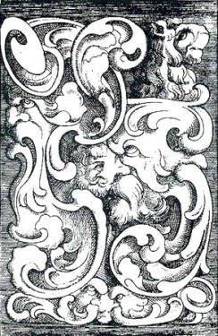

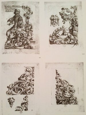

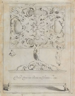

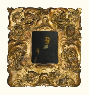

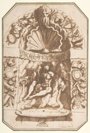

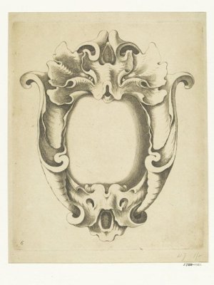

So I do deal with the ideas of the decor and got deeply absorb by the Dutch "Kwabstijl" and I do have to look to stay with it and foundban interesting side-support :ornamentstich_kassmann_aus-_1_765x715.jpg
Here the construction of a quater of the work - the rest is just done by the xerorx machine...

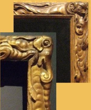

This is nicely irregularity in an original:

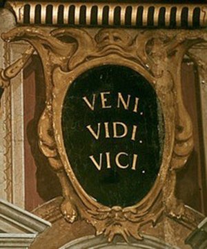

Here an intersting solution for an innovative side support:

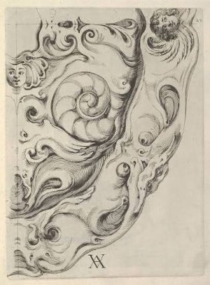

Here the idea to add some rope into the decoration:

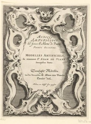

Wiki_Entwurf_Ornamente_Rokoko.jpgAlexis_Peyrotte_-_Design_for_Rocaille_Decoration_plate_4_in_Seconde_Partie_de_divers_Ornements...jpgf8c1e06f2984c7f45306d089d8fb6bbf.jpg
...as this is is declared Rococo but in some kind possible as Kwabstijl?
