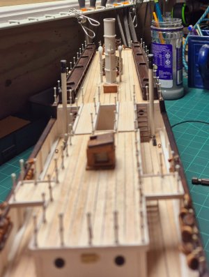

Did a trial fit this afternoon prior to painting (airbrush) and finally fixing into place.
Happy Cat.

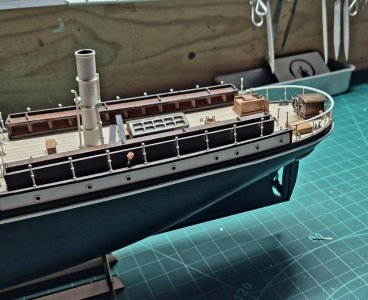

A lot of life suddenly appeared out of nowhere and so I've been very busy negotiating that for the last 4 months, but hopefully I might be able to get a few more logs in every now and then ;)

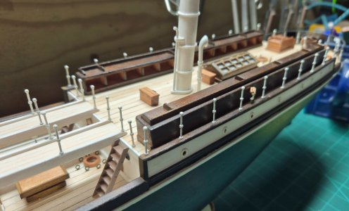

To be honest I can't remember where I left off and what I've done since then, not in any order anyway, so I thought I'd simply post a few recent pics and go from there ROTF

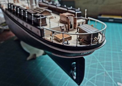

For ages I was trying to figure out how to create that solid handrail on the rear stanchions, it was my brother in the UK that came up with a very simple solution.
"Why not simply use a small piece of steel and make it look like wood"
Genius me thinks.
Its actually a length of 2.5mm dia fencing wire that I flattened slightly and curved to suit.
I'm going to use that same principal with 1mm nails and turn them into oars

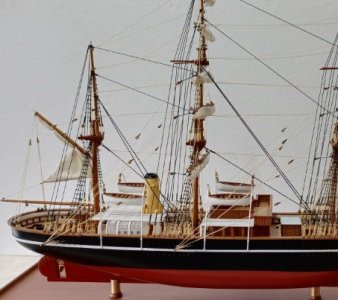

I saw a photo recently of a completed model, and they had painted the chimney and air vents a sort of mustard yellow......tempted.

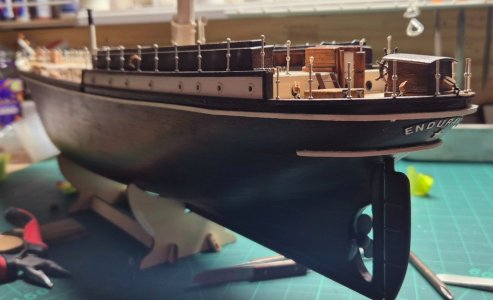

She is looking good Cat. That housing around the steering gear has me pondering. I fitted on mine then removed it. Many photos show it is not there. Have some more pondering to do on that one.
You may be right about the yellow paint. The RRS Discovery which Robert Falcon Scott took to Antarctica is a very similar ship to Endurance and happens to have yellow funnel, vents etch. She is preserved in Dundee Scotland so has a good photographic record.
Thanks Hulk Thumbsup:)
I agree with the housing, I've seen many pics of the ship without it, and and would of really liked to have kept with the accuracy but quite honestly I wouldn't have a clue where or how to start with replicating.
This being my first build I figured I'd stick to the kit ;)
I've made my list of things to complete prior to tackling the masts and rigging (the very thought of which is scaring the hell out of me :oops:;))
and was wondering if you guys had any thoughts on whether I should add the ropes to the stanchions before the rigging or best leave
until afterwards for ease of access to awkward areas ?
I found a pic of The RRS Discovery, I do like the look I'll be honest.
It sort of lets you know - "Hey! Look at me! I'm a sail boat and a steamer Thumbsup:p)

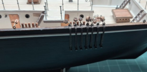

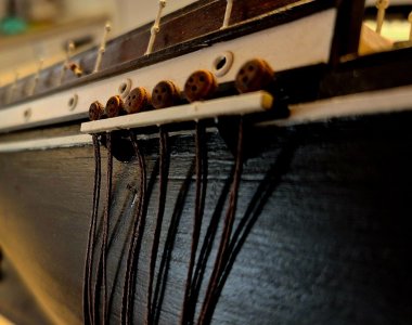

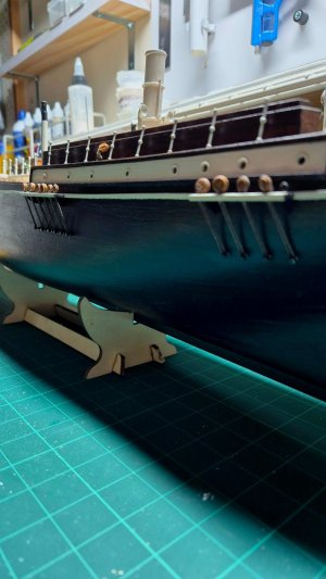

Never having negotiated around blocks and "dead-eyes" and tiny ropes before, I was fearing this stage of the build where I just had to roll those glue infested sleeves up and get on with it. ;)
I'm confident others have resolved this problem in a similar fashion, but I thought I'd share anyway.

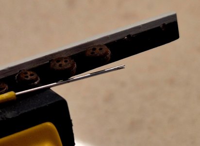

Trying to thread those ropes through a tiny hole was proving to be frustrating, I did try the CA on the end but my finger-tips can only take so much, and you never know when you're going to have to give finger prints (we all know what Interpol are like eh lads ? :pROTF)
So I made a little "pusher" using a clipped eye of a sewing needle to push the rope through.
Works like a charm !

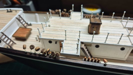

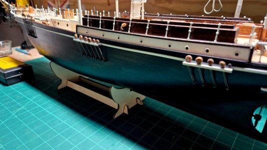

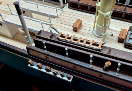

Here is my efforts (yet unfinished) at adding the dead-eyes to the hull.
Occre didn't show supports/gussets for the "planks" but I figured they give it a more hardy look (you can just make them out in this image)
Occre instructions were to add brass nails to anchor the ropes to the hull, I actually used pins from a hair brush because they have a double headed end and I felt it looked more authentic (well, I thought it did )

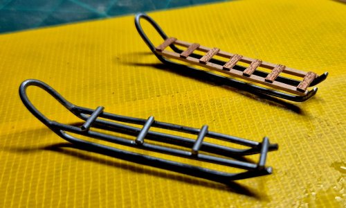

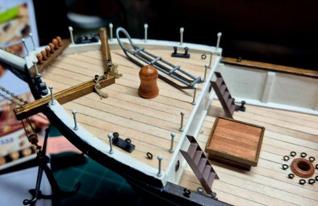

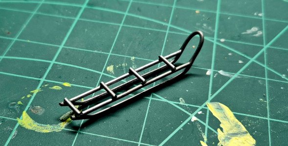

I thought I'd make a start on a simple project, so I figured the sledges sounded like a good idea.
I've been thinking about these for a while, I've seen some very impressive samples and varied ideas here in SOS, so I knew I wanted to embellish the rather simple example offered by Occre but wasn't sure how, and so I decided to take a look on line at some old sledges from early 1900's.
Woah! Not what I was expecting at all ROTF
Anyhow, I figured why not.
Here's my first attempt at a prototype, happy with it, not overly complicated, painted brown (ish) with a few boxes, tarps and ropes I
reckon I might get away with it Thumbsup:)

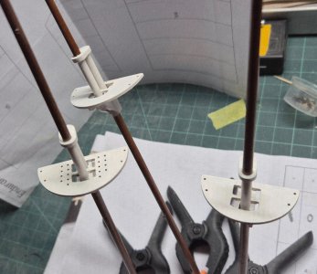

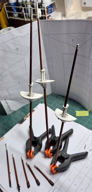

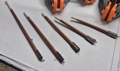

Being a first time builder, the next step always fills me with apprehension and I spend many hours "rehearsing" over and over different
strategies in my head on how I'm going to tackle it.
The masts were definitely in that category.
I think the biggest obstacle I feared was the shaping of the supplied dowels. - 6mm dia to 5mm, 5mm Dia to 3mm, 4mm to 2.5mm.
In the end I clamped a piece of sandpaper in a vice, put the dowels (well protected) in a hand drill, and "sandwiched" the dowel between the sandpaper in the vice and a hand held piece.
Probably way more luck than I deserve but it seemed to have worked fine Thumbsup:)
I've decided to upgrade the ropes, so I'm waiting on those to arrive to add the blocks.
Happy thus far Thumbsup:p
Your searches for reference materials and attention to details is fantastic! Are you SURE you are a Plebe? Your work is like that from an upper classman. :) I see you are more as the experienced guy on the right "giving" lessons, not the newbies against the wall.

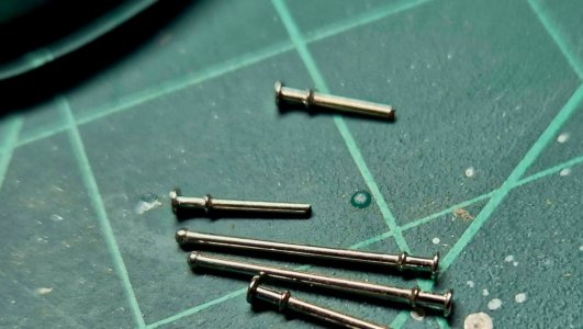

Noticed these handrail posts on a build.
Occre supply the flat ones, and of course I'll have a serious crack at it, but I thought these looked the deal, and I reckon might be far easier to thread the "rope" through ??
Anyone any idea where I might be able to find some ?
Try Cornwall Model Boats (England)

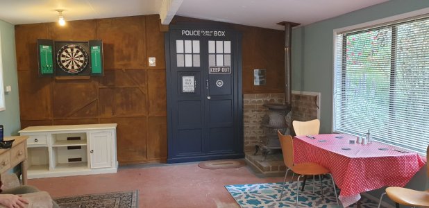

I built a full size Tardis door as a "barn door" once, and everything had to look realistic down to the handles and locks.
I even researched the archives of the BBC in London and found out the paint code for the original Dr. Who series Tardis ROTF
I'll post a pic of said door, we've moved house since and is a feature under our Patio :)

I want to see that!
I want to see that!
Cheers Namabiiru ! :D Here's that Tardis door ;)
The first is in its original location.
We had a very large shed on our previous property which had a small room at the end which I chose to do some artwork in, and decided to put a sliding door to the entrance, and my missus suggested the Tardis :p
When we moved to a smaller property the door came with us, and so we turned it into a feature under the patio near the garage entrance Thumbsup:)
