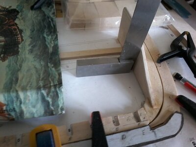

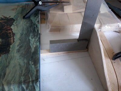

OK MORE PROGRESS, GOT FIRST BULKHEAD INSTALLED, NO.F BOW, ALSO STARTING TO SHAPE BOW BLOCKS HAVE TO DO IT IN 4 PIECES DO NOT HAVE BIGGER BLOCK, COMMENTS, CRITISIMS, SUGESTIONS ALL WELCOME STILL THINKING ABOUT THE PLANKING HOPE IT WORKS OUT HAVE BEEN REVIEWING ALL MY NOTES ON SPILING WHILE DOING BULKHEADS. GOD BLESS STAY SAFE ALL DON20210321_214336.jpg20210321_214425.jpg20210321_214732.jpg20210321_214816.jpg

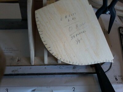

OK MORE PROGRESS, NEED SOME HELP WITH THIS ONE PLEASE I HAVE DETERMINED THAT AT MIDSHIP THERE WILL BE 30 1/4 INCH PLANS AND I WOULD LIKE TO DIVIDE IT INTO 6 PLANKING BELTS, HAS ANYONE CHECKED THIS YET LET ME HERE PLEASE. GOD BLESS STAY SAFE ALL DON20210324_233234.jpg20210324_233340.jpg

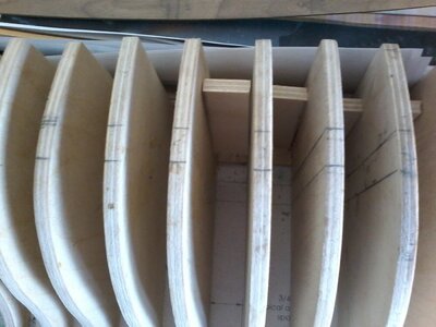

just an update no pictures had a bg, big, big oops HAD TO TAKE 6 BULKHEADS APART, NO YJE PROBLEM EVERYONE HAS HEARD OF MISSION CREAP THI WAS BULKHEAD CREAP AS VERY SMALLDIMENSION LESS THEN 3/32 INCH LED TO THIS PROBLEM SO NOW TO REINSTALL HAD TO FIX THE SPACERS WERE OFF SO GOT THAT DONE, TILL NEXT TIME. GOD BLESS STAY SAFE YOU AND YOURS DON

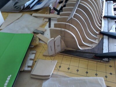

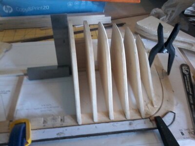

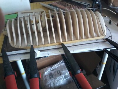

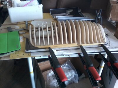

OK PROGRESS UPDATE OOPS FIXED AT THE BULKHEADS, BULKHEAD NO 10&11 DRY FITTED ALL THE REST GLUED THE BOW BLOCK SHAPED DRY FITTED THANKS TO MIKE41, THANK YOU MIKE, THE BEND AT THE BOW IS EXTREME WILL DO SOME SAMPLE FOR THE WALES ALL MARKED ON BULKHEADS, COME ON GUYS JOIN THE FUN SOMETHING VERY DIFFERENT AND ENJOYABLE. GOD BLESS STAY SAFE ALL DON20210329_223815.jpg20210329_223733.jpg20210329_223921.jpg20210329_224351.jpg20210329_224351.jpg

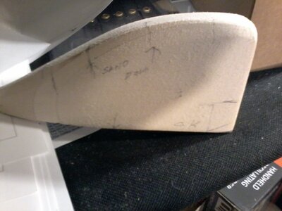

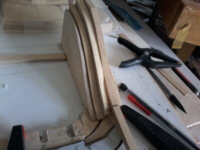

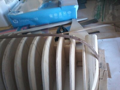

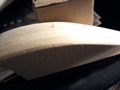

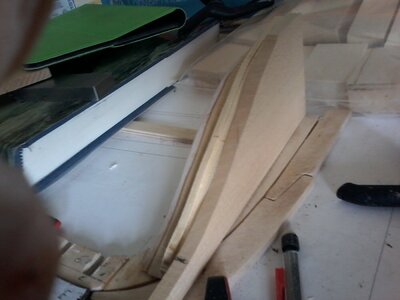

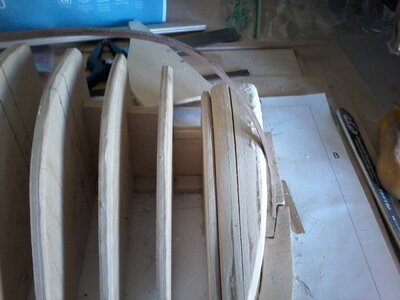

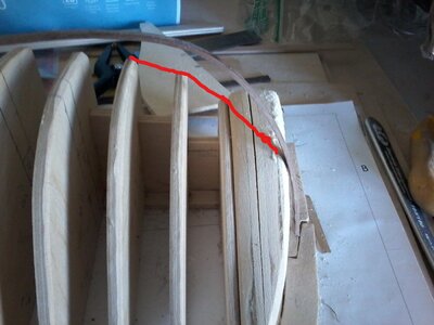

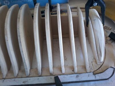

OK PROBLEM WHILE WAITING FOR WOOD TO ARRIEVE PLANKING AND WALES, DECIDED TO DO SOME SAMPLE BENDING VERY EXTRME AT THE BOW SEE MIKE41 LOG, SOMETHING IS NOT RIGHT WITH MINE I HAVE CHECKED AND RE CHECKED BULKHEADS THEY ARE FINE LOOKING AT MIKE41 BOW BLOCK (NEEDED FOR THIS BUILD BADLY) I THINK MY BOW BLOCK IS TO THICK I SHOW WHERE I NEED TO THIN IT I HOPE, BUT WILL THID=S WORK NOT SURE SO DO NEED HELP. GOD BLESS STAY SAFE ALL DON20210401_172140.jpg20210401_172253.jpg20210401_162043.jpg20210401_162653.jpg
Hi Don, the bow block should follow the curve of the bulkheads, maybe a little smother than the mark-up lol.InkedDon bow block_LI.jpg

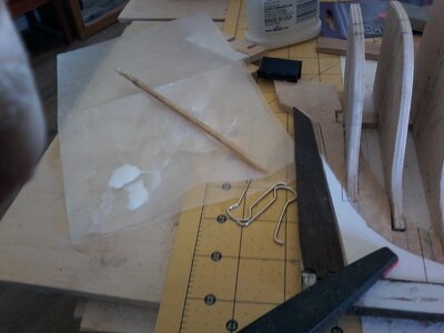

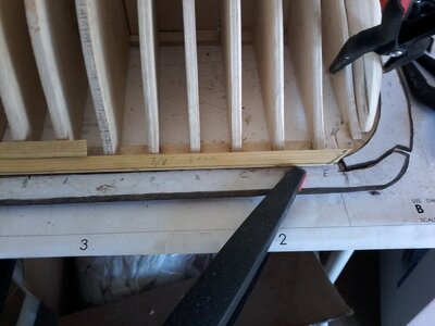

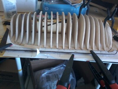

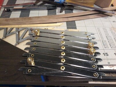

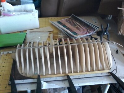

OK MORE GROGRESS DRY FITTING THE GARBOARD AND FIRST BROAD STRAKE BOTH 3/8 INCH WIDE, OUT OF YELLOW HEART THE REST OF PLANKING UP TO THE UNDERSIDE OF THE WALE WILL BE 1/4 INCH WIDE YELLOW HEART THE EXPOSED KEEL PICES ALL IN WEGE THE WALE IS 1/2 INCH WIDE WALNUT, ABOVE THE WALE IT WILL BE BEECH, NOT SURE ABOUT WALE FOLLOWED THE PLAMS MAKING IT 1/2 INCH WIDE WHAT DO YOU GUYS THINK IS IT TO WIDE, NOW WAITING FOR MY ORGAN GRINDER PLANK BENDING MACHINE TO COME IN ORDERED FROM ENGLAND, THE BENDING AT THE BOW IS EXTRME REALLY EXTREAM, NOW FOR PLANKING FOLLOWING MIKE J EXCELLENT TUTORIAL AND PDF NEED TO REREAD AND UNDERSTAND IT IN MY MIND, ALSO NEW TOY GOT IT FOR MARKING THE PLANKS ON BULKHEADS, NOW NEED TO FIGURE THE BEST WAY TO USE IT, PLEASE GUYS COMENTS. GOD BLESS STAY SAFE ALL DON20210411_232214.jpg20210411_232300.jpg20210411_232441.jpg20210411_232745.jpg20210411_232929.jpg20210412_000836.jpg20210412_000932.jpg
Hi Don, your close-up photos look good, if you could post a couple of overall shots of the model it would be helpful. Keep up the good work.

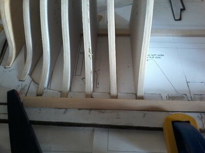

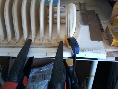

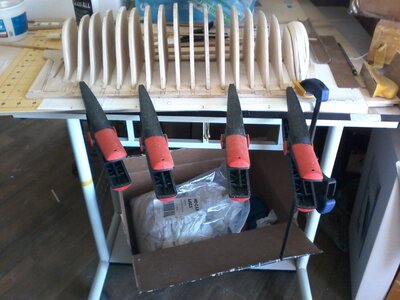

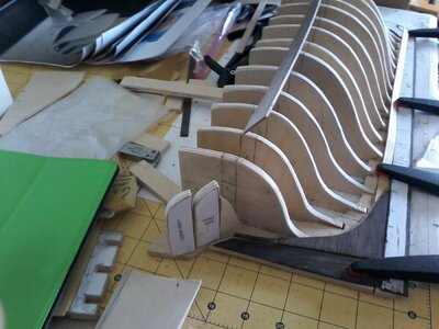

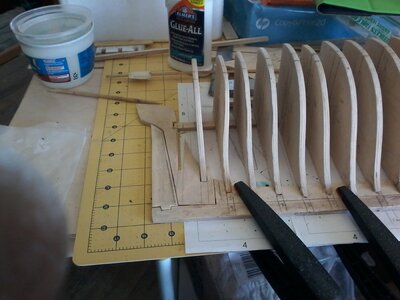

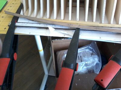

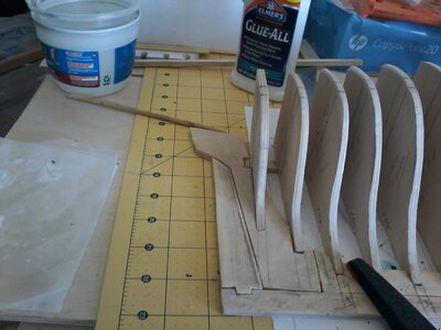

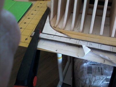

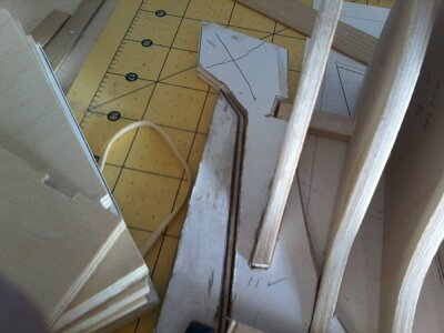

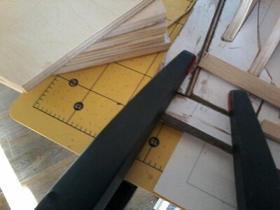

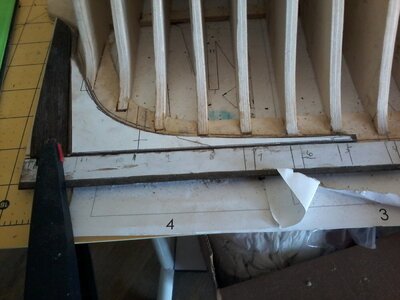

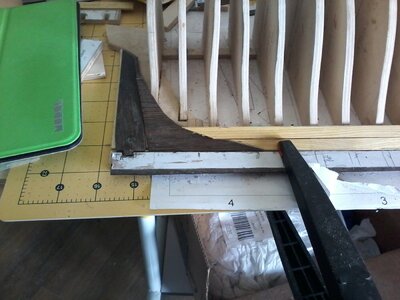

OK MORE PROGRESS BUT NEED ADVICE/HELP BEFORE GLUING, DRY FITTING GARBOARD AND BROAD STRAKE TO THE FINISH/RABBIT PIECE STERN AND BOW, NOW TO CLEAN UP AND GLUE THE FINISH/RABBIT PIECES TOGETHER, I AM ALSO MAKING A SAMPLE OF THE WALE RIGHT NOW MY BIGGEST PROBLEM IS FINDING A CLAMP THAT HOLDS THE WALE,PLANKS IN PLACE WHILE GLUE DRYS SO FAR HAVE NOT FOUND ANYTHING THAT WORKS, NEED HELP THERE BTW I REMEMBER SOME MODELERS USED A BINDER AS A CLAMP BUT CAN NOT FIGURE OUT HOW IT WAS DONE, ALSO DRY FITTING THE STERN BLOCKS AM I ON THE RIGHT TRACK HERE. GOD BLESS STAY SAFE ALL DON20210413_193017.jpg20210413_193120.jpg20210413_194129.jpg20210413_194220.jpg20210413_200417.jpg20210413_200429.jpg
