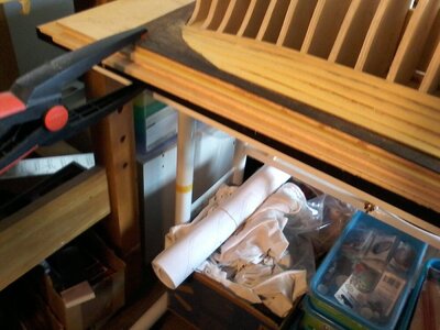

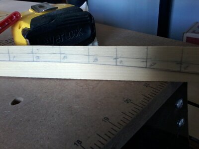

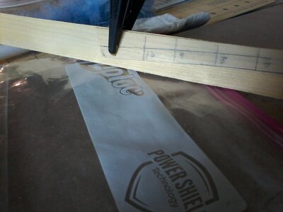

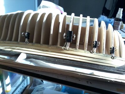

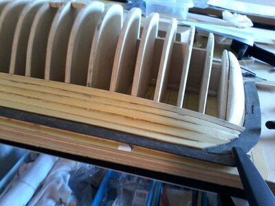

BEEN A WHILE SINCE I POSTED ON THIS, MAKING PROGRESS HAVE 6 PLANKS DONE, GETTING READY FOR WALES, NOW BIG QUESTION FROM SOMEONE 2 MIKES I HAVE ALWAYS HAD PROBLEMS WITH SPILING USING TAPE, BOND PAPER, SCRAP WOOD ETC, NEVER GOT IT RIGHT THEREFOR BAD PLANKING, HAVE BEE WODERING FOR A LONG TIME, WHY NOT TRACE THE LOWER PLANK THAT HAS BEEN SHAPED ON THE WOOD DRY FITTED AND USE THE TICK MARKS TO FINISH OUT THE PLANK THIS IS WHAT I HAVE BEEN DOING I CHECKED IT WITH TAPE IT SEEMS OK, HERE ARE THE PICTURES HAVE GOTTEN THE GARBOARD, 2 BRAD STRAKS AND 2 PLANKS DONE INSTALLED. GOD BLESS STAY SAFE ALL DON20210706_200728.jpg20210706_200744.jpg20210706_201049.jpg20210706_201104.jpg
